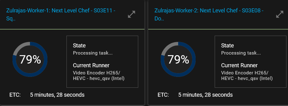

I've gone and upgraded the Hardware in my Server.  I've removed my NVIDIA GPU to save power and added an Intel QuickSync capable CPU.
I've switched over the docker container to use the Intel and remove the NVIDIA reference.  Testing it out, it has converted two files already and they are the exact same file size.  The original and the encoded file. I'm not sure why they would remain the same file size at the end of the encode as using the NVIDIA plugin shrunk the filesize considerably.
Its in the process of converting two more files and I can see that it is, indeed using the Intel GPU:

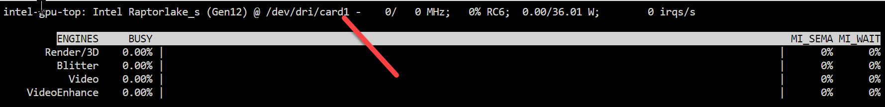

I have build a new system using the new 14th gen iGPU and removed the NVIDIA card.
But when I do a list I have the following cards listed:
# ls /dev/dri
by-path/  card0  card1  renderD128
IS THERE ANYWAY TO DELETE CARD1 so I only have one CARD0?

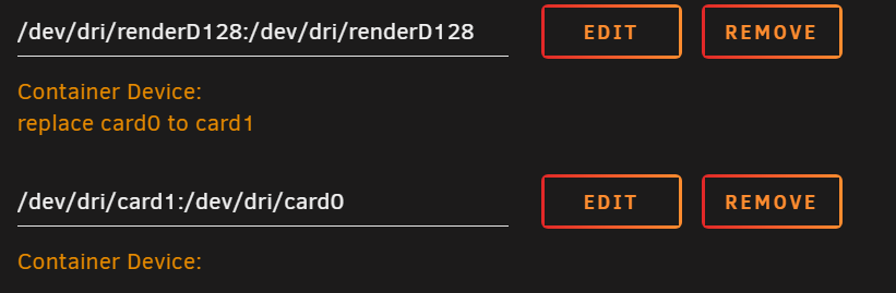

And I can see that the iGPU is listed as Card1 - and Unmanic uses card0
I have tried some suggested workarounds:

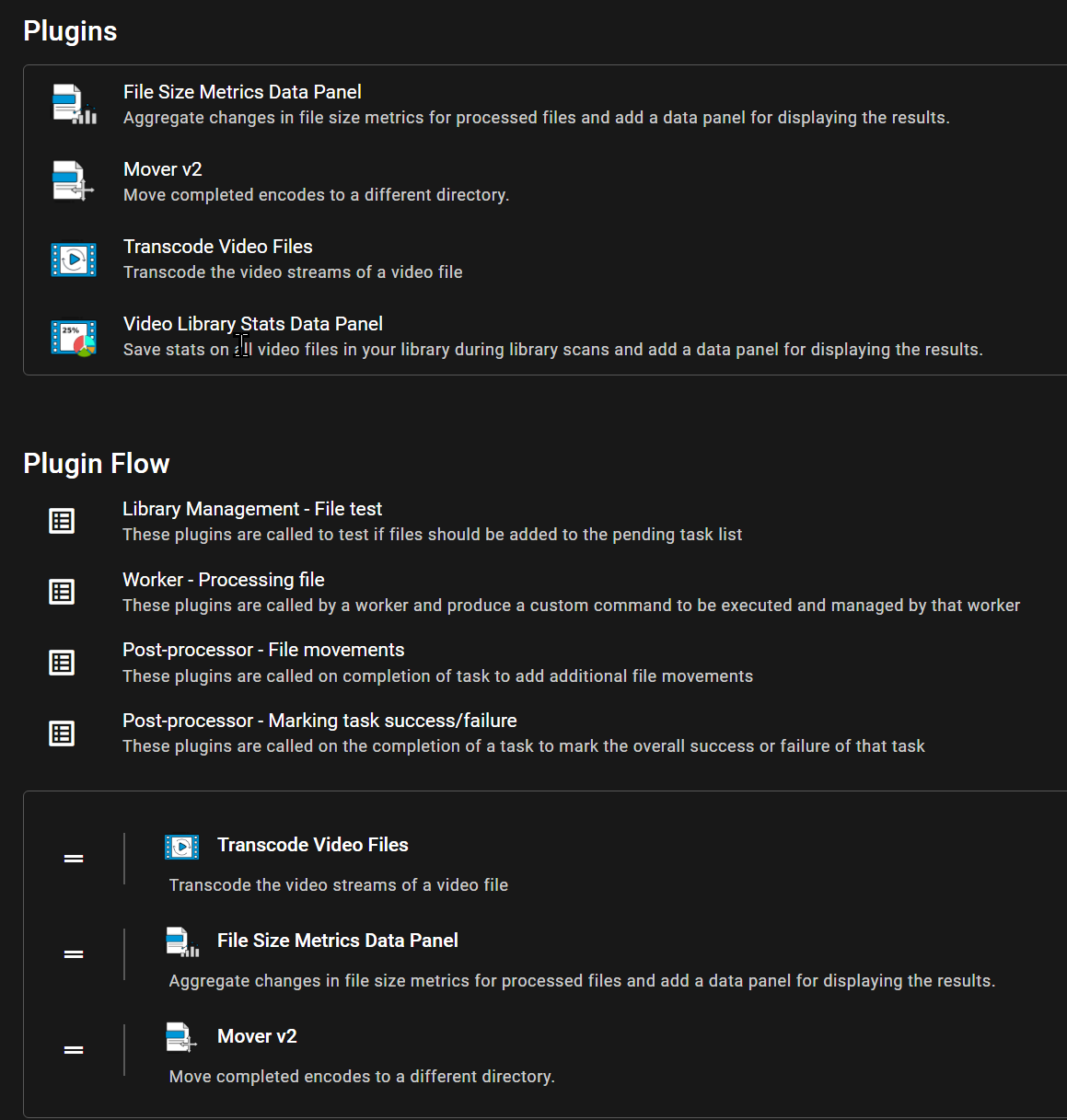

But no matter what I do it does not encode anything even with a very simple flow:
Generic auto on encoding settings:
It just jumps through them as failed:

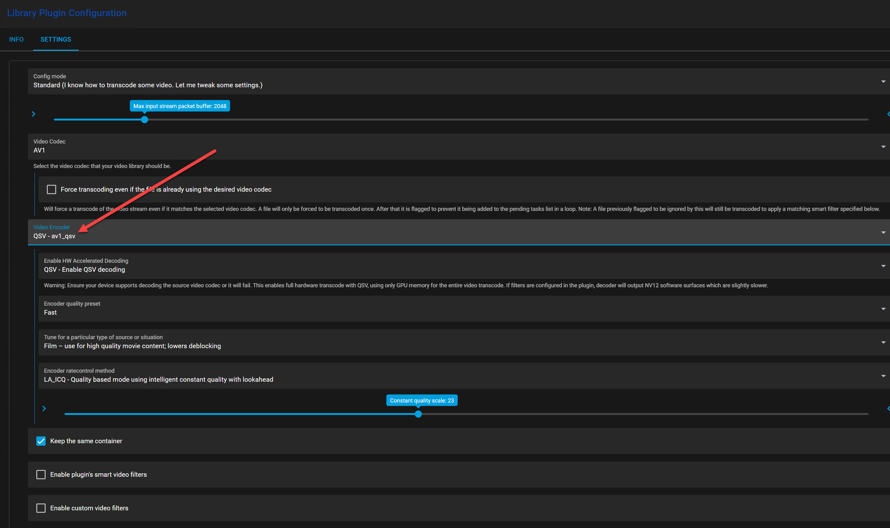

Stream mapping:
   Stream #0:0 -> #0:0 (h264 (h264_qsv) -> av1 (av1_qsv))
   Stream #0:1 -> #0:1 (copy)
   Stream #0:2 -> #0:2 (copy)
   Stream #0:3 -> #0:3 (copy)
   Stream #0:4 -> #0:4 (copy)
   Stream #0:5 -> #0:5 (copy)
Press [q] to stop, [?] for help
[av1_qsv @ 0x555a64876e00] Selected ratecontrol mode is unsupported
[av1_qsv @ 0x555a64876e00] Current frame rate is unsupported
[av1_qsv @ 0x555a64876e00] Current picture structure is unsupported
[av1_qsv @ 0x555a64876e00] Current resolution is unsupported
[av1_qsv @ 0x555a64876e00] Current pixel format is unsupported
[av1_qsv @ 0x555a64876e00] some encoding parameters are not supported by the QSV runtime. Please double check the input parameters.
[vost#0:0/av1_qsv @ 0x555a64877540] Error initializing output stream: Error while opening encoder for output stream #0:0 - maybe incorrect parameters such as bit_rate, rate, width or height
Conversion failed!
Also the iGPU works fine in PLex/Emby/Jellyfin just not Unmanic
this iGPU cant encode av1 ... only decode (playback ...)
Intel ARC and Nvidia NV40xx as sample can ...
@alturismo
Then why is the Unmanic listing the AV1 encoding with Quicksync?
Edited by casperse
im not using unmanic, but i can tell you there is currently no AV1 encoding with your iGPU ...
if you dont believe me, check this about raptor lake cpu ...
https://en.wikipedia.org/wiki/Intel_Quick_Sync_Video
or ask in the dedicated unmanic discord channel ;)

I've just set this up and got things running. I just want to convert all my media to h265. I've no interest (at this point) in anything else.
I've got two plugins running the h265 encoder and the File Size Metrics Data Panel.
For some reason (100% due to me doing something silly) the File Size Metrics aren't working.
