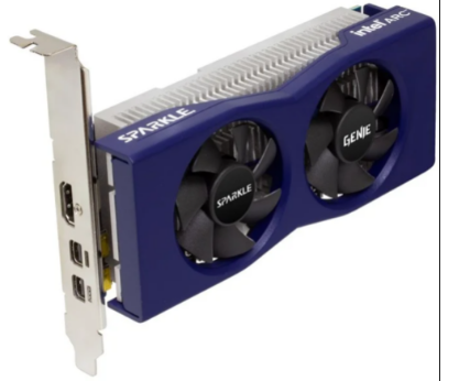

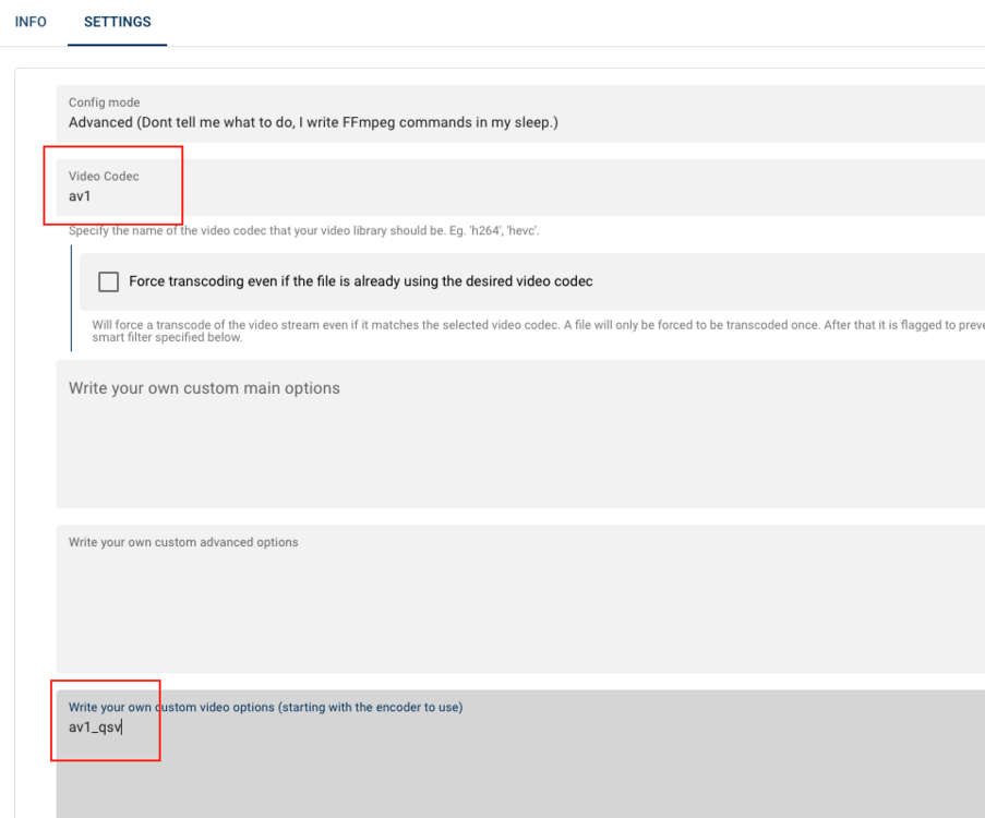

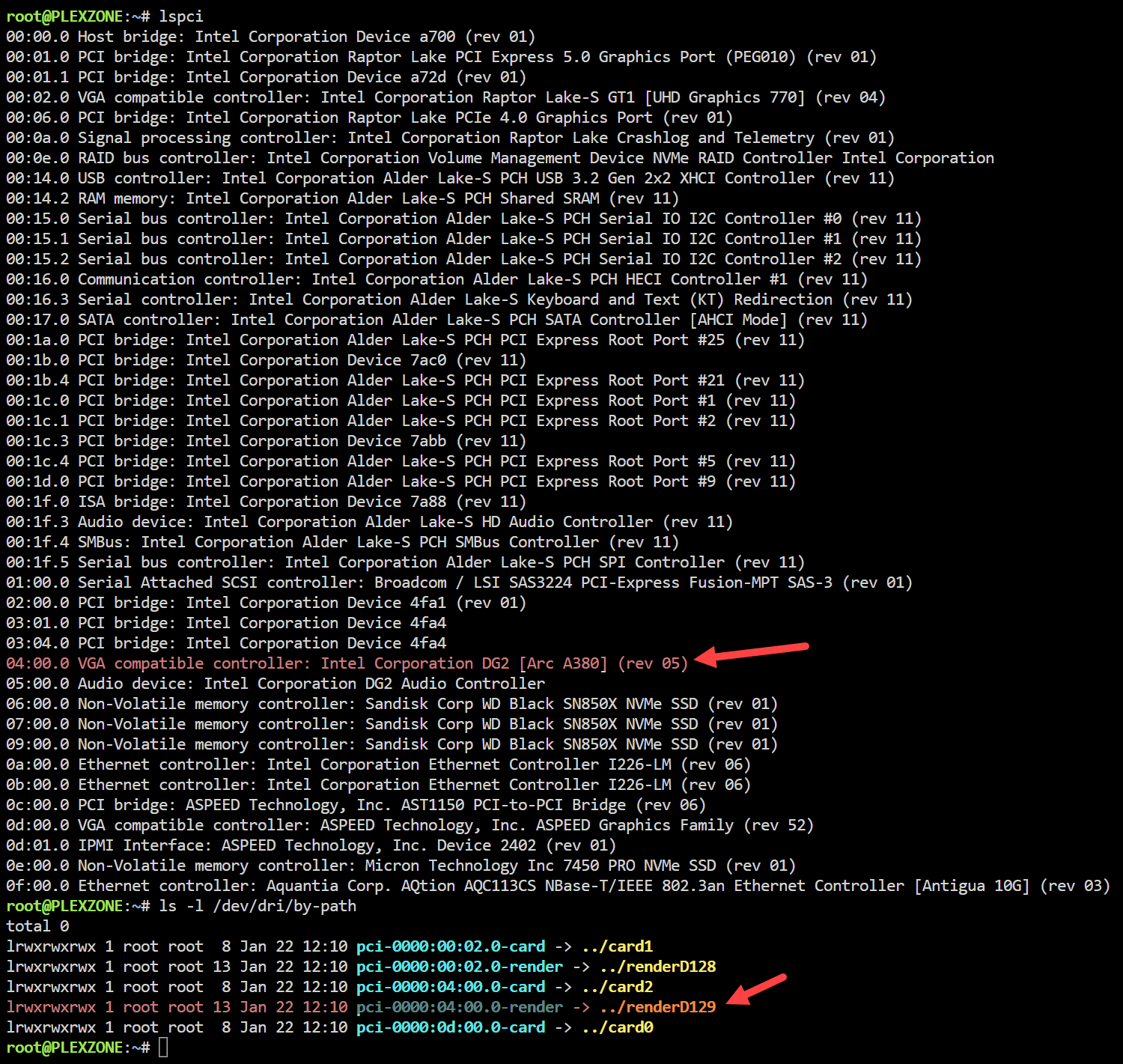

Ok so I finally got a ARC card the Sparkle-Arc-A380-Genie-6GB-GDDR6-RAM
And I am running the latest 7.0.0 Beta 2
But what do I need to get the Unmanic working?
And I can see the card is recognized in Unraid
Its the card 2 (I think) and the renderD129 (Wasnt there before)
So what do I need to do? So far I have done the normal
That didn't work so I did the old changes
image.png.8fed30e0aa1e436df6f2dddeb6572ba1.pngimage.png.80354bd7446cb0afa8f867c23f9356da.png

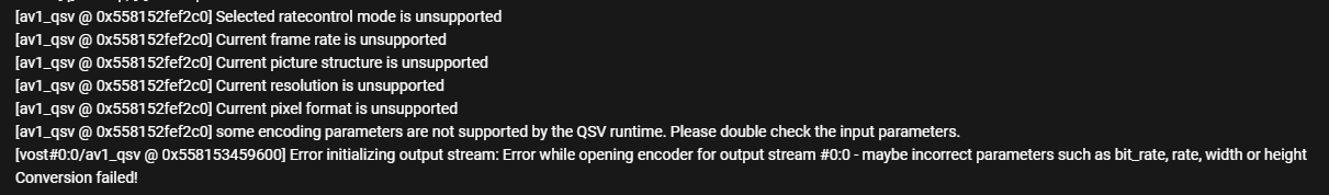

But the errors I get indicate that the HW isn't working in Unmanic
Encoding:
Any input on how people are running this successfully would be most welcome 🙂

I stand corrected and I just bought a ARC card just for Unmanic!
But for some reason I just cant get it working (2 time I am paying and giving up on this 😞 )

Ok, but I am running v7.0.0 Beta 2 and ARC is working GREAT when transcoding in Plex?
I just think I need some Docker setting to tell Unmanic to use the ARC instead of the QuicEnc.

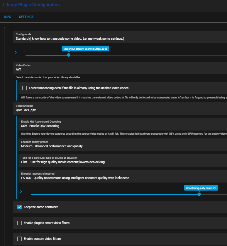

Running 7.02 beta..  Looking for the same thing. Can transcode with plex.  It appears that unmanic is using the cpu/video when it is active.  If i disable the internal GPU i can get unmanic to use the 310Arc that i have.

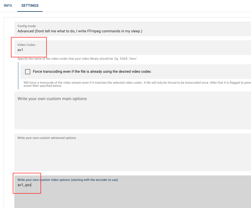

Ok i have figured it out.  There is a plugin named "Transcode Video Files"  You are able to chose intel or nvidia.  I have tested both and they are working. Extra Parameters "--runtime=nvidia --device /dev/dri:/dev/dri/" Add variables   NVIDIA_VISIBLE_DEVICES: Your GPU ID and Variable  NVIDIA_DRIVER_CAPABILITIES: all.  Screenshot2024-10-22at19_22_26.thumb.png.00e394db00117e2c92ba916128eed2b8.png

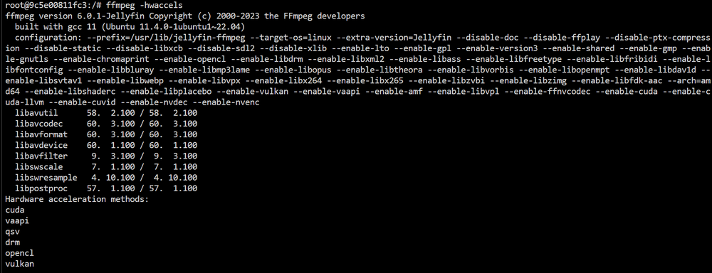

next thing to check is to make sure is that ffmpeg detects your gpu. if the gpu is passed through correctly, i can't imagine that it wouldn't, but just double check to avoid chasing rabbit. type
ffmpeg -hwaccels
this should return "vaapi".

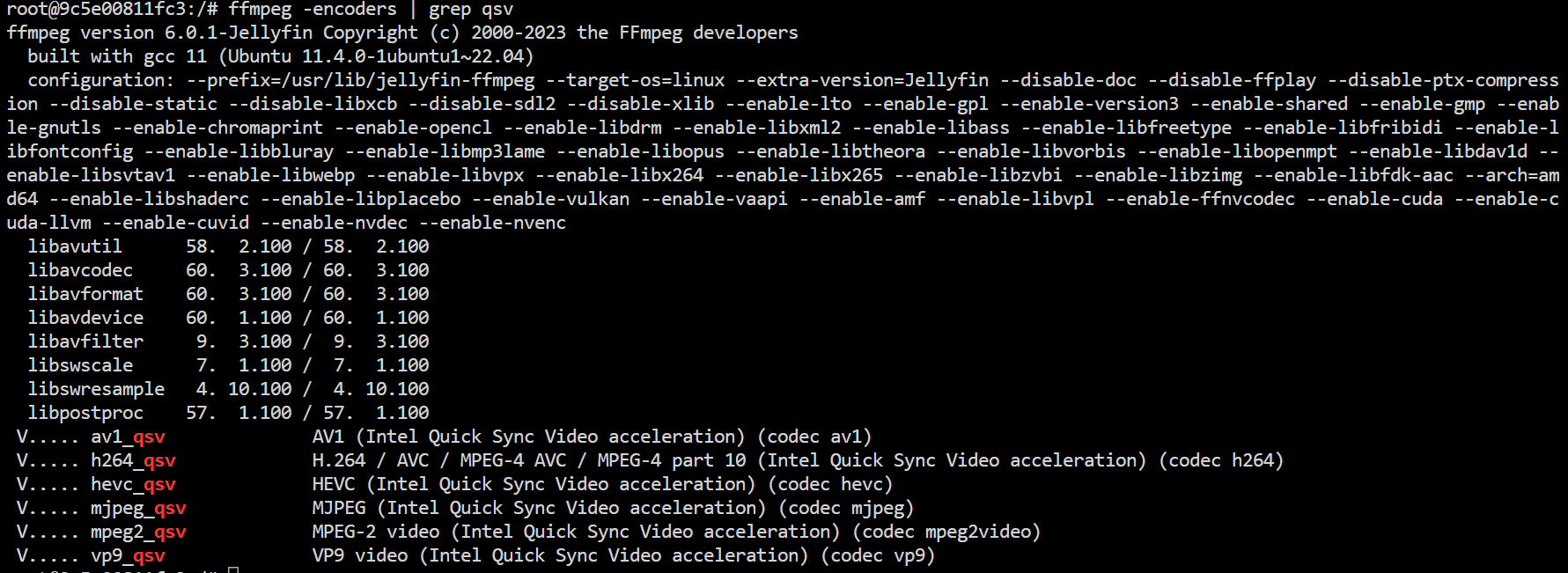

After all that, you want to make sure the container has the right qsv encoder for av1 that you're wanting. i don't have an unmondified unmanic container to check this, it's been a while since i've checked a clean install, so run
ffmpeg -encoders | grep qsv
you should see
V..... av1_qsv              AV1 (Intel Quick Sync Video acceleration) (codec av1)
returned as one of the listed encoders. if NOT, you need to install this in your container. if it does have it, then you simply need to enable it in the transcode video plugin i believe. you'll then need to add additional video options below it like bitrate, etc depending on what options that encoder has available. i'm not familiar with that encoder specifically. hope this helps.

This is Great I have just removed the Nvida card (Had given up on AV1 and the ARC card) and inserted it again.
I am seeing this:
Which gives me the configuration:
--device=/dev/dri/card2:/dev/dri/card0 --device=/dev/dri/renderD129:/dev/dri/renderD128
Unmanic: Docker terminal:
And:
And:
So am I missing some codec? and if I am how to go about this?
I have done the encoder config, but it does not utllize the card.
Again thanks for your help !!!
BTW: the 3 card listed is the built in IPMI card on the MB

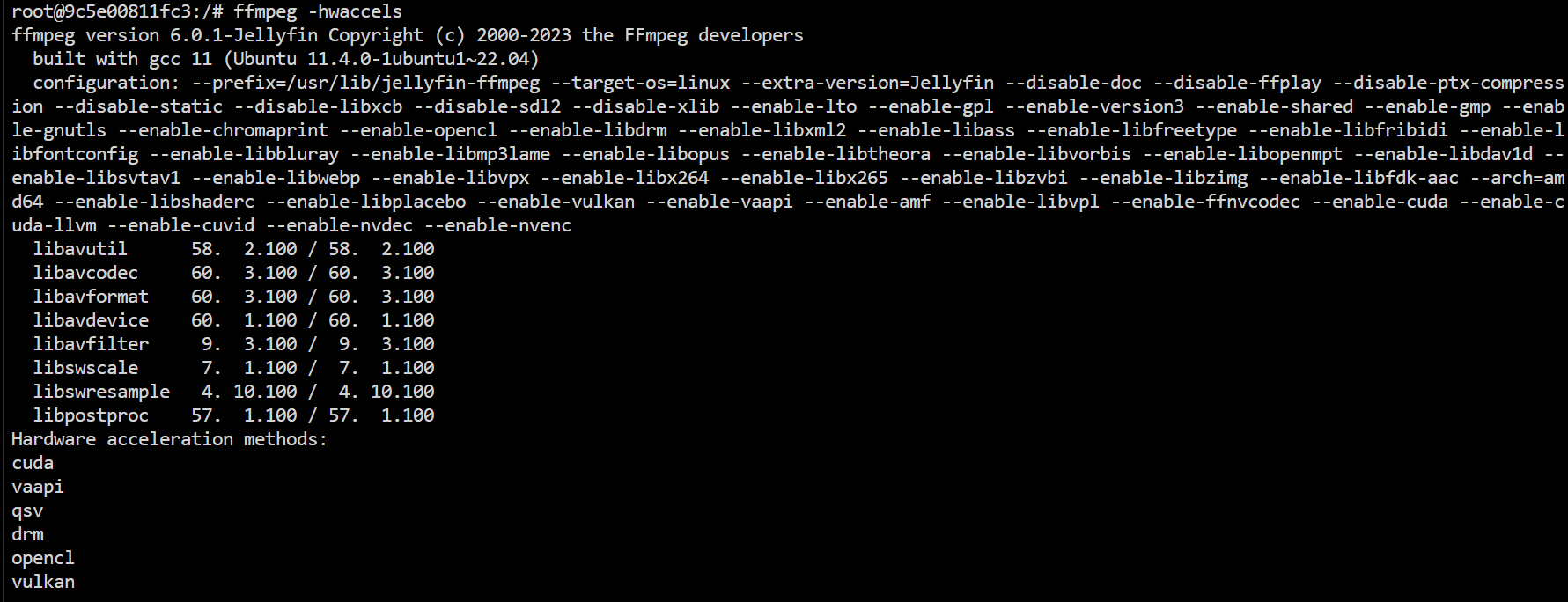

I've been trying to get gpu acceleration working for ages, found others with same problem but no solutions that I can find.
My CPU is a 5825U which should support h265 decode/encode and I already pass this through to plex, steam, and immich containers fine.
I have the usual extra parameter --device=/dev/dri added, within the container I see /dev/dri/card0 and /dev/dri/renderD128 which is usually a good sign.
looking at ffmpeg in the container, it seems to be set up for hardware acceleration showing vaapi at the end of the following command:
ffmpeg -hwaccels
ffmpeg version 6.0.1-Jellyfin Copyright (c) 2000-2023 the FFmpeg developers
  built with gcc 11 (Ubuntu 11.4.0-1ubuntu1~22.04)
  configuration: --prefix=/usr/lib/jellyfin-ffmpeg --target-os=linux --extra-version=Jellyfin --disable-doc --disable-ffplay --disable-ptx-compression --disable-static --disable-libxcb --disable-sdl2 --disable-xlib --enable-lto --enable-gpl --enable-version3 --enable-shared --enable-gmp --enable-gnutls --enable-chromaprint --enable-opencl --enable-libdrm --enable-libxml2 --enable-libass --enable-libfreetype --enable-libfribidi --enable-libfontconfig --enable-libbluray --enable-libmp3lame --enable-libopus --enable-libtheora --enable-libvorbis --enable-libopenmpt --enable-libdav1d --enable-libsvtav1 --enable-libwebp --enable-libvpx --enable-libx264 --enable-libx265 --enable-libzvbi --enable-libzimg --enable-libfdk-aac --arch=amd64 --enable-libshaderc --enable-libplacebo --enable-vulkan --enable-vaapi --enable-amf --enable-libvpl --enable-ffnvcodec --enable-cuda --enable-cuda-llvm --enable-cuvid --enable-nvdec --enable-nvenc
  libavutil      58.  2.100 / 58.  2.100
  libavcodec     60.  3.100 / 60.  3.100
  libavformat    60.  3.100 / 60.  3.100
  libavdevice    60.  1.100 / 60.  1.100
  libavfilter     9.  3.100 /  9.  3.100
  libswscale      7.  1.100 /  7.  1.100
  libswresample   4. 10.100 /  4. 10.100
  libpostproc    57.  1.100 / 57.  1.100
Hardware acceleration methods:
cuda
vaapi
qsv
drm
opencl
vulkan
within the settings I see the VAAPI device correctly.
But when the transcoding starts it just hits the CPU. No GPU is used at all (according to radeontop).
Does anyone have any ideas, or other tests I can run?
