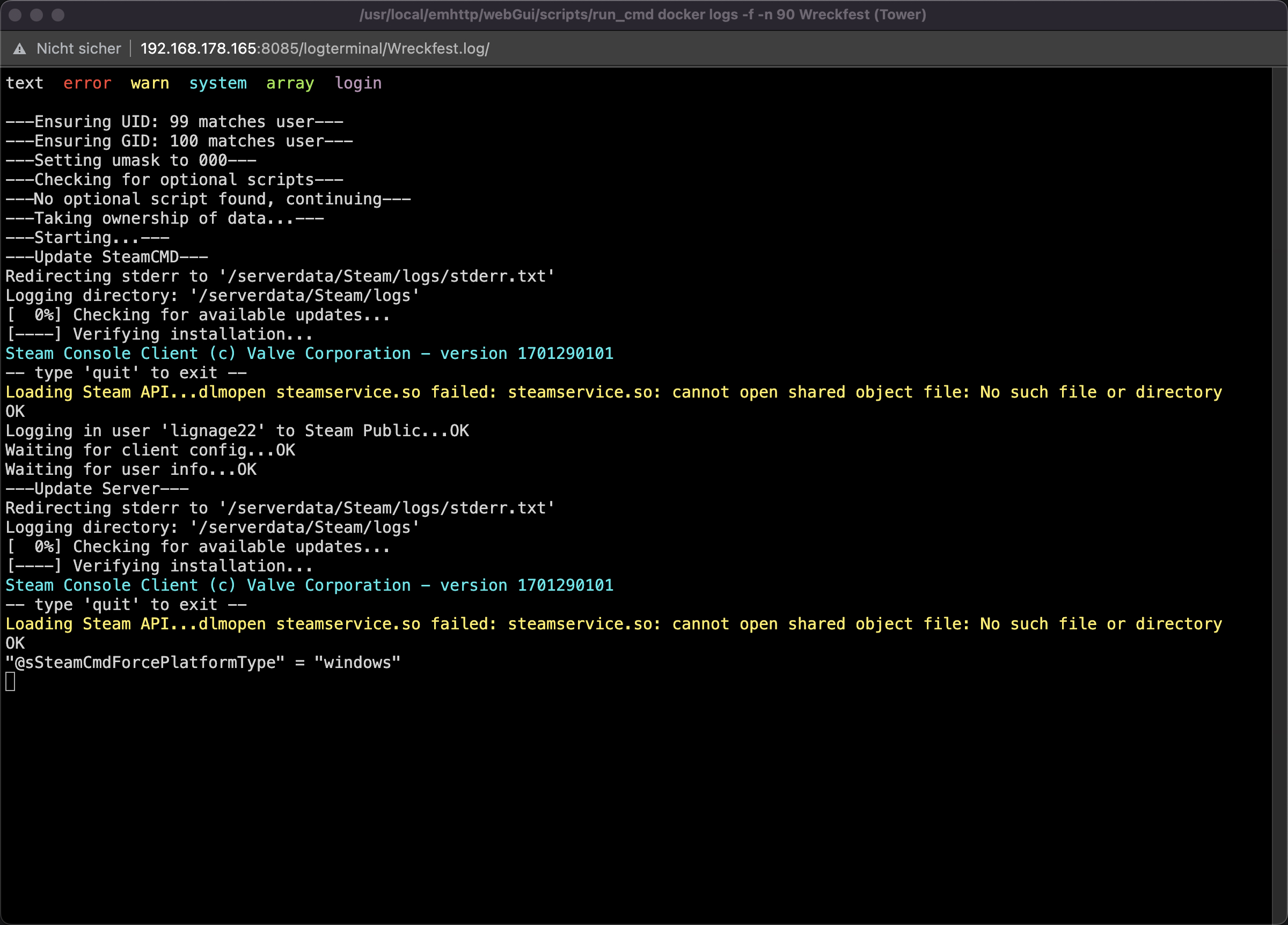

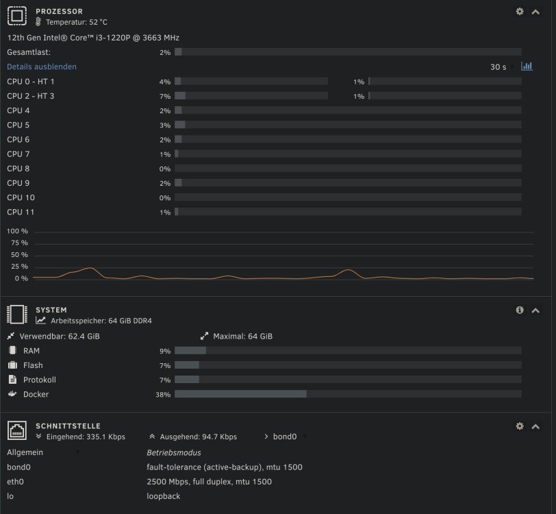

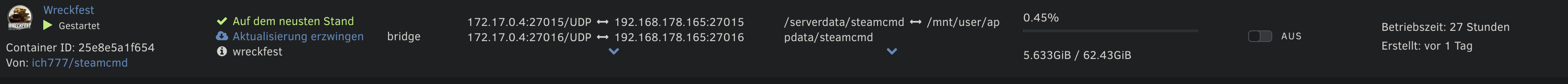

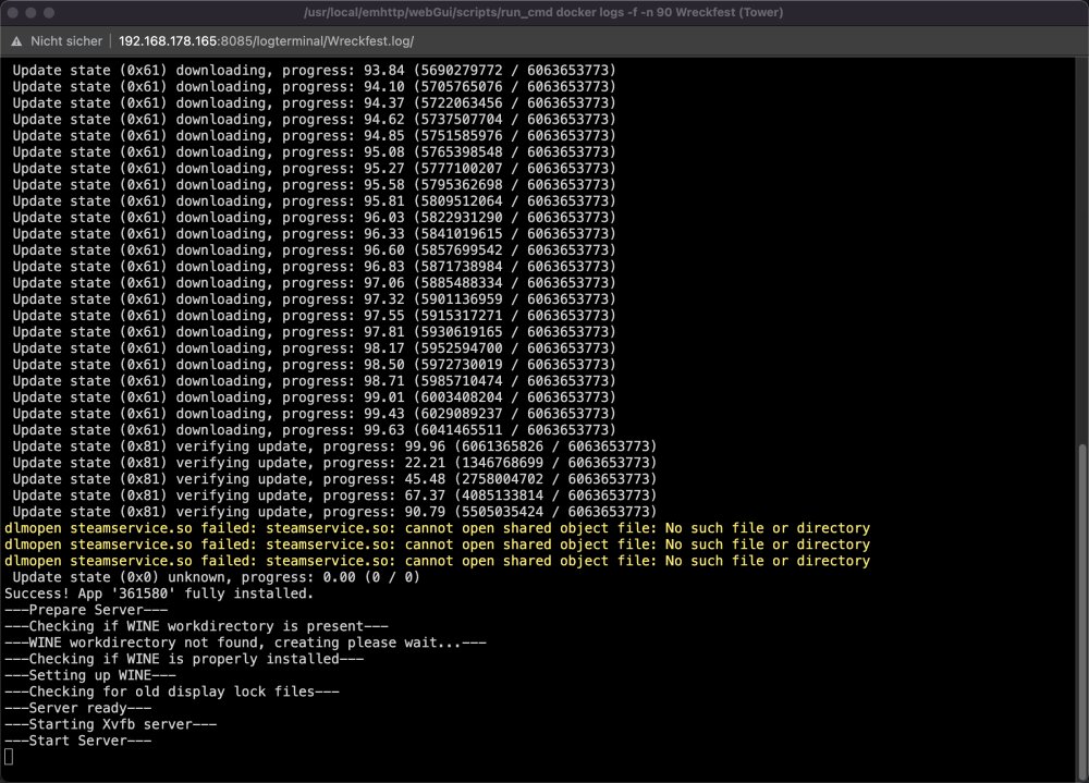

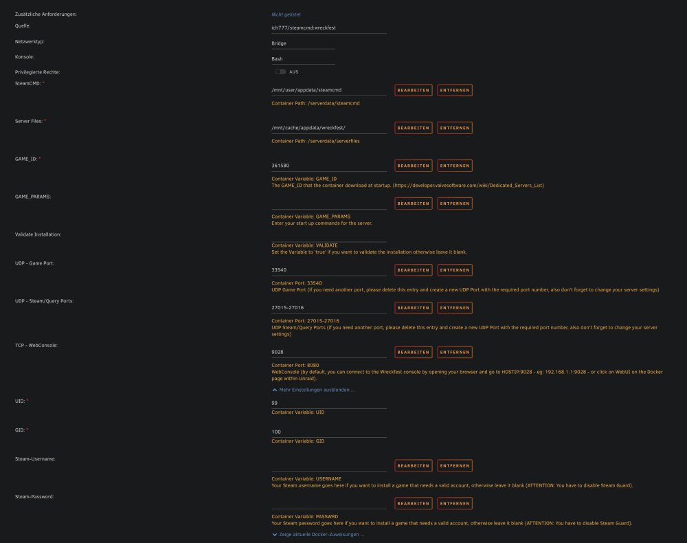

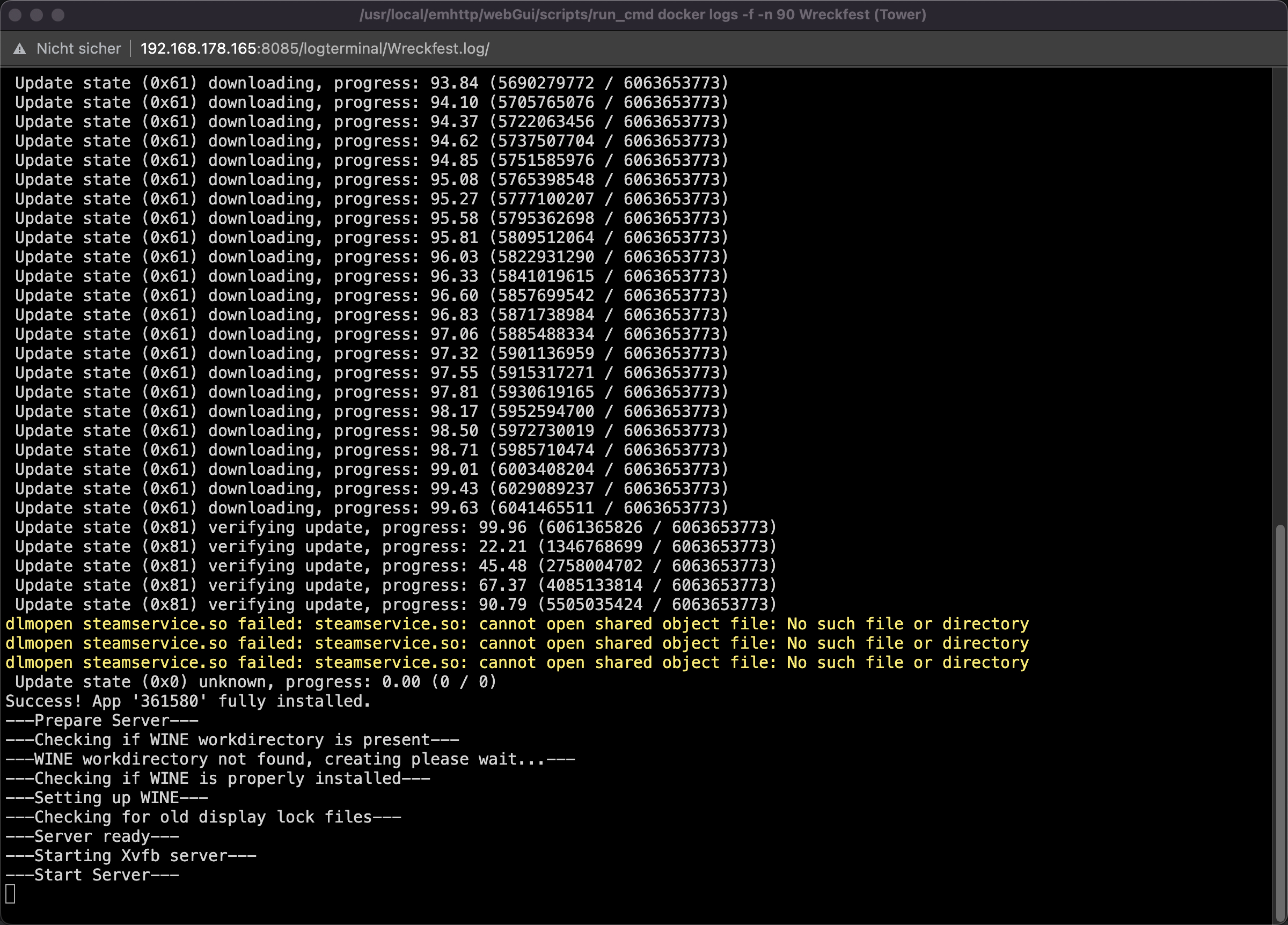

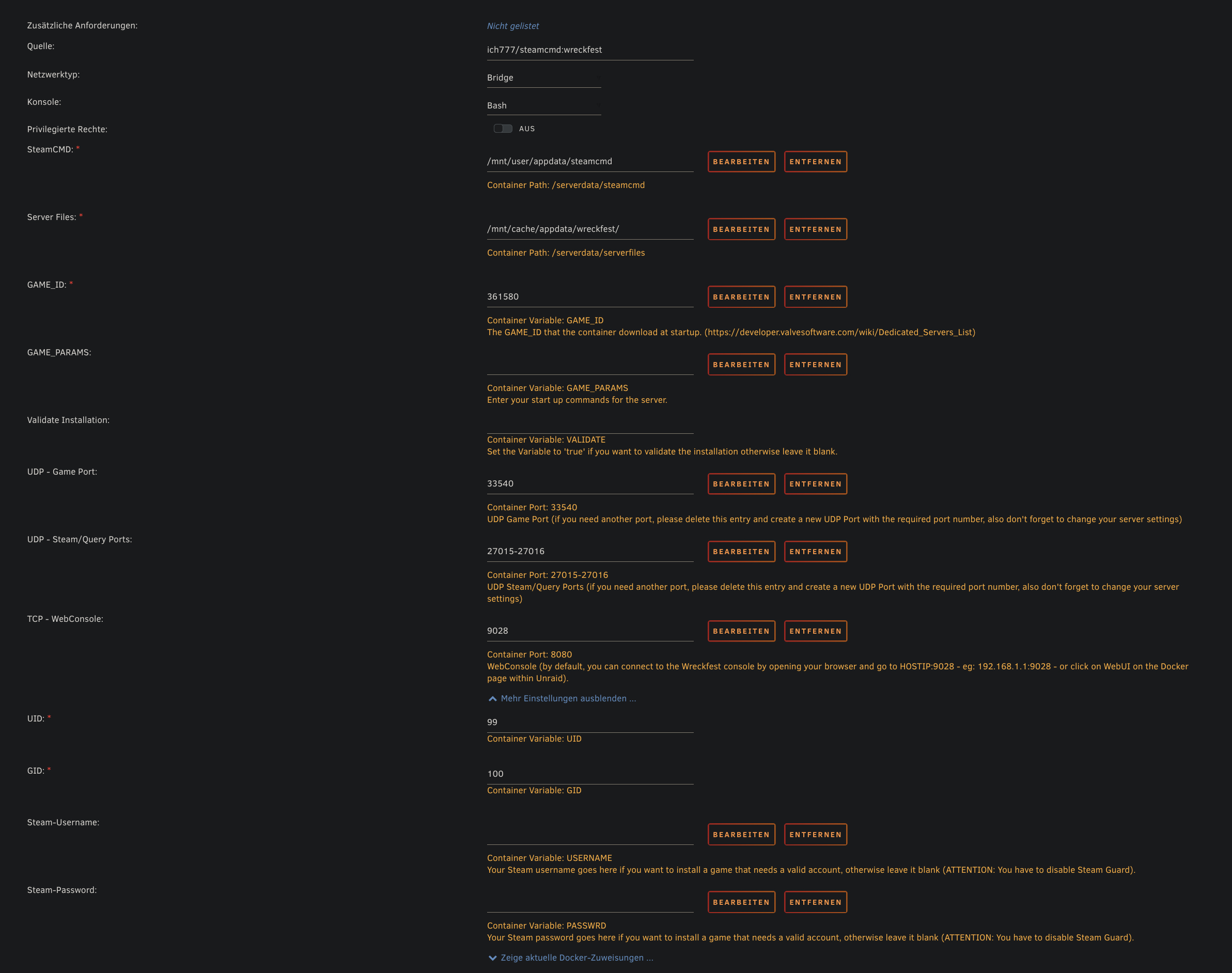

  6. "No, I didn't change the template; I did it exactly as you instructed. I deleted everything and then just started Docker. In the log, I saw the download, and Docker has been running for at least 24 hours. The Unraid server is powerful enough—12 cores and 64 GB of RAM, with an NVME as storage." "I don't have that log like yours. Mine hangs where I posted the second-to-last picture with 'Start Server'."
  7. "I tried that; sorry if I didn't make it clear. My first attempt was using the Steam server search, where there were profiles for this specific game. Even entering the IP didn't work. In the game itself, there's an option to choose local or LAN. I thought the game would automatically appear that way."
  8. "No, I haven't done that because I wanted to test it locally within my own network. Do I need to open ports for the installation?"
  9. "I've done everything so far; I believe the server is running. However, it doesn't appear when I'm in the game."
