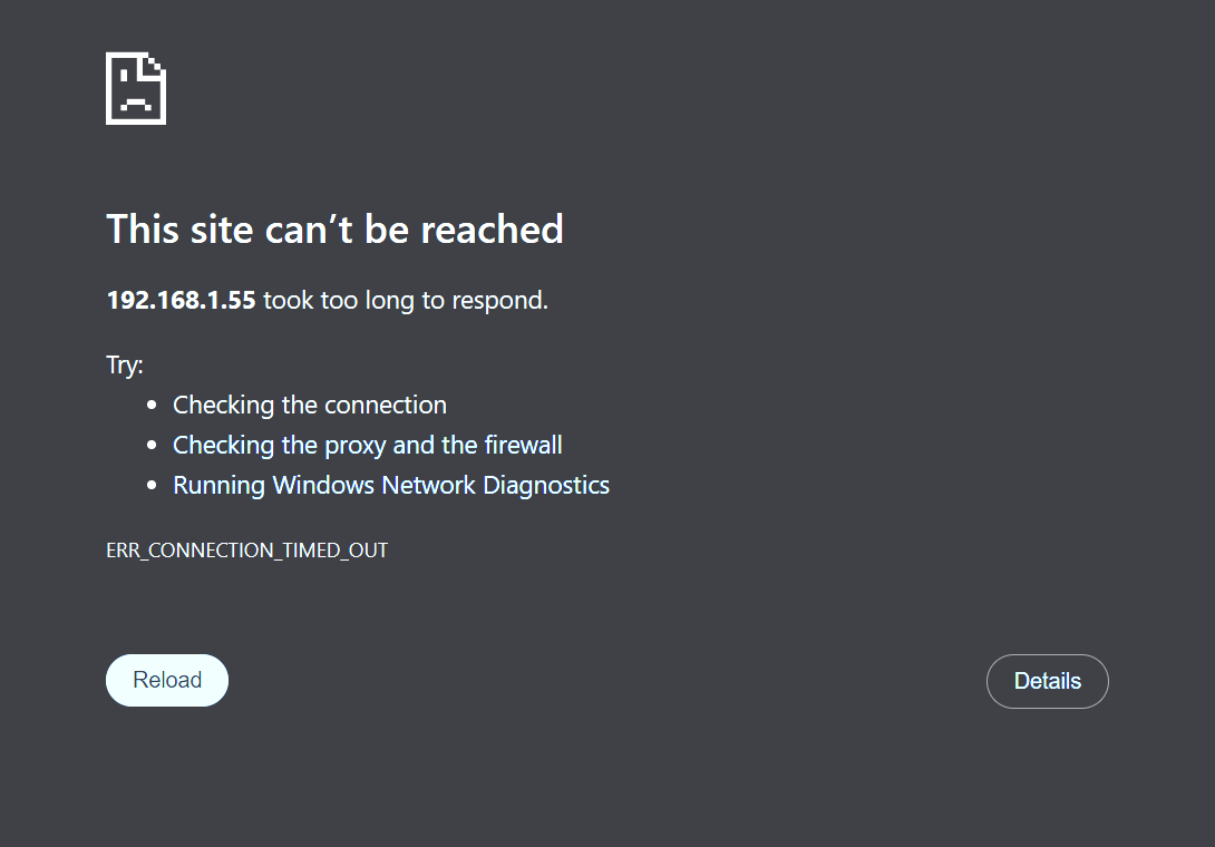

  7. Nope, I get site cannot be reached timeout. As for the ports, I have Port: Web Interface: set to 8687 and also the Variable: WEBUI_PORT: set to 8687. As stated previously, I have done a full reinstall of the docker with no joy. This was all working fine before I updated Unraid to 7.2.6. Below is the config for the docker. [AutoRun] enabled=false program= [BitTorrent] Session\AddTorrentStopped=false Session\Interface=tun0 Session\InterfaceName=tun0 Session\Port=49560 Session\QueueingSystemEnabled=true Session\SSL\Port=8930 Session\ShareLimitAction=Stop Session\UseRandomPort=false [Meta] MigrationVersion=8 [Network] Cookies=@Invalid() PortForwardingEnabled=false Proxy\HostnameLookupEnabled=false Proxy\Profiles\BitTorrent=true Proxy\Profiles\Misc=true Proxy\Profiles\RSS=true [Preferences] Connection\Interface=tun0 Connection\InterfaceName=tun0 Connection\PortRangeMin=6881 Connection\UPnP=false General\Locale=en General\UseRandomPort=false WebUI\Address=* WebUI\CSRFProtection=false WebUI\LocalHostAuth=false WebUI\Port=8687 WebUI\ServerDomains=* WebUI\UseUPnP=false
  8. The laptop ip is 192.168.1.65 and the Unraid ip is 192.168.1.55.

  13. With 192.168.1.0/24 the WebUI was getting page not found, whereas changing it to 192.168.1.2/24 fixed the issue and WebUI works. I am not sure of the reason why, only that it works now. Could it be that my gateway is 192.168.1.1 and so the router did not like having it's IP address included in the IP range?
  14. That is the only thing that got it working for the WebUI.
  15. I finally got it working, I changed Variable: LAN_NETWORK: setting to my network range and now it works, default was 192.168.1.0/24, I updated it to 192.168.1.2/24 .
