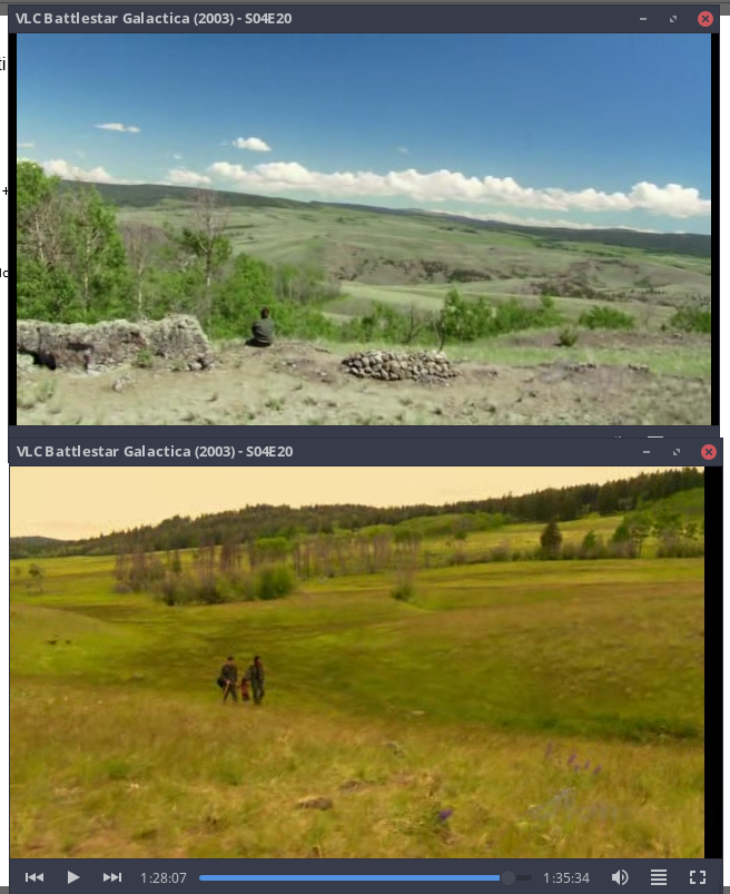

Hi again,
i have been investigating this for a while but can't find a solution.
When i encode a file, most times the encode mkv has "added" a vertical black band to the right:
My settings ATM are:
original width of the source file is 624 pixels.
Any idea?
Thanks.
are you sure its added ? in your "snipplet" its looking ok as its filled top & bottom.
what is the height and aspect ratio from your source and targets, may check with mediainfo to compare, or play them side by side with 2 VLC Instances ...

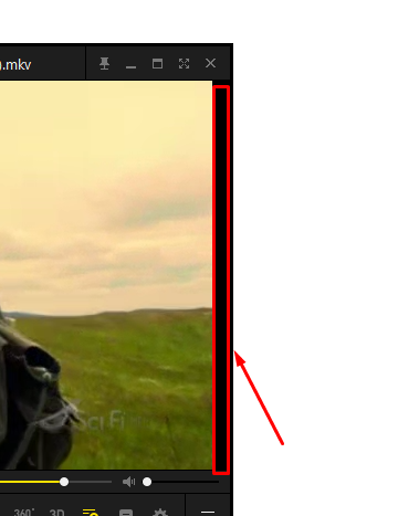

Top and bottom are filled but on the right it adds that vertical black bar.
Those are the properties of source file:
As far as the comparison, original on top, converted on the bottom:
In other cases (other video), i even squeezed the frame to make room for the right vertical bar.
looking weird anyhow, Top (Original) black bar left & right (centered), Bottom (encoded) black bar right (left alligned).
about the pixel aspect ratio, low quality ~ 16:9 .. what is the resolution on the encoded video ? if its similar its just weird looking on a mirrored VLC session, should be pretty fine on a 16:9 screen (fullscreen), only if the black bars are really hardcoded ... and not only "fillers" right now to match the windows screen. Or are those black bars really included in the video ?
why its left alligned instead centered ... i cant imagine right now from your infos
I doin't force a resolution, so the encoded one should be the same of the source.
As far the bars, they are shown in every player i tried, including the one in my TV (16:9).
So, i'm clueless.

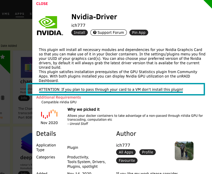

OMG please update. I spent over 2 hours trying to figure out how people do it with VMs since the NVidia Driver plugin says not to download if you plan to pass through GPU to VM. All the videos I found (including the Cpt Chaz video that you posed in the video guide section) all suggest you need the Nvidia Driver plugin.
So to be clear:
1. We do not need the Nvidia Driver plugin and do not insert UUID; only "adding the --runtime=nvidia option"?
2. It IS okay to run Unmanic NVidia encoding while also using a VM all on the same GPU?
If NOT, then what do you suggest?
- I only have 1 Unraid machine, but I do have other desktops and laptops.
Thank you very much, I am pumped to use it! maxed out my 24TBs. You rock
So to be clear:
First post updated.
You probably will find that you cannot use the GPU on the host for anything if it is being passed through to a VM.
I'm pretty sure (but am not going to test this for you) that the NVIDIA docker runtime will not work without installing a NVIDIA driver on the host. Therefore, I'm pretty sure the linked documentation is correct for anyone who wishes to use Unmanic with the latest version of Unraid and a NVIDIA GPU.
