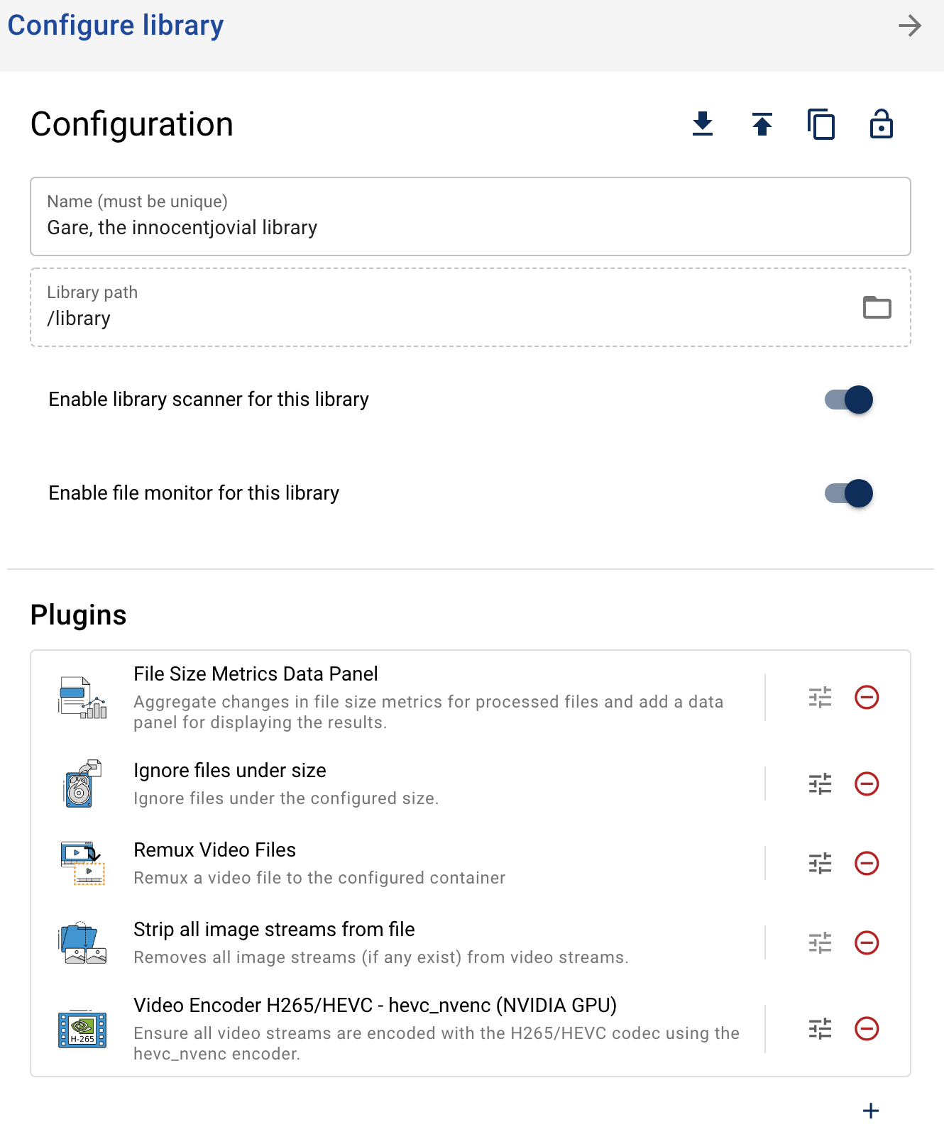

  • @Ashe @trekkiedj @itimpi   Please see update first post also for an example of how I have it setup. I have also added a temporary solution to adding multiple library locations if anyone need

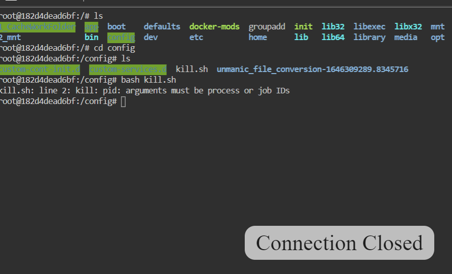

6 hours ago, Josh.5 said:
Interesting. Did you write it in windows and then copy it over? Does it have windows line endings?
No, it does not have windows CRLF.
I can run the script (if you can even call it that) in console with same command:
bash /config/kill.sh
It waits, then self destructs the docker.
Edited by OrdinaryButt
Attached screenshot

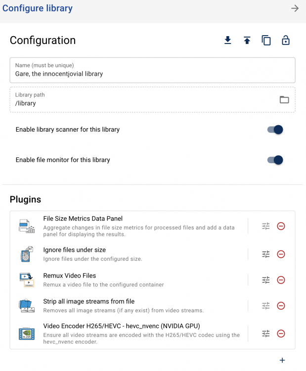

i had a similar issue with the latest release.  there are a couple of new steps that have to be done.  What i did was to remove the container and then delete the folder in the app directory.  This will allow you to reinstall with all of your container settings.  once installed go the unmainac webpage and go to settings.  In the libraries directory you need to edit the library to turn on the scanning options, and then reinstall your plugins in the LIBRARY Configuration page.
thanks, i didn't realise it had been updated. its now backup and running.
