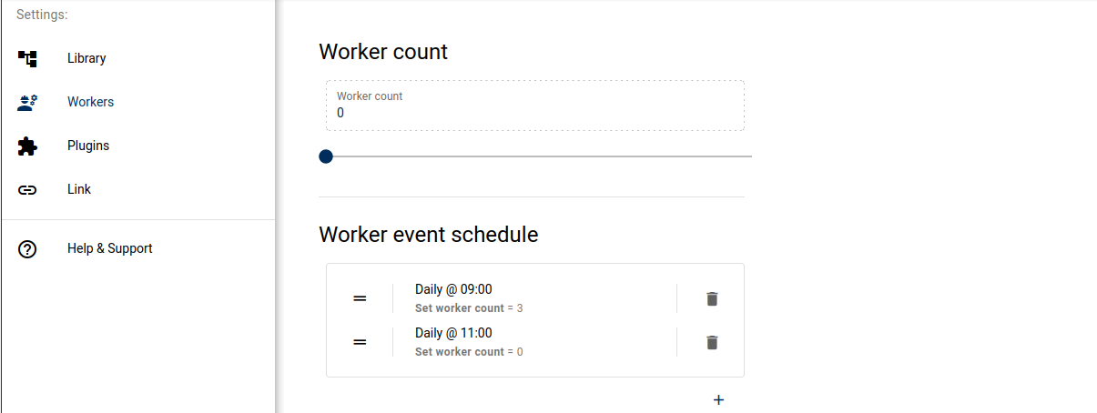

I am looking for a "smart" way to stop unmanic docker after tasks have been completed or no tasks to execute shortly after start.

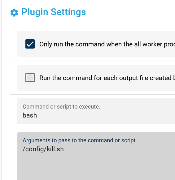

I think I can use the "External script" plugin and simply send "kill pid 1" which when tested thru unManic's terminal, does shut down the container. This should work BUT I am woried:
A) either will cause a start stop loop if there are no pending tasks *EDIT* - I can do "sleep 60 && kill pid 1" which would give me enough time to change config should I need to.

If you schedule the worker count, then that will do all of this for you. There is an old API endpoint which is not well documented for triggering the library scan, you could curl or wget that on a cron job. Or you could just let the library scan run whenever, but scale the worker count on a schedule like this:
This will set 3 workers to start at 9AM and then stop them when their next task completes at 11AM by setting that value back to 0.

Sorry, I did miss this part but I have to admit, the wording is a bit unusual. I think it will do the trick though.
I would be nice to know what I did wrong with the kill PID method. I tried simply executing a script with bash command and it didn't run (same commands works fine in CLI). Here is the log:
2022-03-02T05:46:25:INFO:Unmanic.Plugin.postprocessor_script - Execute command 'bash /config/kill.sh'.
2022-03-02T05:47:25:ERROR:Unmanic.PluginExecutor - [FORMATTED] - Exception while carrying out 'postprocessor.task_result' plugin runner 'postprocessor_script'
  File "/usr/local/lib/python3.8/dist-packages/unmanic/libs/unplugins/executor.py", line 272, in execute_plugin_runner
    runner(data)
  File "/config/.unmanic/plugins/postprocessor_script/plugin.py", line 161, in on_postprocessor_task_results
    exec_subprocess(cmd, args)
  File "/config/.unmanic/plugins/postprocessor_script/plugin.py", line 87, in exec_subprocess
    raise Exception("Failed to execute command: '{}'".format(full_command))
Exception: Failed to execute command: 'bash /config/kill.sh'

What is the contents of the kill.sh script?
sleep 60
kill pid 1
