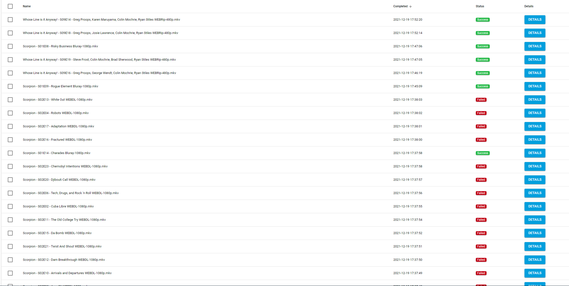

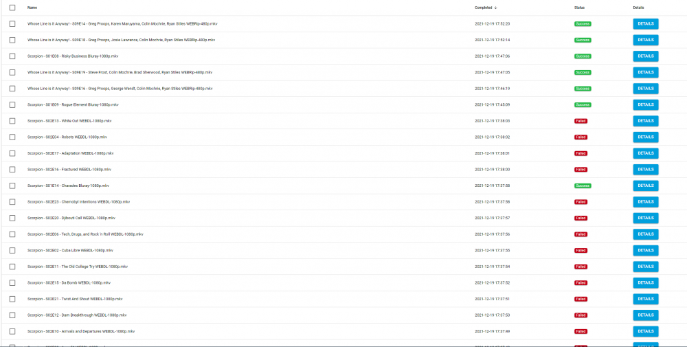

Hello Need some help on this. I have been getting this below on a lot of video files.
Stream map '0:s:1' matches no streams.
To ignore this, add a trailing '?' to the map.
Where would I add the trailing ? to the map?
I am using the Nvidia plug in for this.
(edited for misspelled words)
Edited by Jurak
Has this just started?
as far as i can tell. I noticed today but looking at the history its really recent.
ok between the 14th and yesterday There was 20 failed with this error below.
Error initializing output stream 0:0 -- Error while opening encoder for output stream #0:0 - maybe incorrect parameters such as bit_rate, rate, width or height
Conversion failed!
But starting this morning most of not all of the files are failing with this below on all of them.
I have noticed today that the scanning of my fairly large library is much faster now. So thanks for that.
Edited by Jurak
Conversion failed!
Did the issue start after you updated the the latest release?
I have everything set up for auto update which it checks every night for updates. So don't know when it last updated it would be the night of when you last released the newest update. Since this started today I think it updated last night.
Edit:
I looked up my logs. Yes it updated last night and this started a little after the update finished.
Edited by Jurak
Edit:
Are all the plugins up to date?
Yes they are up to date.
12 hours ago, Jurak said:
Its about half of the videos fail to convert with the above logs entries.
But some are succeeding?
Yes some of them are succeeding. Do you have any recommendations for this?
Below is a full log of one that just failed.
LOG:
