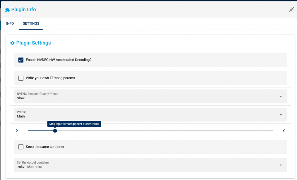

Too many packets buffered for output stream 0:1.
I have 256GB of RAM and was doing a packet buffer of 10k. I reduced that to 4096. See if that helps alleviate the packet buffer error.

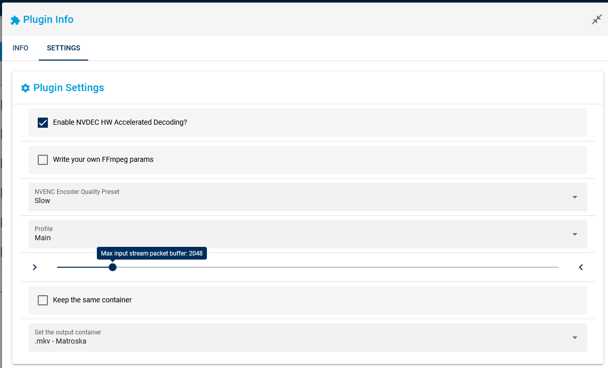

I'm getting constant errors when writing MP4->MKV file conversion:
[quote]
x265 [info]: frame I: 25, Avg QP:18.95 kb/s: 5938.62
x265 [info]: frame P: 1018, Avg QP:20.10 kb/s: 4848.96
x265 [info]: frame B: 2053, Avg QP:23.89 kb/s: 1874.06
x265 [info]: Weighted P-Frames: Y:3.8% UV:3.3%
x265 [info]: consecutive B-frames: 16.8% 16.2% 25.8% 35.3% 5.9%
encoded 3096 frames in 3442.70s (0.90 fps), 2885.06 kb/s, Avg QP:22.60
Conversion failed!
[/quote]
I've reduced the buffer down to 2048 and still get this same issue. Why?
2 hours ago, CyrixDX4 said:
You are using Hardware encoding, I'm using CPU encoding, big difference in performance with the two models.
[quote]
Conversion failed!
[/quote]

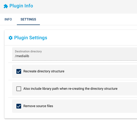

I was playing with the mover plugin. Seems like the converted file is being copied from /tmp to both source location as to the mover location. Then both old and new file get removed from the source location.
Seems like double the I/O / transfer.
https://pastebin.com/yjdc41dj
And the folder in which the source was located is not removed. Would be nice to have.
Seems like you have configured the mover plugin to "Remove source files". Is that correct? Could you tell me how you have configured your "File Movement" plugins flow?
I took a look at your log. I am not sure why the file was copied twice to '/library/movies/' ... That does not seem right. It should have been copied there only once.
As for the removal of that file after the copy, I think you are right. I will rewrite the default Unmanic post-processor for file moments to overwrite the source such that if the file is flagged for removal, then not to bother.
I'm still scared to let unmanic loose on my complete media folder. So I'm playing around and selecting manually what to let unmake have a go at.
I manually move movie folder to: /mnt/user/media/unmanic/movie/ this is mounted to /library/movies.
I added an extra mount mount point in the docker to /mnt/user/media mounted to /medialib.
Last step I added because I'm happy with the results so far, and instead of manually move back converted folders, I gave 'Mover v2' a go.
Should the mover plug in not make sure the converted file is moved only once from /tmp to the destination location? not copying to both /medialib/Movies/ and to /library/Movies (which from the log it seems to do twice)
I have turned on the "Remove source files". So all the copies from /tmp to /library/Movies are unnecessary as they will be removed.
PS, just giving feedback on the plugin, when I let unmanic have access to my main media folder, I won't be using the mover plugin.
Have a go and pulling the staging branch like I mentioned in my last post and let me know how you get on.

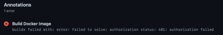

seems GitHub had an issue with building
staging
Ha! There is always something. Am I right?!
Looks like there is an issue with docker hub. I've re- triggered the build/push. If it fails again I'll try again in the morning.
Edit:
Nvm, looks like I broke my pipeline earlier this week and didn't notice.
Sorry. It's been a long day... I'll sort it out tomorrow.
