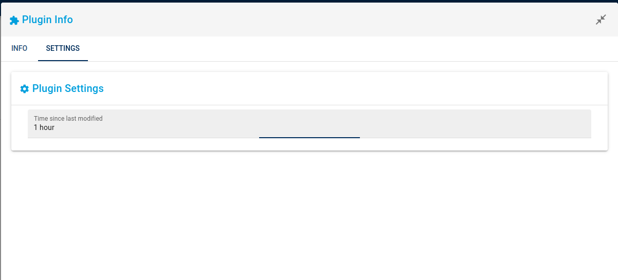

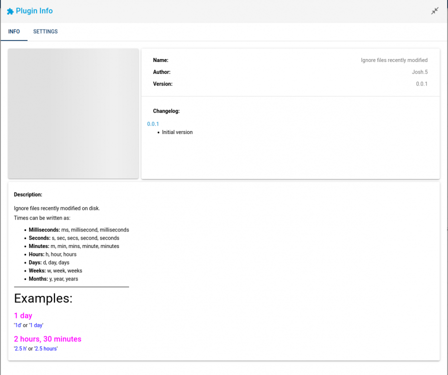

I can make a plugin to ignore files under a configured age. Eg. Ignore files newer than 1 hour. That will prevent your ones being picked up while still being written to.
The last option is to not use the library scanner with these files. Use the event monitor. That will only pickup files on completion of writing.
I'm not certain but I don't think they have any suffix. But the plugin you mention sounds about like what I was saying. I know with MCEbuddy there was an option to wait until a file hasn't been modified for 1 minute and up to 60 days or something like that.

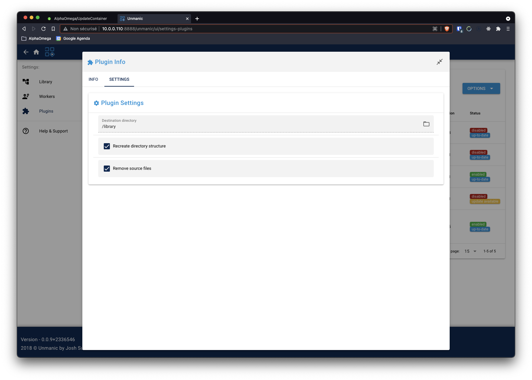

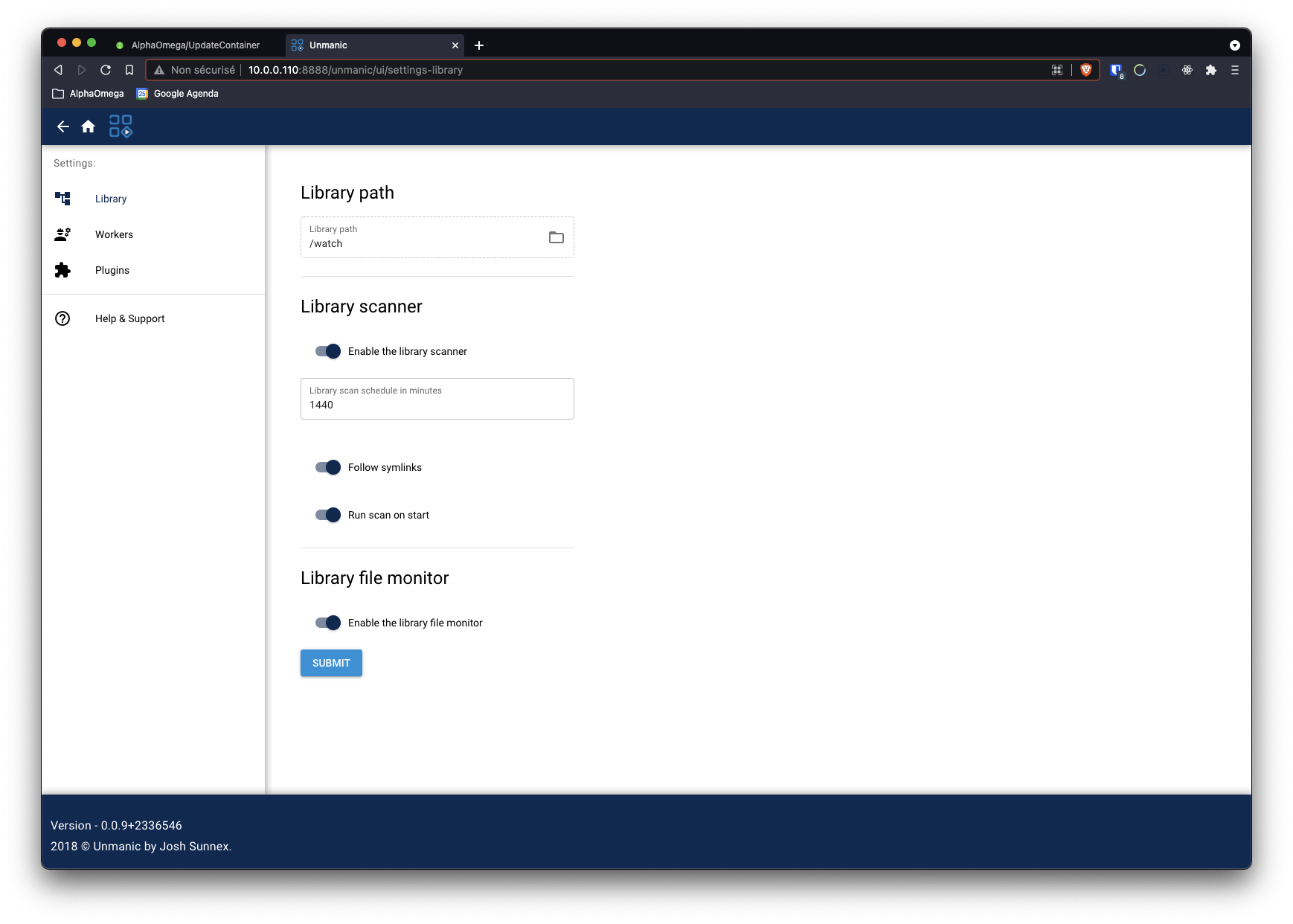

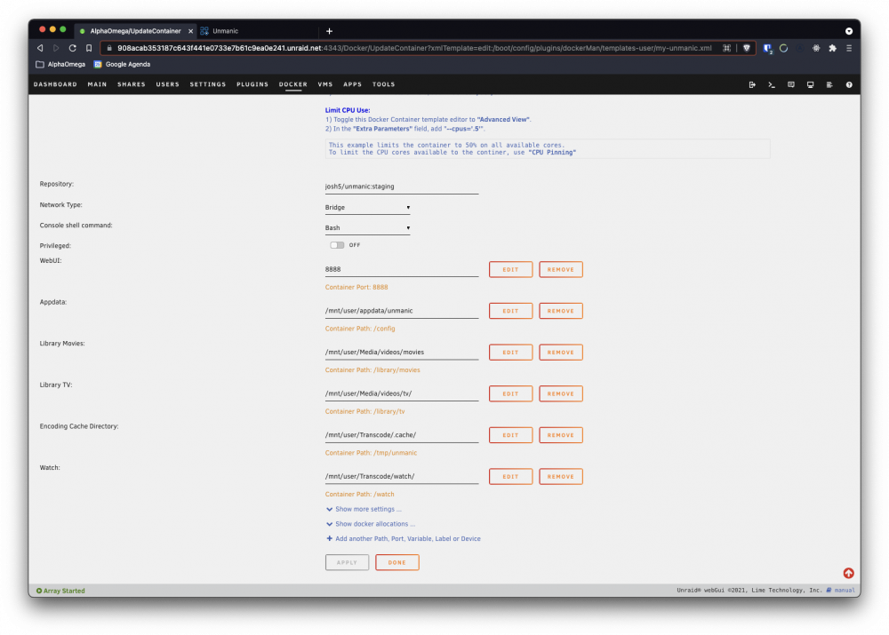

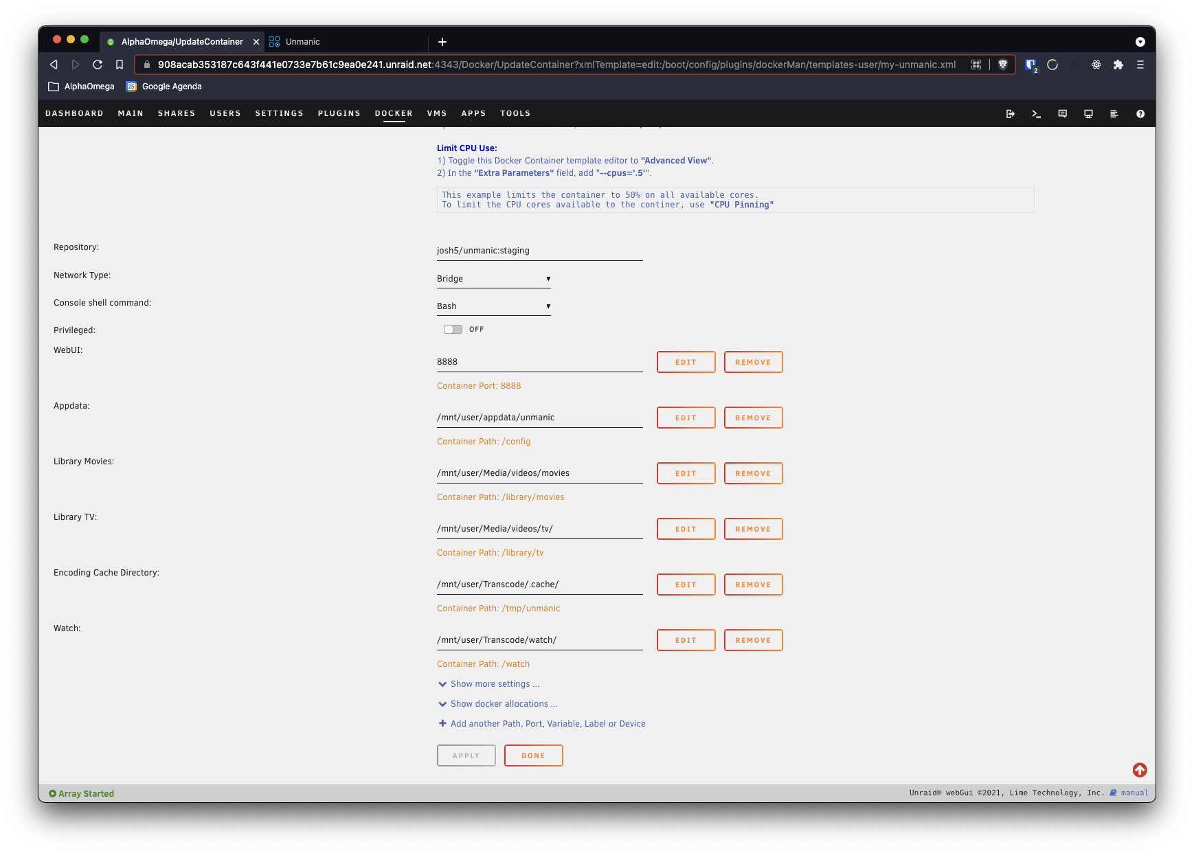

Alright,
First of all here's my docker config:
I basically created a watch folder that I put files that need to be transcoded, that would be my /watch directory that I use as my library path:
After that, I use the move2 plugin to put my transcoded file in my Emby library (/library) and delete the source file in the /watch directory:
16 minutes ago, rbourassa44 said:
Alright,
Great. Thanks for the images.
The problem is your '/library/watch' directory does not exist. It is not mounted into your Docker container.
You have '/library/tv' and '/library/movies' mounted in, but no '/library/watch'
Also, those are some fancy looking screenshots! Rounded windows popping out with shadows applied behind them. Damn Apple.

So if I understand correctly, when you select the "Recreate directory structure" in the mover2 plugin, it's also adding the root library path (in my case that would be "/watch" resulting in "/library/watch/movies/etc...")?
Is there any ways that I could make it add only the subfolders (like "/library/movies/etc...")?
By the way, huge thanks for this, I'm definitely subscribing on patreon!
1 hour ago, rbourassa44 said:
Oh I just got it I don't know why I did not catch that..
So there is a little trick that you will want to do with Docker to achieve what you are asking here.
Basically, map the external directory, eg '/mnt/user/Media/videos/movies' to '/library/watch/movies' inside the container.
The problem is that everyone will have a different use case with different folder structure. So the only way to handle this is to include the full path right back to the root '/' directory. Then it is up to the user to create their directories accordingly. Docker makes this easy obviously with the little trick I just mentioned above. But this will be more of a problem for people who install and run this native on their host.
Also, appreciate the support on patreon. Thanks!
Actually... as I am thinking about it further, I realise there is a way to do what you are asking...
I could add a fourth config option to that Plugin where you can remove the library path from the recreated directory structure. That would remove '/watch' - which is exactly what you were wanting. It would also be versatile and work on anyone's installation, native or docker

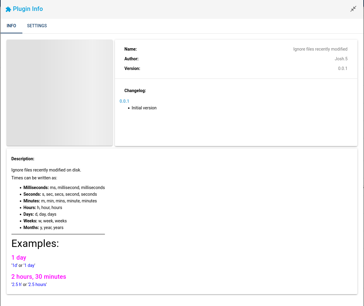

I have whipped up a plugin as requested for your needs. Called "Ignore files recently modified", you will find it in the plugin installer on the new "staging" build of Unmanic.
This Plugin can be configured to ignore files that were last modified x time ago (can be seconds, mins, hours, etc.). Add it as one of the first items in your Plugin Flow. It will fail if a file was last modified more recent than the time configured, and no other tests will be carried out against the file - it will be ignored and not added to the task list.

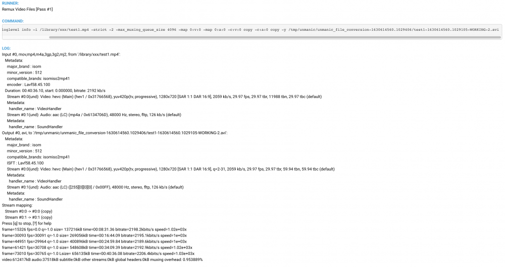

On 9/1/2021 at 10:56 PM, Josh.5 said:
There is also a plugin specifically for remuxing video files. Search for "remux" or "container" in the plugin installer.

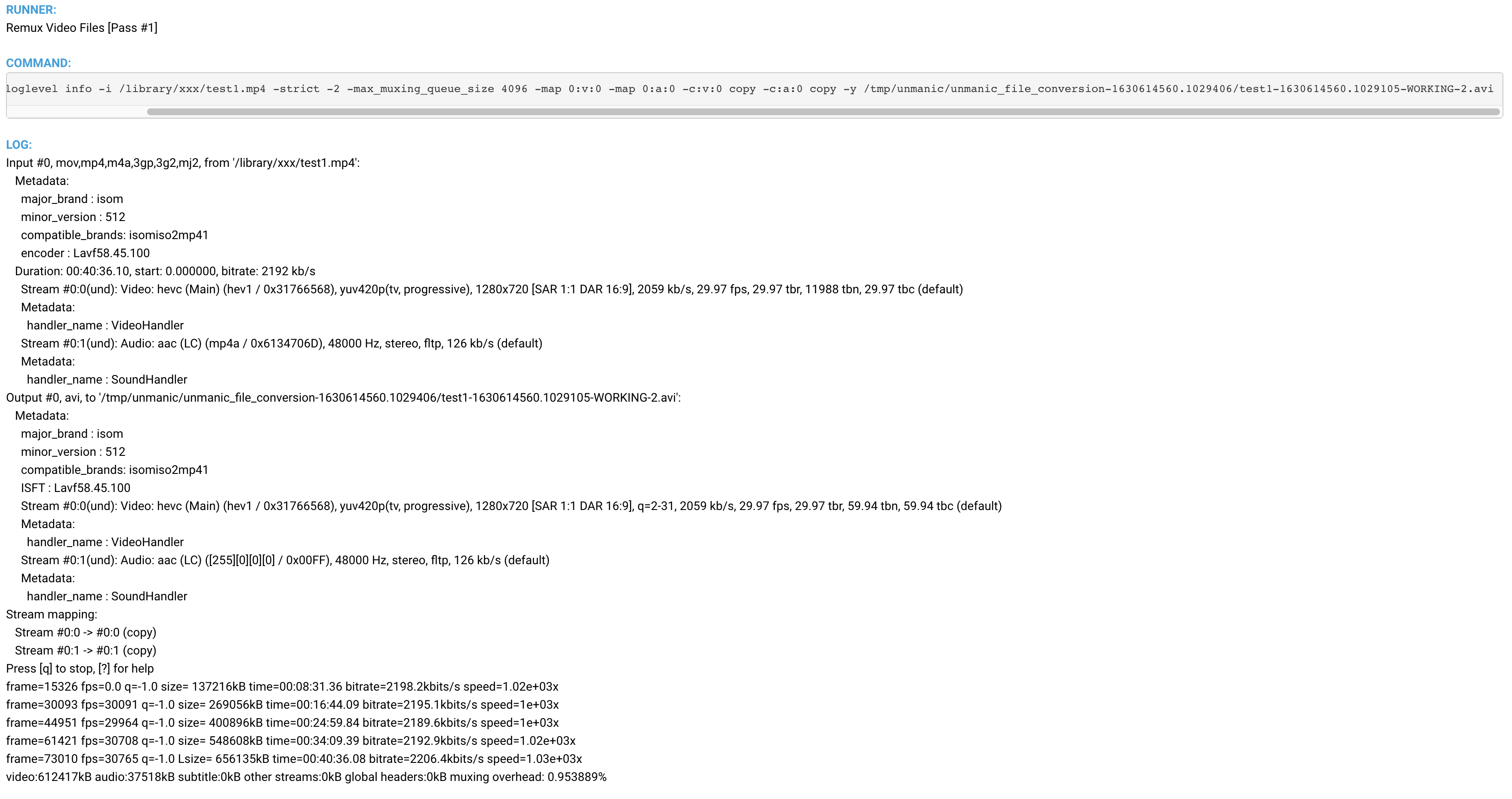

I have the remux plugin installed however it is not changing the file name
2021-09-02T16:19:40:INFO:Unmanic.TaskHandler - [FORMATTED] - Adding inotify job to queue - /library/xxx/test.mp4
2021-09-02T16:19:41:INFO:Unmanic.Foreman - [FORMATTED] - Processing item - /library/xxx/test.mp4
2021-09-02T16:19:41:INFO:Unmanic.Worker-W1 - [FORMATTED] - Picked up job - /library/xxx/test.mp4
2021-09-02T16:19:45:INFO:Unmanic.Worker-W1 - [FORMATTED] - Successfully ran worker process 'video_remuxer' on file '/library/xxx/test.mp4'
2021-09-02T16:19:45:INFO:Unmanic.Worker-W1 - [FORMATTED] - Successfully converted file '/library/xxx/test.mp4'
2021-09-02T16:19:45:INFO:Unmanic.Worker-W1 - [FORMATTED] - Moving final cache file from '/library/xxx/test.mp4' to '/library/xxx/test-1630613985.7216587.mp4'
2021-09-02T16:19:45:INFO:Unmanic.EventProcessor - [FORMATTED] - MOVED_TO event detected: - /library/xxx/test.mp4
2021-09-02T16:19:45:INFO:Unmanic.Worker-W1 - [FORMATTED] - Finished job - /library/xxx/test.mp4
2021-09-02T16:19:45:ERROR:Unmanic.FileTest - [FORMATTED] - Exception while carrying out plugin runner on library management file test 'ignore_under_size' - [Errno 2] No such file or directory: '/library/xxx/test.mp4'
File "/usr/local/lib/python3.8/dist-packages/unmanic/libs/filetest.py", line 135, in should_file_be_added_to_task_list
plugin_runner(data)
File "/config/.unmanic/plugins/ignore_under_size/plugin.py", line 67, in on_library_management_file_test
if check_file_size_under_max_file_size(data.get('path'), minimum_file_size):
File "/config/.unmanic/plugins/ignore_under_size/plugin.py", line 45, in check_file_size_under_max_file_size
file_stats = os.stat(os.path.join(path))
FileNotFoundError: [Errno 2] No such file or directory: '/library/xxx/test.mp4'
2021-09-02T16:19:46:INFO:Unmanic.PostProcessor - [FORMATTED] - Post-processing task - /library/xxx/test.mp4
2021-09-02T16:19:46:INFO:Unmanic.PostProcessor - [FORMATTED] - Copying file /library/xxx/test-1630613985.7216587.mp4 --> /library/xxx/test.mp4
2021-09-02T16:19:54:INFO:Unmanic.EventProcessor - [FORMATTED] - CLOSE_WRITE event detected: - /library/xxx/test.mp4
2021-09-02T16:19:54:INFO:Unmanic.TaskHandler - [FORMATTED] - Skipping inotify job already in the queue - /library/xxx/test.mp4
Side not since this is copying the file with a new name rather than over writing it. It runs over and over creating copy after copy.
