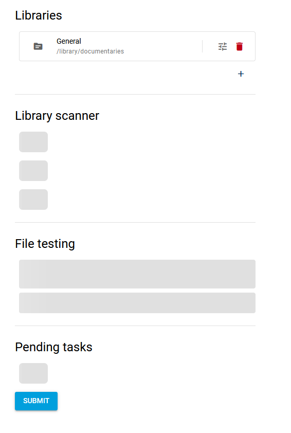

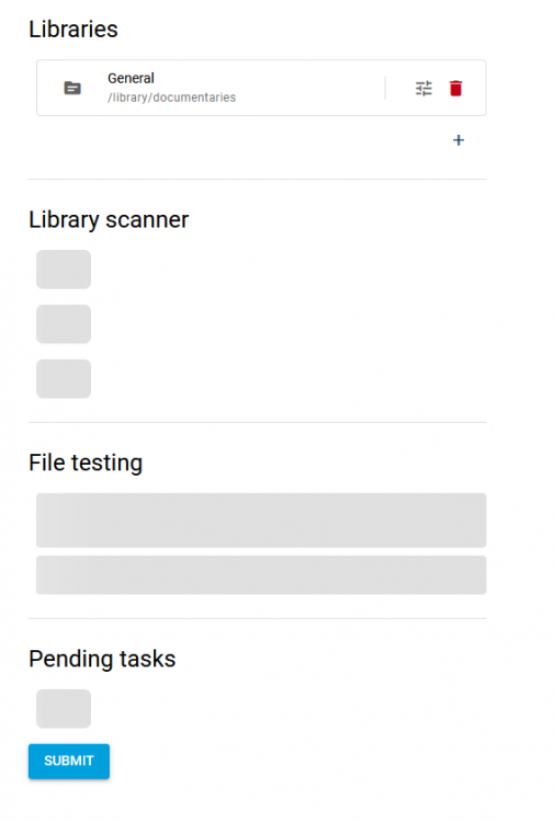

  8. Ah sure enough. I had a bunch of null keys in there. I moved it to a backup, restarted the docker, the settings.json recreated with the correct values and we're golden again. Thanks!
  9. On version 0.2.0~a3bd45a, and I'm getting the attached screenshot happening. Constantly trying to load the page sections with no success. Cross-browser. On hitting the Rescan Library button, I get "An error was encountered while requesting a library rescan". Nothing of relevance in the Unmanic logs themselves, but the docker log showed this: [services.d] starting services [services.d] done. 2022-03-12T21:51:23:INFO:Unmanic.UnmanicLogger - Debug logging enabled 2022-03-12T21:51:23:INFO:Unmanic.UnmanicLogger - Initialising file logger. All further logs should output to the 'unmanic.log' file Exception in thread LibraryScannerManager: Traceback (most recent call last): File "/usr/lib/python3.8/threading.py", line 932, in _bootstrap_inner self.run() File "/usr/local/lib/python3.8/dist-packages/unmanic/libs/libraryscanner.py", line 97, in run if int(self.settings.get_schedule_full_scan_minutes()) != self.interval: TypeError: int() argument must be a string, a bytes-like object or a number, not 'NoneType' Exception in thread LibraryScannerManager: Traceback (most recent call last): File "/usr/lib/python3.8/threading.py", line 932, in _bootstrap_inner self.run() File "/usr/local/lib/python3.8/dist-packages/unmanic/libs/libraryscanner.py", line 97, in run if int(self.settings.get_schedule_full_scan_minutes()) != self.interval: TypeError: int() argument must be a string, a bytes-like object or a number, not 'NoneType'
