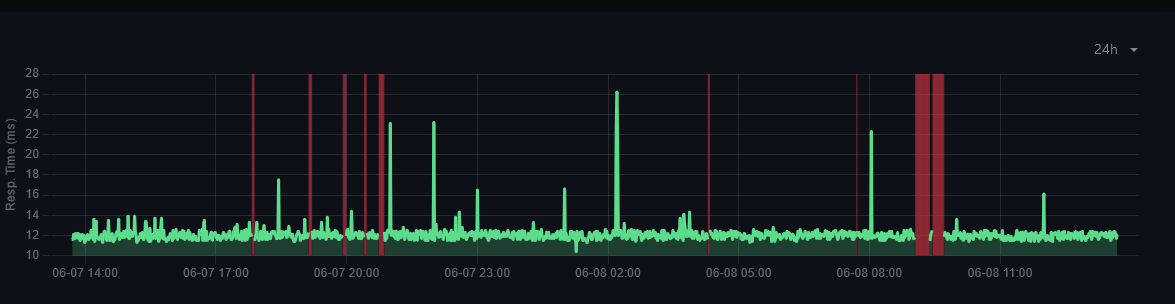

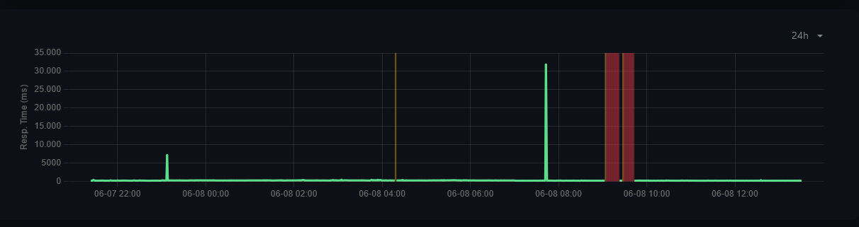

  7. Hello, I've been encountering a frustrating issue with my Unraid setup, specifically with my Docker containers losing internet connectivity on and off. It's been going on for a while now, and I'm hoping to get some insights and suggestions from the community here. The problem manifests as intermittent periods where the Docker containers completely lose internet access for several minutes to an hour or two. Afterwards, they regain connectivity as if nothing happened. It's quite puzzling, and I've attached the logs and files. Here are a couple of graphs depicting the pings using uptime kuma: one during a 24-hour period from an outside server pinging one of my services. Another from the instance inside the server over the course of a week while experiencing the issue within my system. The only things losing connection are the internet services, the internal ips have a 100% uptime. Now, I'm reaching out to you all for any ideas or troubleshooting tips you might have. What could be causing this problem? And how can I further investigate and resolve it? I've already gone through the usual troubleshooting steps, such as checking network configurations, verifying container settings, and ensuring that the issue is not specific to any particular container. However, I'm still unable to pinpoint the root cause. The system has been running fine for month up until a month or so. It's also worth pointing out that during these outages I don't lose internet connection in my home network. I also have the outside uptime kuma pointing to my domain and it has a 100% uptime. Thanks in advance for your assistance! ivpiter-diagnostics-20230608-1325.zip ivpiter-syslog-20230608-1125.zip

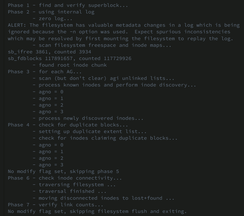

  12. I just updated my bios, which was few versions behind. I also added the line in my usb, and I also changed the usb because I was running out of ideas. I still have the same problem, but now when the system boots, it shows the nvme correctly and I am able to browse it. After a while, it shows this errors: blk_update_request: I/O error, dev nvme1n1, sector 151748736 op 0x1:(WRITE) flags 0x104000 phys_seg 18 prio class 0 followed by many more. What also is troubling is the fact that my docker files are in my other nvme, but even though docker starts, none works, they all through a read error. Thanks for the help! Edit: After the error the nvme is showing incorrect data, which was not on there initially. ivpiter-syslog-20220925-1029.zip ivpiter-diagnostics-20220924-1449.zip After a reboot I started the array in maintenance mode and did a xfs_test which resulted in:

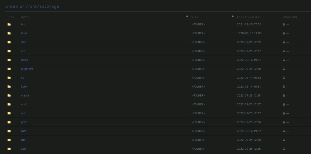

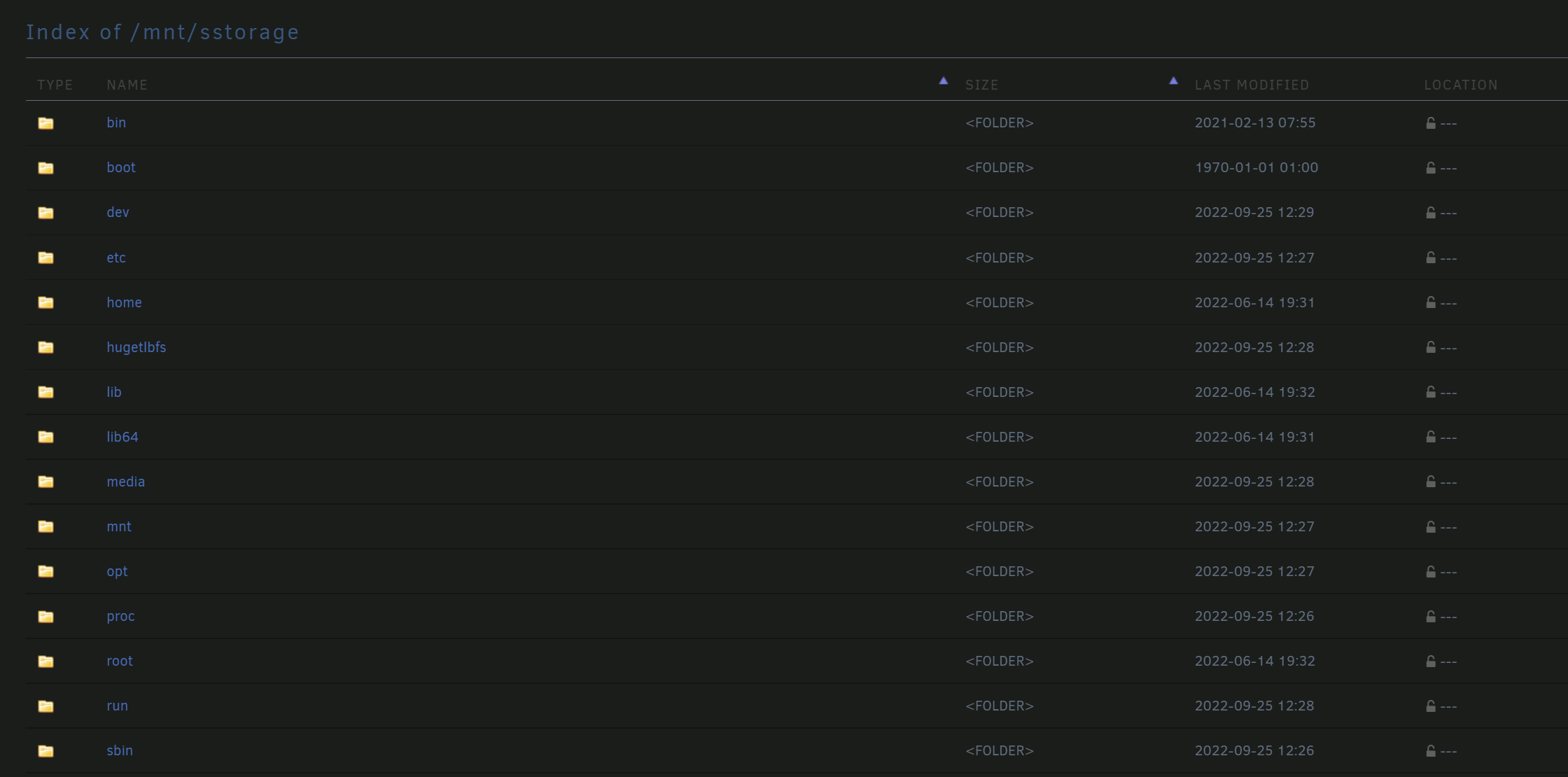

  14. Sorry I had a busy weekend. I know have both disks out of the array + a brand new 14tb drive (also in unassigned). The ncdu command of disk 2 is: and disk 4 is: Looks like disk 2 is good to go, but disk 4 has nearly everything on lost + found.
  15. Yes this is disk 4. Looking at the contents of this disk with UD it looks like everything is in lost + found. That means that if I create a new config I'll lose parity and then I'll have to copy everything from the lost+found folder from the disk itself. Right now I have emulated lost+found with exactly the same data right?
