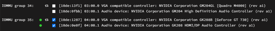

To hopefully wrap this up here then; I'm sure everyone has GPU passed thru to their VM. The Nvidia Driver plugin says dont install it if you pass thru GPU to VM. So how do I do it? Download the plugin anyway? VM and Unmatic should still work or no?
What they mean by don't install the drivers if you are using VM passthrough, is that it will not help. If you passthrough your GPU to a VM, you CANNOT use your GPU with any Docker containers.
If you need both, you will need to have two GPU's installed in your unRAID server. This is a hardware limitation and has nothing to do with unRAID on any of the app developers.
I have an inexpensive GPU for my WIndows 10 VM and a better GPU for my transcoding. So, one is passed through and the other is used in two Docker containers.
Note: If you do have two and one of them is passed through, only the GPU that is not passed through will appear in your Nvidia drivers list as you can see from my screenshots.

Seems like you pretty much have to have 2 GPUs to use Unmatic then; assuming, most people using Unraid pass through their GPU to VM. Otherwise what you said, makes perfect sense. Thank you for explaining that.
I was looking for alternatives to get this going.
- Either install a 2nd GPU,
- Or Maybe I can host Unraid on another computer (with another GPU) and encode all videos remotely; unless I can use a windows desktop and this?
Thank you
or using their intel igpu for unraid transcodings instead ... plex, unmanic, ... probably most common
you could also use unmanic with nvidia while your VM is turned off as note, but that needs a system (hardware) which can handle it
- no need to bind GPU in vfio bind and VM is starting, stopping properly (so unraid can run really headless, not always working)
- time what you do, your system can crash while starting a vm while a docker is using the needed GPU or vice versa
What you can do is stop the Unmanic container prior to launching your VM and vice versa — stopping your VM prior to launching Unmanic. This way you don't crash anything. If you pause Unmanic during an encoding process and then launch your VM, the GPU may not be released to the VM resulting in issues.
Like @Josh.5 said, you don't have to passthrough your GPU to Unmanic; Unmanic can still encode using CPU.
@Eddie Seelke It is possible to run a single GPU in Unraid and also pass it through to your VM. You would have to pull the firmware from the GPU card and then load it into your VM. I had very limited success with it a few year ago with a GTX 1060. In the end, I spung for a cheap GT 710 to make Unraid happy even as a headless server.

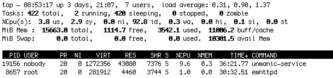

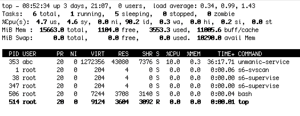

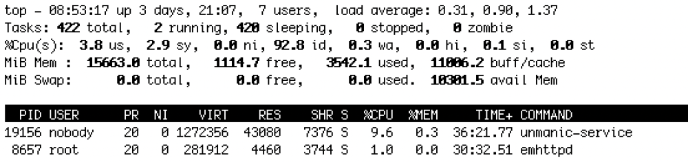

Is persistent load from the unmanic-service process expected?
Pausing workers (which were already inactive) and disabling file monitors didn't affect it, and there are no entries in the log (even with debug enabled) indicating activity.
top within the container:
783633949_Screenshot2022-12-05at8_52_34AM.thumb.png.9891feca92ef90e1704b75f7e582731a.png
top in unraid:
917695839_Screenshot2022-12-05at8_53_16AM.thumb.png.53255399a6d6e6ebb2e3f93a760b554a.png

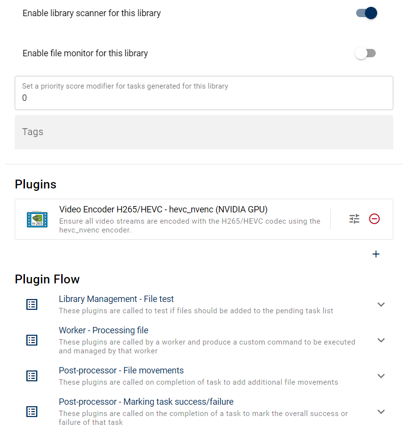

I am using Video Encoder H265/HEVC - hevc_nvenc (NVIDIA GPU)
Command is the following:
ffmpeg -hide_banner -loglevel info -i /library/tv/Star Trek - Discovery/Season 4/Star Trek - Discovery - S04E12 - Species Ten-C.mkv -strict -2 -max_muxing_queue_size 2048 -threads 4 -map 0:v:0 -map 0:a:0 -map 0:s:0 -map 0:s:1 -map 0:s:2 -map 0:s:3 -map 0:s:4 -map 0:s:5 -map 0:s:6 -map 0:s:7 -map 0:s:8 -map 0:s:9 -map 0:s:10 -map 0:s:11 -map 0:s:12 -c:v:0 hevc_nvenc -profile:v:0 main -preset medium -c:a:0 copy -c:s:0 copy -c:s:1 copy -c:s:2 copy -c:s:3 copy -c:s:4 copy -c:s:5 copy -c:s:6 copy -c:s:7 copy -c:s:8 copy -c:s:9 copy -c:s:10 copy -c:s:11 copy -c:s:12 copy -y /tmp/unmanic/unmanic_file_conversion-jotzv-1675293877/Star Trek - Discovery - S04E12 - Species Ten-C-jotzv-1675293877-WORKING-1-1.mkv
I think everything is working fine. I am assuming that if you compress, you lose bitrate, I am just wanting to try to see if I can get it a bit better. I do not mind some increased size if I can get rid of the black pixelization.

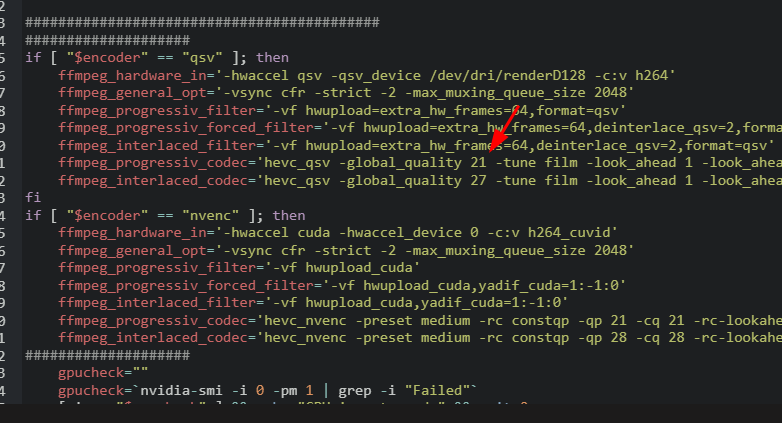

ok, so nvenc, my personal experience is also that nv is a little worse then intel vaapi / qsv

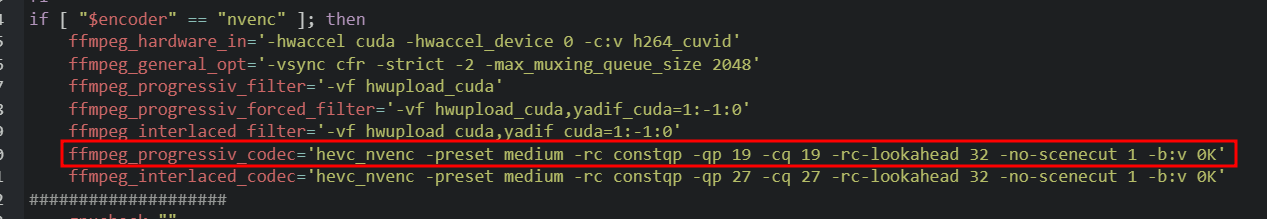

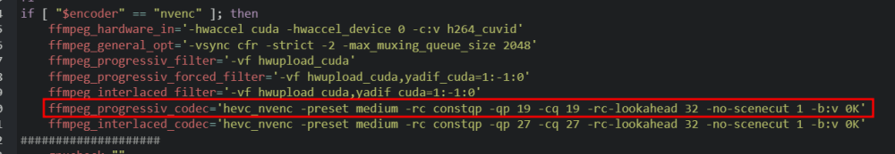

you are currently only using preset medium (3rd line here now, extracted from your lineup)
ffmpeg -hide_banner -loglevel info -i /library/tv/Star Trek - Discovery/Season 4/Star Trek - Discovery - S04E12 - Species Ten-C.mkv -strict -2 -max_muxing_queue_size 2048 -threads 4 \
-map 0:v:0 -map 0:a:0 -map 0:s:0 -map 0:s:1 -map 0:s:2 -map 0:s:3 -map 0:s:4 -map 0:s:5 -map 0:s:6 -map 0:s:7 -map 0:s:8 -map 0:s:9 -map 0:s:10 -map 0:s:11 -map 0:s:12 \
-c:v:0 hevc_nvenc -profile:v:0 main -preset medium \
-c:a:0 copy -c:s:0 copy -c:s:1 copy -c:s:2 copy -c:s:3 copy -c:s:4 copy -c:s:5 copy -c:s:6 copy -c:s:7 copy -c:s:8 copy -c:s:9 copy -c:s:10 copy -c:s:11 copy -c:s:12 copy \
how i get some better results with nvenc with some more settings
may take a look when you expand unmanic and see where to put what ...
rest, others may can give you some hints howto use nvenc best ... personally i switched back to qsv, slower but the results are slightly better here in my terms ...
here a speed comparision, 1st encode was nvenc, 2nd qsv, 3 min vs. 11 min ;)

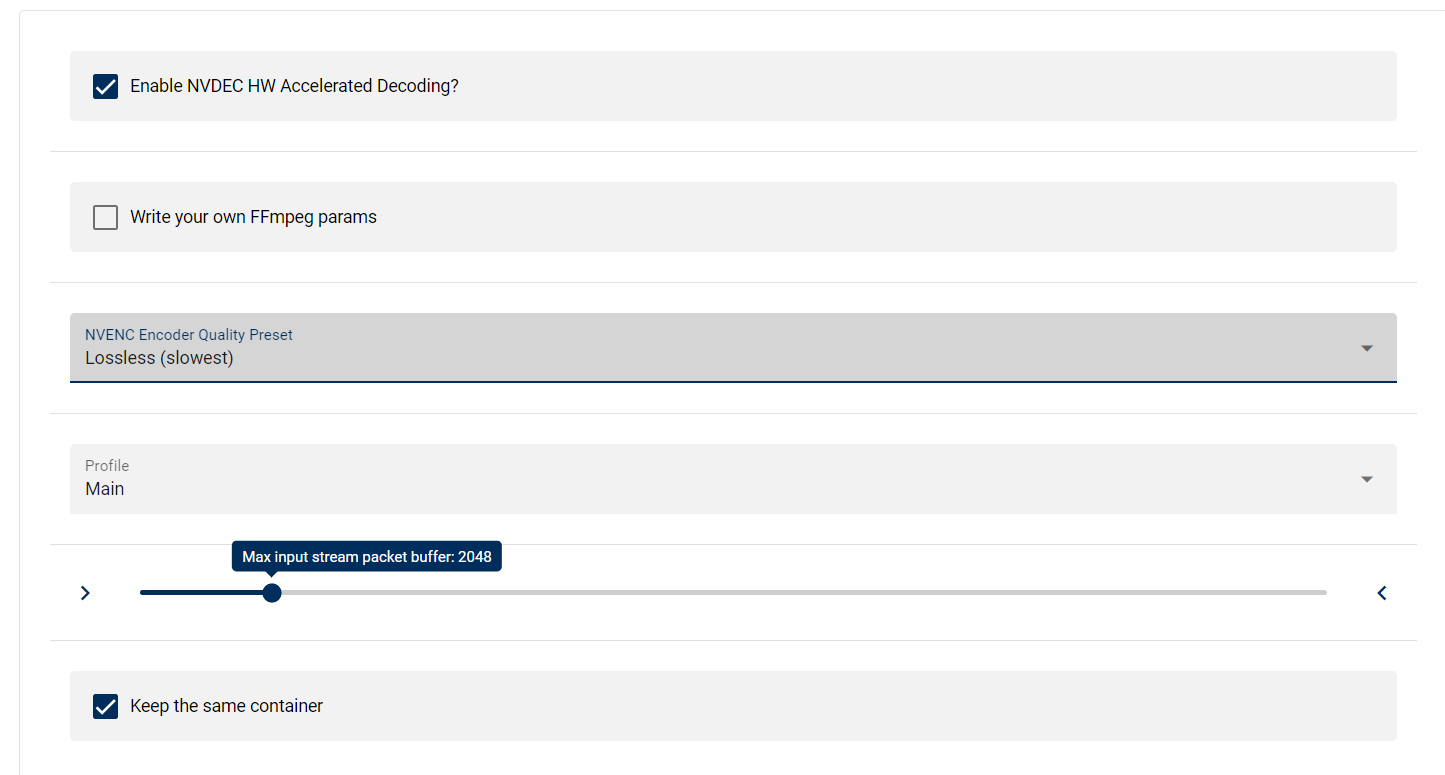

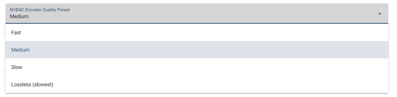

I had a h264 file which size was about 2 GB, after reencode to h265 it was about 25GB big. What's wrong?
These were my settings:
I have an Nvidia GPU RTX A2000.
I just wanna convert h264 into h265 without big quality loss.
Edited by enJOyIT
there is your reason ...
im pretty confident with 19 compared originnal h264 > hevc, on RTX i would go to ~ 17 and test some Videos and check yourself.
as lower as higher the quality, lossless ... is not the way to go ;)
Do I have to use my own parameters? Because there are only 4 options here:
May you can share your settings? That would be great 🙂
