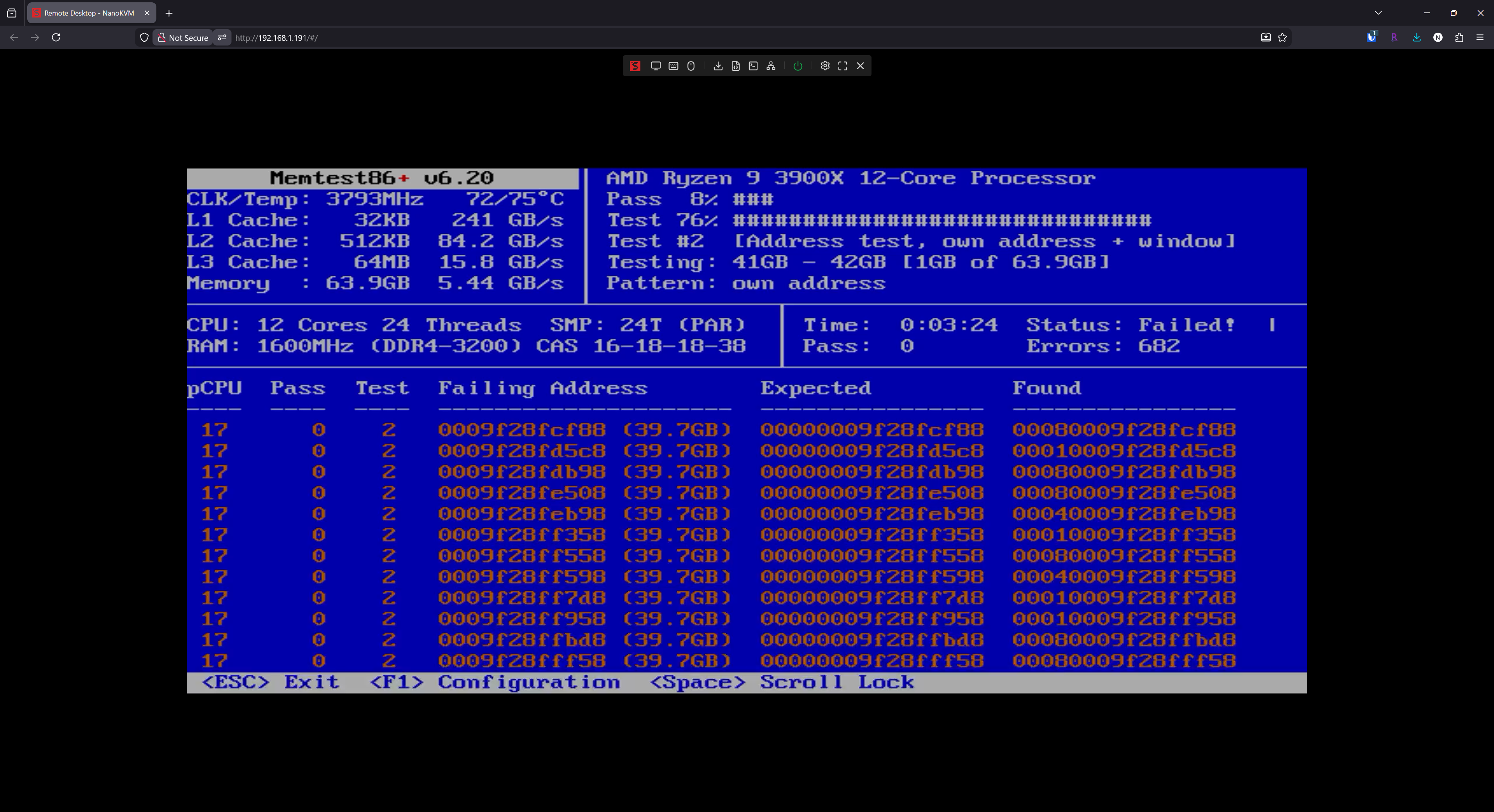

  3. So I swapped out my ram from my desktop and put those into my unraid server. It passed the memtest and everything seems stable up to now. Tested the old ram in a different system and it failed again. Luckily they are still under warranty so might be able to get them replaced.
  4. Just started it and this is what I'm seeing. Would it be worth it to try re-seating the ram given that I haven't touched it in the past 4-5 years? And that these problems started more recently.
  5. Thanks, I'll get started to running the memtest. Not the best time to be getting new ram if that's really the case...
