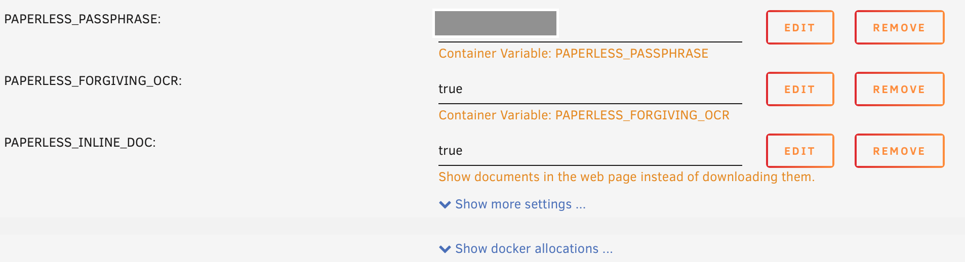

Hey TOa,
Thanks for the guide on getting this set up, I managed to get my system up and running last week after much frustration. However I still have an issue getting document_consumer to run on startup. From reading your guide, it sounds like you are saying that you need two instances of paperless, one specially for the consumer? is that correct?
Secondly I have configured a couple of extra variables for my docker container which others might find useful:
1282220993_Screenshot2020-01-10at22_01_17.thumb.png.314808ef2bc6eed92ebac04c7cf5ca1e.png
  • PAPERLESS_PASSPHRASE - To enable encryption on your files
  • PAPERLESS_FORGIVING_OCR - If for some reason, Paperless can't complete OCR'ing the document it will still consume it into the system. By default, Paperless will not consume the file.
  • PAPERLESS_INLINE_DOC - This allows you to view paperless documents in your web browser! By default, Paperless will trigger a download.
Thanks again!
