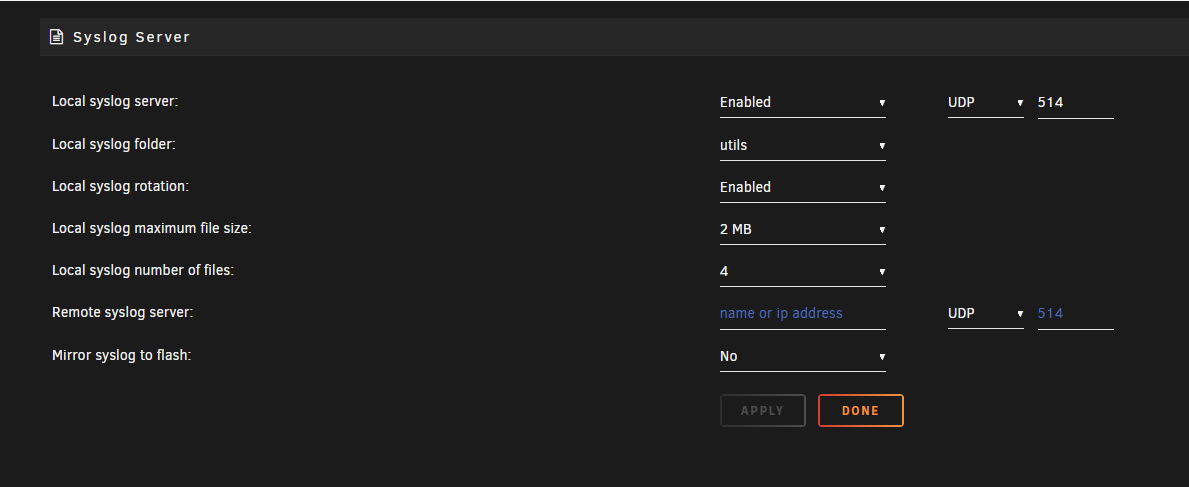

  14. k, I have set this to a share on my array. I don't see any files / folders created for syslog on this share.
