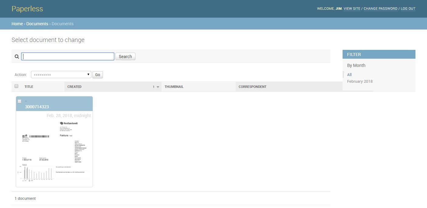

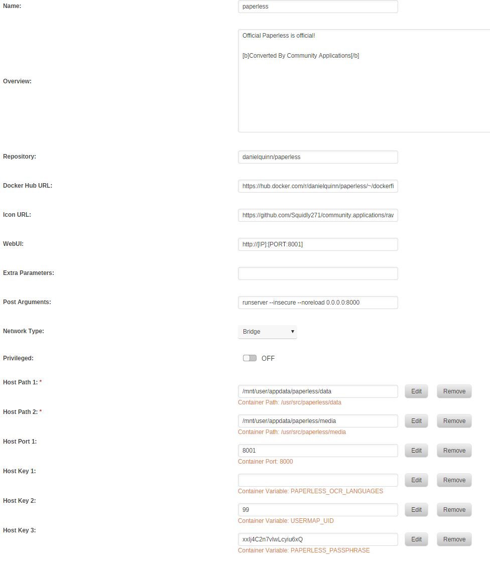

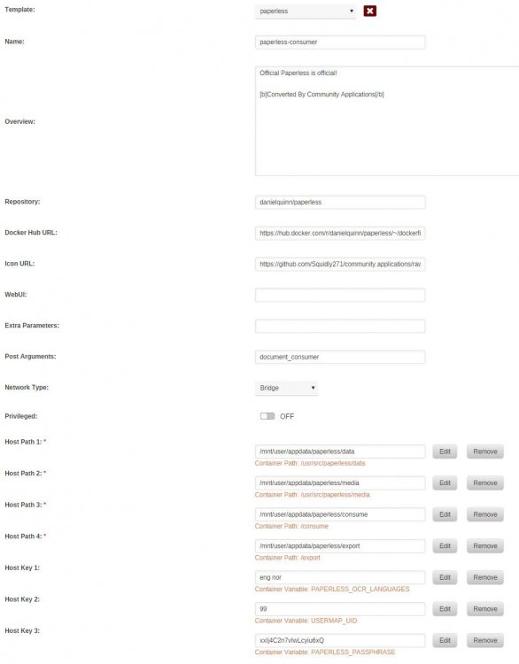

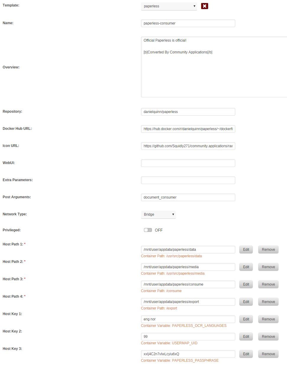

May 27, 20188 yr Decided to try to get this running. This is what I did: I first had a look at the dockerfilehttps://github.com/danielquinn/paperless/blob/master/docker-compose.yml.example It creates two services, the webserver and a consumer. Both using the same dockerfile but with some varying settingshttps://github.com/danielquinn/paperless/blob/master/Dockerfile Lets start with the webserver service Unraid - apps - search for paperless - search docker hub - select danielquinn/paperless Fill it out as follows: Change 8001 to whichever port you want to use (one that is available on your unraid server) And of course set some password instead of my (dummy) one I got the paths, port and environment variables from the docker compose file, which also referenced a separate env filehttps://github.com/danielquinn/paperless/blob/master/docker-compose.env.example I did not include the group id as on my first run this errored out because the unraid default group (100) already exists in the container. Which is unfortunate, but I won't bother with it atm. The reason we set up user id and group id for the docker containers is so the file permissions/ownerships stay "in sync" between unraid and the containers. It fired up! But I could not log in. I got stumped, I could not find a default login anywhere. After googling paperless default login I ended up here Quote 7. To be able to login, you will need a super user. To create it, execute the following command: $ docker-compose run --rm webserver createsuperuser https://github.com/danielquinn/paperless/blob/master/docs/setup.rst In order to run this "createsuperuser" command I recreated the container again, just to copy the command it uses. In order to recreate: click the paperless container in the Unraid Web Ui, dummy change some value (add a space and remove it again) and hit apply so the container is recreated. The reason for this is that we can hook on to that command and get an interactive shell, and by using the same command we get the same volume (folder) mounts. Which means our changes will hopefully be saved to our config folder and persist when recreating the container. We'll modify this command for our use. You could probably simplify this command by removing a lot of (possibly) unnecessary configs. But as it's a simple copy/paste with a couple of edits I chose to not clean it up as all it would really get me was possible error sources. docker run -d --name='paperless' --net='bridge' -e TZ="America/Los_Angeles" -e HOST_OS="unRAID" -e 'PAPERLESS_OCR_LANGUAGES'='' -e 'USERMAP_UID'='99' -e 'PAPERLESS_PASSPHRASE'='xxIj4C2n7vIwLcyiu6xQ' -p '8001:8000/tcp' -v '/mnt/user/appdata/paperless/data':'/usr/src/paperless/data':'rw' -v '/mnt/user/appdata/paperless/media':'/usr/src/paperless/media':'rw' -v '/mnt/user/appdata/paperless/consume':'/consume':'rw' -v '/mnt/user/appdata/paperless/export':'/export':'rw' 'danielquinn/paperless' runserver --insecure --noreload 0.0.0.0:8000 We need to remove the existing container first so we can create a new one when running our craetesuperuser command. Run this on the server: docker rm paperless Then I simply modified the command above for the container to be removed automatically as we don't want to save this container which tries to create a super user on start (--rm), changed it out to be interactive (-it) and I removed -d for daemon (background process) and changed the command from running the server to creating the super user. Run this on the server: docker run --rm -it --name='paperless' --net='bridge' -e TZ="America/Los_Angeles" -e HOST_OS="unRAID" -e 'PAPERLESS_OCR_LANGUAGES'='' -e 'USERMAP_UID'='99' -e 'PAPERLESS_PASSPHRASE'='xxIj4C2n7vIwLcyiu6xQ' -p '8001:8000/tcp' -v '/mnt/user/appdata/paperless/data':'/usr/src/paperless/data':'rw' -v '/mnt/user/appdata/paperless/media':'/usr/src/paperless/media':'rw' -v '/mnt/user/appdata/paperless/consume':'/consume':'rw' -v '/mnt/user/appdata/paperless/export':'/export':'rw' 'danielquinn/paperless' createsuperuser Enter username, email and password when prompted. You should be disconnected from the container afterwards. Then click the paperless container in the Unraid Web Ui again, dummy change some value (add a space and remove it again) and hit apply so our proper container is recreated. Paperless should now be running at http://tower:8001 (or whichever port you chose) --- But! It's not doing much since we don't yet have the consumer service running. So on to the next service, since it's basically the same docker container it should be simple (??) Go to http://tower/Docker/AddContainer Select the paperless template we just made (it should now be under user templates) Fill it out as follows: It's cruical you select the same passphrase here as in the other container You must also select a different name as you can't have two containers with the same name And lastly you should add the languages you want the OCR to use You should now have both paperless and paperless_consumer running. If you now try to copy a file over to the consume folder (I have it available over SMB/windows file share) and wait a few moments it should dissappear from the consume folder and magically pop up in the admin ui edit: fixed a typo -rm -> --rm Edited June 28, 20188 yr by JimL
May 30, 20188 yr Author On 5/27/2018 at 1:43 PM, JimL said: Decided to try to get this running. This is what I did: Holy crap! Wow! Thank you JimL!!! I'll give this a try as soon as I can! It's very much appreciated!
June 5, 20188 yr Author Thanks this worked perfectly! You had a single typo, it should be --rm instead of -rm. In case anyone else runs into issues. Hopefully updates to the container won't break it but I'm happy it's up and running. Thanks again.

January 3, 20197 yr speedyg213, I tried doing it the way you mentioned to do it, but it ended up not being able to update. (unraid would complain about how it was installed.) ended up doing a mix of what you and CrashBrn did. I ran your first command. I then went and created the docker manually through the webgui instead of doing your 2nd command. After that was done, I created a docker matching CrashBrn's 3rd screen shot. Everything worked well after that! Just thought I'd throw this out there for those that ran into the same issue I had. Thank you both Speedyg213 and CrashBrn! I can finally run this correctly on my unraid server instead of running it on a stand alone esxi client! And that makes not only me but my electric bill thank you two!

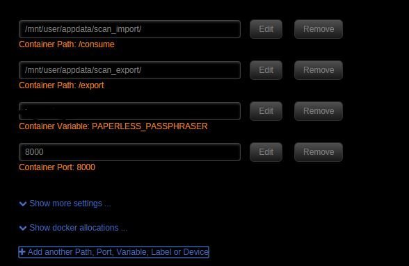

January 4, 20206 yr With the information from this thread I successfully installed paperless today on my unRaid server. Thanks to @speedyg213 for the wrap-up. Let me briefly summarize the steps to install paperless with the new paperless CA template from 9th Nov 2019. I decided to use NFS mounts also for the consumer folder. So I had to adapt the commands slightly: 1. Create a NFS share with subfolder (e.g. media/ consume/ and data/) 2. Install paperless as web server from CA 2.1. Configure the NFS mounts for media/ consume/ and data/ created in step 1 2.2 Define PAPERLESS_OCR_LANGUAGES (in my case: "eng deu") 3. Login to the paperless container via the unRaid web-interface and issue the following command: "./manage.py createsuperuser". Follow the instructions to create the paperless user 4. Install paperless as consumer service in order to process documents in your /consume folder 4.1 Go to the docker UI, click add container and select the paperless template 4.2 Rename the container to "paperless-consumer" 4.3 Remove the port 4.4 Change the parameter "postargument" to "document_consumer --no-inotify --loop-time 60". This will start the consumer service with a 60 seconds time loop. It also disables the inotify feature, which does not work with consumer/ folders represented as NFS shares. Now you should be also to place a document in your /consume folder of your NFS share and recognize it being imported to paperless. Have a nice weekend everybody! Questions are welcome. ----- Edit ---- I also want to share my scanning workflow with Paperless and Nextcloud with you guys (See https://blog.kilian.io/paperless/ as reference). With the app ScannerPro, I can upload my scanned files to a Nextcloud folder via WebDav. This folder functions as paperless consume folder and grabs the files and imports them to paperless. Following steps required for the setup: 1. Mount the paperless /consume folder in the Nextcloud docker container via unRaids Docker template editor 2. Enable the external storage app as Nextcloud admin. The app can be found in the apps dropdown hidden in disabled apps. 3. Add the mounted consume/ folder as local storage for your Nextcloud user with name paperless-consume (Settings -> External Storage) 4. Configure the Nextcloud paperless-consume folder as WebDav target in your scan app Quote An added bonus is that the Nextcloud desktop client also syncs the consume directory to my computer, so I also have a directory there where I can drop PDF files to be added to paperless (https://blog.kilian.io/paperless/) Edited January 4, 20206 yr by T0a
