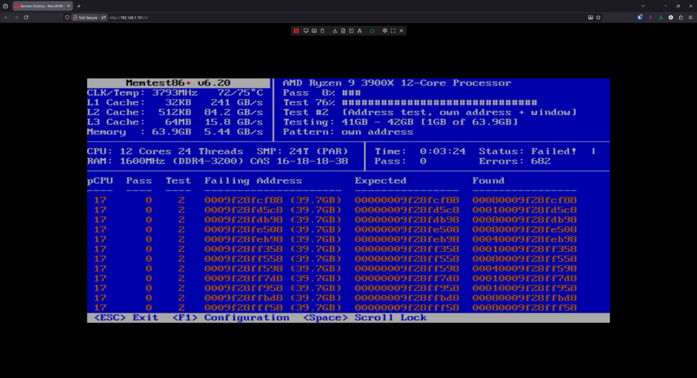

Just started it and this is what I'm seeing.
Would it be worth it to try re-seating the ram given that I haven't touched it in the past 4-5 years? And that these problems started more recently.
It's worth a try, but run a long test after, since typically this means the RAM failed.
Your DRAM is clocked way too fast.
Refer the the FAQ that JorgeB referred to earlier.

So I swapped out my ram from my desktop and put those into my unraid server. It passed the memtest and everything seems stable up to now.
Tested the old ram in a different system and it failed again. Luckily they are still under warranty so might be able to get them replaced.
