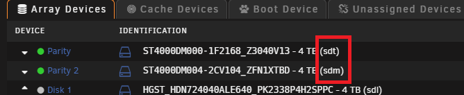

October 31, 20187 yr Reformat a SAS HDD to different block sizes mainly 512 to use in UNRAID This took me a few hours to find and work out but was so much needed OK so I have just now done this for myself by installing sg3_utils onto my UNRAID OS using installpkg all using terminal 1. download the package into a tmp dir # wget http://slackware.cs.utah.edu/pub/slackware/slackware64-14.1/slackware64/l/sg3_utils-1.36-x86_64-1.txz 2. run this from that tmp dir after the download to install sg3_utils # upgradepkg --install-new sg3_utils-1.36-x86_64-1.txz 3. use this command to show SAS HDD's # sg_scan -i 4. this command to format 'obviously /dev/XXX should be the HDD u wish to format MAKE SURE ITS THE RIGHT ONE! # sg_format --format --size=512 -v /dev/XXX this has been allowing me to reformat the block size and use previously non usable drives saving buttonnes of money WARNING this format will destroy a HDD if interrupted during this process if you can a UPS is recommended have a great day I love UNRAID! Edited October 31, 20187 yr by SundarNET bad grammar + guide update/change

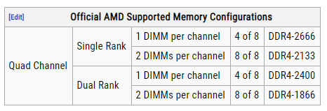

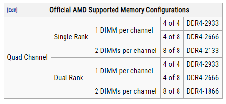

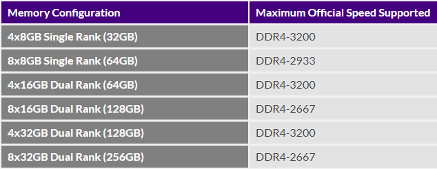

February 4, 20206 yr Community Expert What can I do to keep my Ryzen based server from crashing/locking up with Unraid? Ryzen on Linux can lock up due to issues with c-states, and while this should mostly affect 1st gen Ryzen, there are reports that 2nd and even 3rd gen can be affected in some cases, make sure bios is up-to-date, then look for "Power Supply Idle Control" (or similar) and set it to "typical current idle" (or similar). If there's no such setting in the BIOS try instead to disable C-States globally, also note that there have been some reports that with some boards the setting above is not enough and only completely disabling C-States brings stability. NEW: If you are having random reboots with Ryzen 5000 series, particularly the higher-end models of 5950X and 5900X, it may help to increase the CPU voltage supply, see: https://wiki.archlinux.org/title/Ryzen#Random_reboots Also, many of those servers seem to be running overclocked RAM, this is known to cause stability issues and even data corruption on some Ryzen/Threadripper systems, even if no errors are detected during memtest, server and overclock don't go well together, respect max RAM speed according to config and CPU listed on the tables below. Note: Ryzen based APUs don't follow the same generation convention compared to regular desktop CPUs and are generally one generation behind, so for example Ryzen 3200G is a 2nd Gen CPU: 1st gen Ryzen: 2nd gen Ryzen: 3rd gen (3xxx) and Zen3 (5xxx) Ryzen : Zen4 (7xxx) Ryzen CPUs: Threadripper 1st Gen: Threadripper 2nd Gen: Threadripper 3rd Gen:

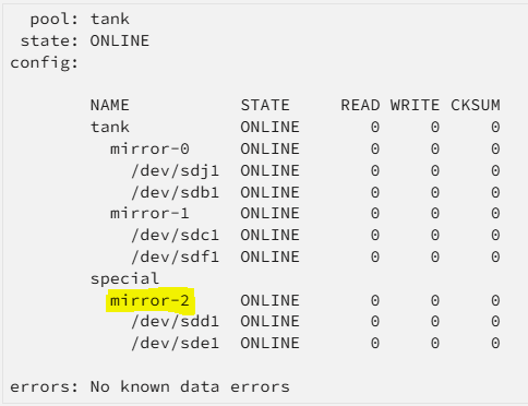

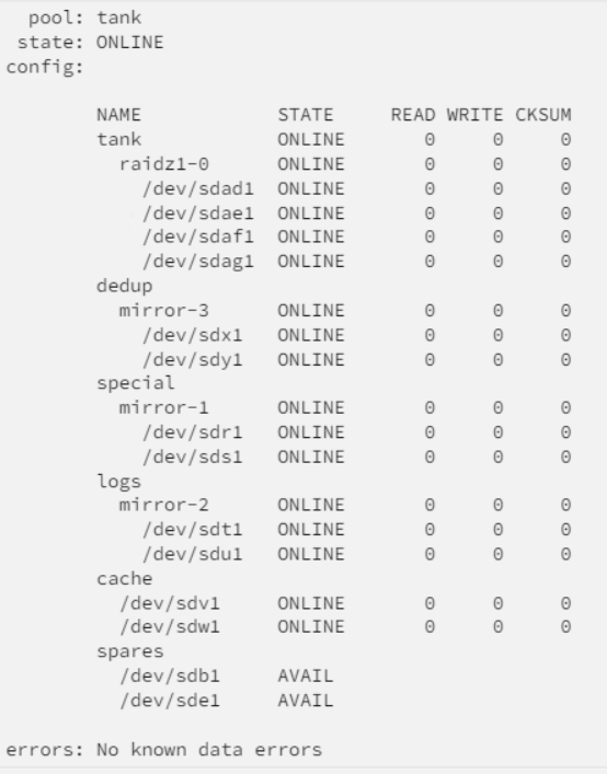

January 16, 20251 yr Community Expert How can I remove a subpool from a zfs pool using Unraid v7.0? Unraid 7.0 now allows users to add zfs subpools, except a spare subpool, which is not implemented yet, but removing a subpool, even when supported by zfs, is also not implemented for now, but it can be done using the CLI. Please note that if the main pool is raidz, special and dedup subpools cannot be removed, this is a zfs limitation. Example #1: user added an L2ARC subpool to a zfs pool, but changed his mind and wants to remove it, with the array running check the pool layout: Still with the array running, open a terminal window and type: zpool remove <pool_name> <device(s)> So in this example, it would be: zpool remove tank sdd1 sde1 P.S. you can also remove just one device from a cache/logs striped subpool, if you want to leave the other one. After the command completes, refresh the GUI to confirm the device(s) were removed: Now the final step is to reimport the pool without that subpool (never restart the array without reimporting the pool first so that the GUI is in sync with the new pool layout, or unpredictable things can happen), to do that: stop the arrayon main, click on the first device for that pool and then "remove pool"back on main, create a new pool with the same name and the new number of slotsassign the remaining pool device(s), it can be in any order, they will be sorted at array startleave the filesystem set to autostart the array to import the pool Example #2: to remove a mirrored special/dedup/logs subpool it's a little different, you must use the mirror #, e.g.: zpool remove tank mirror-2 After the command completes, refresh the GUI to confirm the devices were removed: Now the final step is to reimport the pool without that subpool, to do that: stop the arrayon main, click on the first device for that pool and then "remove pool"back on main, create a new pool with the same name and the new number of slotsassign the remaining pool device(s), it can be in any order, they will be sorted at array startleave the filesystem set to autostart the array to import the pool

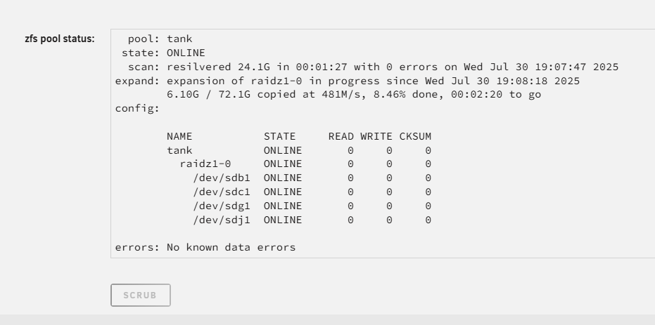

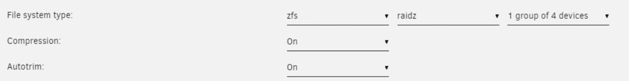

March 17, 20251 yr Community Expert How can I expand a ZFS RAID-Z pool? Since OpenZFS 2.3.0, RAID-Z expansion is supported by ZFS, so it can be done with Unraid 7.1+, and as of 7.2.0-beta.1, you can use the GUI to expand single vdev RAID-Z pools, mutliple vdev pools can only be expanded using the CLI for now, more info below. A few general notes:If the pool was created before 7.1.0, it must be upgraded first to support RAID-Z expansion, click the first pool device and then "UPGRADE POOL"Data redundancy is maintained during and after the expansion. If a disk fails while the expansion is in progress, the expansion pauses until the health of the RAID-Z vdev is restored (e.g. by replacing the failed disk and waiting for reconstruction to complete). Expansion does not change the number of failures that can be tolerated without data loss (e.g. a RAID-Z2 is still a RAID-Z2 even after expansion).A RAID-Z vdev can be expanded multiple times, but only by one device at a timeAfter the expansion completes, old blocks retain their old data-to-parity ratio, you would need to re-write all the existing data for it to start using the new data-to-parity ratio, any new data will use of course it.The vdev's assumed parity ratio does not change, so slightly less space than is expected may be reported for newly written blocks, according to zfs list, df, ls -s, and similar tools, including the Unraid GUI. (This is not very noticeable if say you expand from 8 to 9 devices, but for example, if you start with a 4 x 10TB RAID-Z2 vdev, with an approximate capacity of 20TBs, and then expand it with 4 more 10TB devices, you will see in the end the pool capacity reported at approximately 40TB, instead of the expected 60TB, though all space can still be used, just the used/free space stats will be wrong, this is a ZFS issue/bug, it may or not be fixed in the future)As of 7.2.0, only single vdev pools can be expanded using the GUI, you can still expand multiple vdev pools if you are comfortable using the CLI as described below, but since Unraid does not support mixed width vdevs, you would need to expand all the vdevs first and only then reimport the pool using the GUI.How to expand single vdev pools with 7.2.0-beta.1 or newer:Stop the arrayAdd one slot to the poolAssign the new device (must be at least as large as the smallest drive in the pool)Start the arrayThe RAID-Z expansion will begin, when that's done, an automatic scrub will start. You can follow the progress by clicking on the first pool device and scrolling down to the zpool status section:How to expand multiple vdev RAID-Z pools with 7.1.0 or newer using the CLI:Preformat the new device you are adding with the UD plugin, this is mostly to create a standard partition on the device, you can format with any filesystem, and don't use zfs with the same pool name, recommend using XFS or btrfs since they are typically quicker.Then, and with the array running, expand the first vdev by typing:zpool attach -f <pool name> <vdev> /dev/sdX1or for NVMe deviceszpool attach -f <pool name> <vdev> /dev/nvmeXn1p1 Note the 1 and p1 at the end of the devices to specify the partition, e.g.: zpool attach -f cache raidz1-0 /dev/sdl1 Check expansion progress using the GUI by clicking on the first pool device or with:zpool status <pool name>This can take a long time, depending on the current pool usage, and devices' speed, after the expansion is done, a scrub will automatically start, when that finishes, repeat the same to expand the other vdev(s), when all vdevs are expanded, i.e., they all have the same number of devices, you need to reimport the pool with Unraid and the new devices (never restart the array without reimporting the pool first so that the GUI is in sync with the new pool layout, or unpredictable things can happen), for that: stop the arrayon main, click on the first device for that pool and then "remove pool"back on main, create a new pool with the same name and new number of slotsassign all the pool devices, including the new ones, leave the filesystem set to autostart the array to import the pool P.S. you can also reimport the pool before the expansion is complete, as long as all the vdevs have the same number of devices, just stop the array at any time after attaching the new device, re-import the pool using the same steps described above, and the expansion will resume after array start. P.P.S. if a pool device fails or gets faulted during the expansion, make sure you import the pool degraded with all current devices, including the new device being used to expand the pool, before attempting to replace the faulted device using the GUI, don't try to replace a device with the GUI not reflecting all the current pool members or weird things can happen, alternatively do the replacement using the CLI and then only reimport the pool once redundancy has been restored, any doubts, please create a new thread in the general support forum and feel free to tag me.
