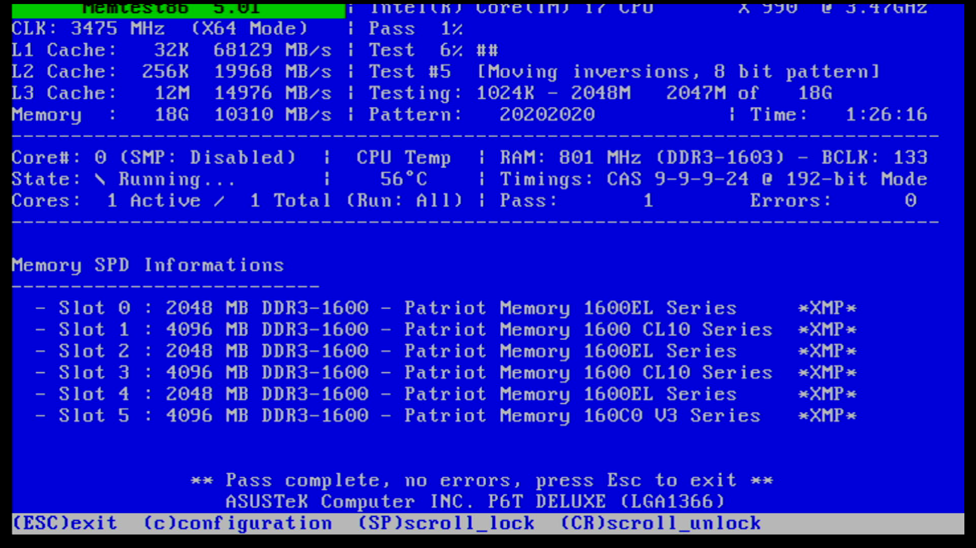

  11. Memory checked fine (as I suspected it would). The errors are the flakey connection to my external drive enclosure over eSATA I believe.
