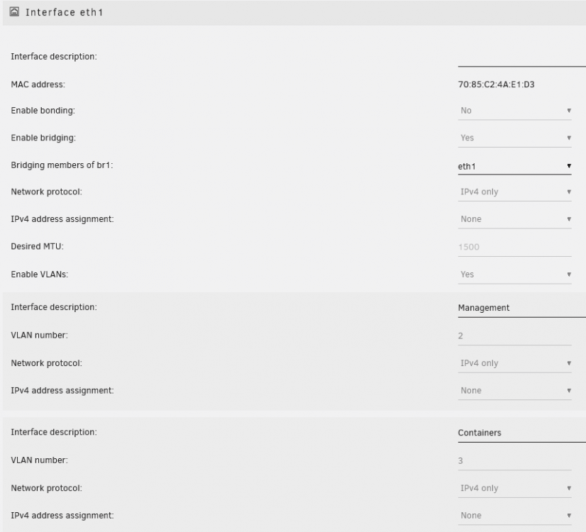

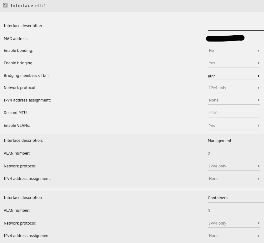

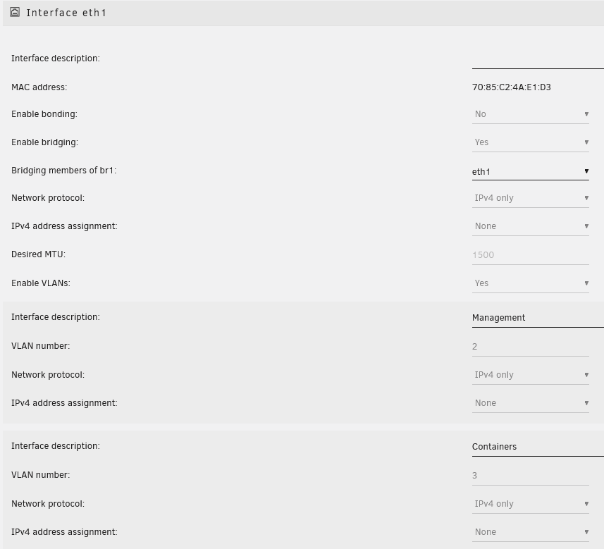

  7. What are you using to reach the the container over IPV6? Unraid cannot reach anything on br0, as 6.9.2 macvlan system used by docker expressly prohibits the host and container communication over the "shared" interface. Also, does your LAN ipv6 have the same /64 prefix as the container? In my case I don't use static assignments, just SLAAC, which gives me fairly static IPV6 address since the container MAC address is defined by the static IPv4 assigned to it. root@MediaStore:~# ip addr s dev br0 18: br0: <BROADCAST,MULTICAST,UP,LOWER_UP> mtu 1500 qdisc noqueue state UP group default qlen 1000 link/ether 70:85:c2:4a:e1:d1 brd ff:ff:ff:ff:ff:ff inet 192.168.2.5/24 scope global br0 valid_lft forever preferred_lft forever inet6 xxxx:xxxx:xxxx:xxxx:7285:c2ff:fe4a:e1d1/64 scope global dynamic mngtmpaddr noprefixroute valid_lft 3584sec preferred_lft 1784sec inet6 fd6f:3908:ee39:4001:7285:c2ff:fe4a:e1d1/64 scope global dynamic mngtmpaddr noprefixroute valid_lft 3584sec preferred_lft 1784sec inet6 fe80::7285:c2ff:fe4a:e1d1/64 scope link valid_lft forever preferred_lft forever root@MediaStore:~# docker exec nginx ip addr 1: lo: <LOOPBACK,UP,LOWER_UP> mtu 65536 qdisc noqueue state UNKNOWN qlen 1000 link/loopback 00:00:00:00:00:00 brd 00:00:00:00:00:00 inet 127.0.0.1/8 scope host lo valid_lft forever preferred_lft forever inet6 ::1/128 scope host valid_lft forever preferred_lft forever 2: tunl0@NONE: <NOARP> mtu 1480 qdisc noop state DOWN qlen 1000 link/ipip 0.0.0.0 brd 0.0.0.0 3: gre0@NONE: <NOARP> mtu 1476 qdisc noop state DOWN qlen 1000 link/gre 0.0.0.0 brd 0.0.0.0 4: gretap0@NONE: <BROADCAST,MULTICAST> mtu 1476 qdisc noop state DOWN qlen 1000 link/ether 00:00:00:00:00:00 brd ff:ff:ff:ff:ff:ff 5: erspan0@NONE: <BROADCAST,MULTICAST> mtu 1464 qdisc noop state DOWN qlen 1000 link/ether 00:00:00:00:00:00 brd ff:ff:ff:ff:ff:ff 6: ip_vti0@NONE: <NOARP> mtu 1480 qdisc noop state DOWN qlen 1000 link/ipip 0.0.0.0 brd 0.0.0.0 7: sit0@NONE: <NOARP> mtu 1480 qdisc noop state DOWN qlen 1000 link/sit 0.0.0.0 brd 0.0.0.0 215: eth0@if33: <BROADCAST,MULTICAST,UP,LOWER_UP,M-DOWN> mtu 1500 qdisc noqueue state UP link/ether 02:42:c0:a8:5f:0a brd ff:ff:ff:ff:ff:ff inet 192.168.95.10/24 brd 192.168.95.255 scope global eth0 valid_lft forever preferred_lft forever inet6 fd6f:3908:ee39:4002:42:c0ff:fea8:5f0a/64 scope global dynamic flags 100 valid_lft 3435sec preferred_lft 1635sec inet6 xxxx:xxxx:xxxx:xxxx:42:c0ff:fea8:5f0a/64 scope global dynamic flags 100 valid_lft 3435sec preferred_lft 1635sec inet6 fe80::42:c0ff:fea8:5f0a/64 scope link valid_lft forever preferred_lft forever My containers are connected to a different VLAN, hence the /64 is not quite the same. But I have local-only IPV6 prefix for my LAN for intersite VPN traffic, and the fact that my ISP gives out a dynamic IPV6 prefix the dynamic ipv6 prefix makes it hard to run docker with network settings defined, thus making me use SLAAC more efficiently - it doesn't help that my router is a Maikrotik, which has other issues with IPV6 networks (lack of proper DHCPv6)
