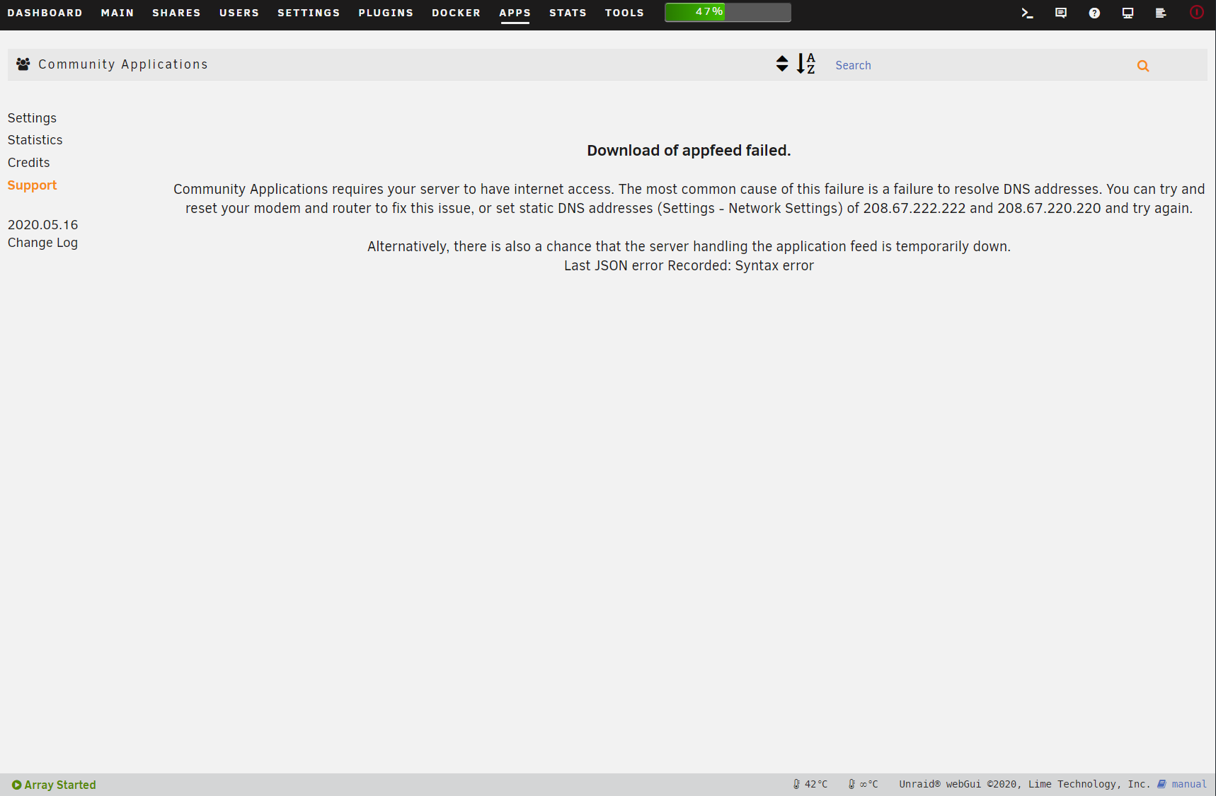

i just got a pfsense router and now the apps tab doesnt load
You've got network problems / pfSense is blocking unRaid from reaching GitHub and the backup server.
would you know how to unblock it in pfsense
Sorry, no.  If you can't get anywhere with either your network settings or pfSense, then open a new thread in general support and include your diagnostics
I got it. One of your old posts actually 8 had to change the default gateway to 192.168.1.1
