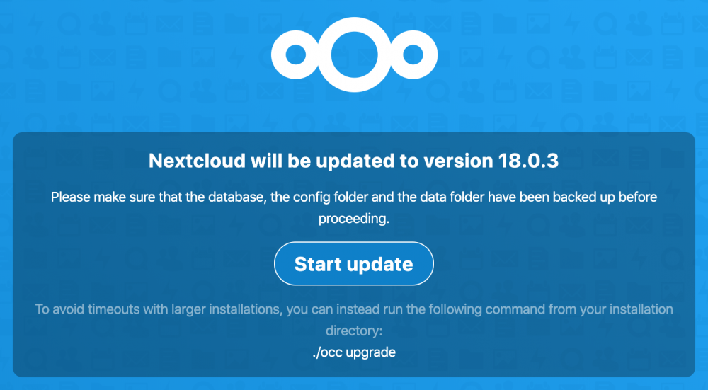

I am trying to update nextcloud through the web after updating the container and i am getting this error. I dont have any data in nextcloud right now as i am making sure the fresh install is good before i place all the data back. @knex666 Do you happen to know what command i can use on this docker? Thanks in advance and hope everyone is staying safe.
I am at 18.01 and tried to get to 18.03 but it will not pull the update since I'm a version behind.
that stinks  I will have to manually download it and step upgrade
Hi together,
I dont think so. I used to install all updates by changing to repository version.
I now changed it to nextcloud/apache:latest but you can go like this
choose nextcloud/apache:18.0.2 and apply then change to latest and click apply.
you should not update via the webapp.
Edit: nextcloud:latest or 18.0.3-apache
but I got stucked starting the container. I restarted the container and for the first time I saw the update screen.
I applyed and it failed but works. I am cunfused...
Cheers
Edited by knex666
26 minutes ago, knex666 said:
Hi together,
Cheers
How would you update then?
By setting the repository to the version nextcloud:18.0.3-apache.
But from 18.0.2 to 0.3 I got some errors but it worked.
Cheers

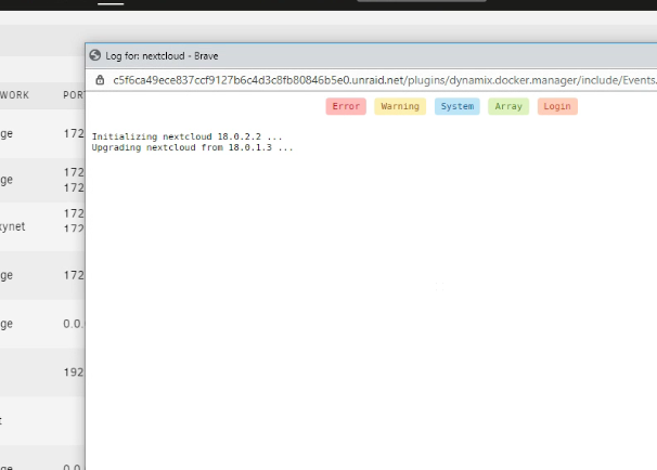

1 hour ago, knex666 said:
Hi together,
Cheers
I went ahead an changed the repository and it pulled the data., started the container and i looked in the log and it looks like upgrading the instance.
came up no issues
trying 18.03
7 minutes ago, ijuarez said:
came up no issues
trying 18.03
up to 18.03
no issues
