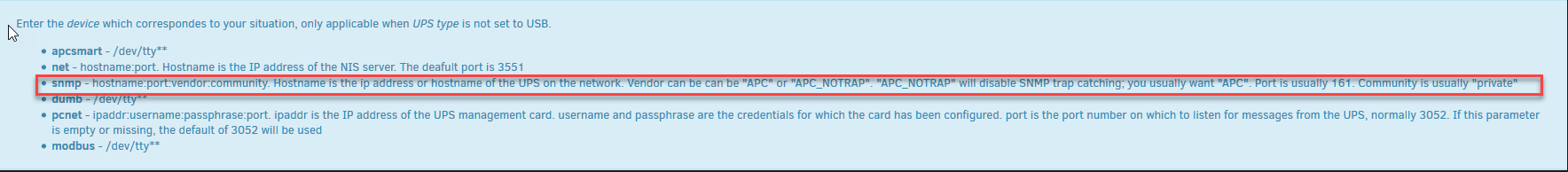

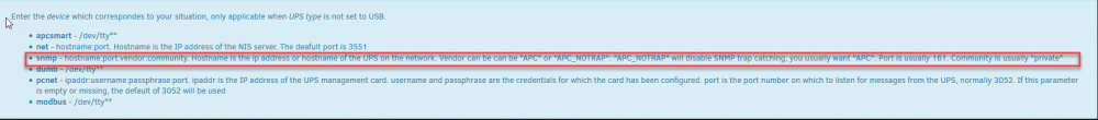

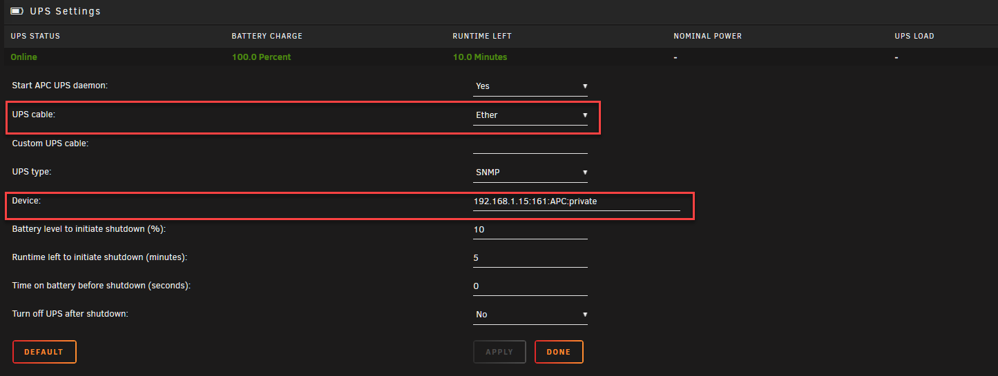

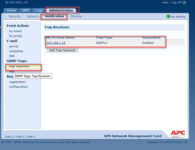

  10. I know this is an old topic, but it came up when I was searching and attempting to figure out what I needed to do to setup my APC and Unraid server. I have an APC SmartUps 1000 RM with NMC. I to had failed numerous times and configurations. It wasn't until I setup a trap itself before everything started working. After the trap was configured, I was able to use the default settings that were identified in the Unraid settings screen: After plugging the settings in as described in the SMTP help screen, it connected without issue: I hope this helps the next person because reading through this didn't seem to provide any details that I could find on how to set this up.
