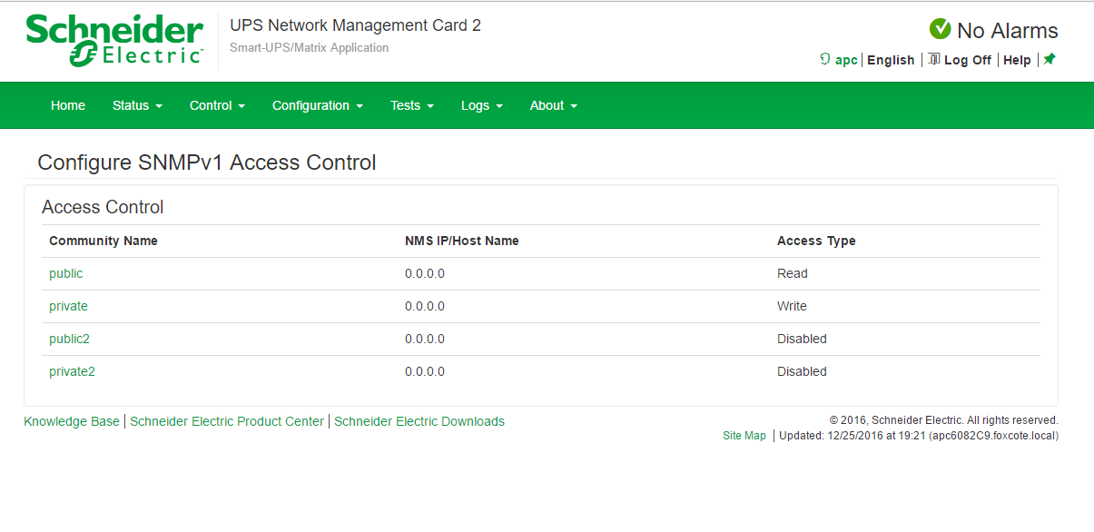

Ok I found something under Network settings within called Configure SNMPv3 User Profiles, so i setup a user and passphrase, and enabled the access control using the server's IP address...
Still not working... feeling I'm getting closer though!!
Have tried enabling/configuring SNMPv1 & v3... grrr.... has anyone done this?

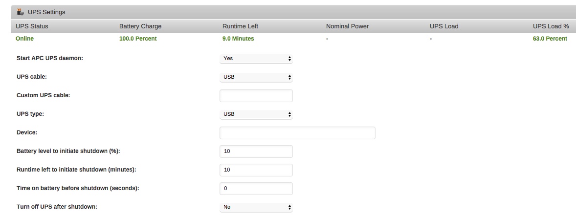

I have an older Smart UPS 1000 UPS connected to one of my unraid server via  USB cable, here is a screen shot of my settings, maybe they will work for you. Its possible in trying to get your network card to work you changed a lot of default settings.

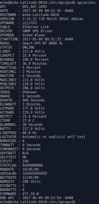

I used a Smart-UPS RT 8000 XL with AP9619 management card for this.  My web UI login is apc/apc, and my management card is configured to use 192.168.100.3.

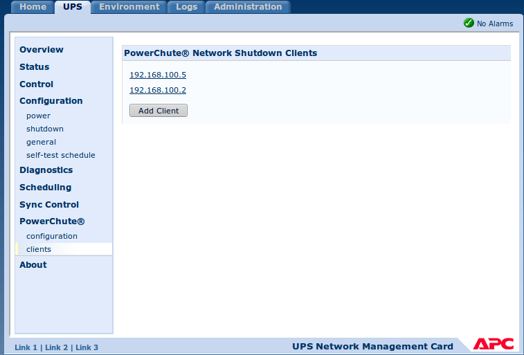

APC Web GUI:

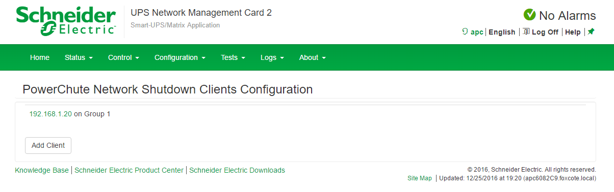

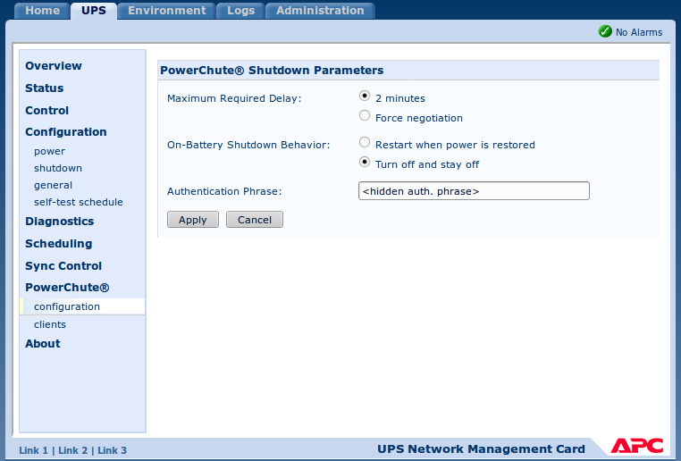

  • Go to UPS tab at top followed by Powerchute, configuration, then update the authentication phrase.  I used 'passphrase' for this example. (passphrase.png)
  • Go to UPS tab at top followed by Powerchute, clients, add unRAID IP as client. (clients.png)

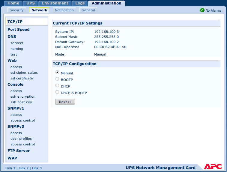

  • Go to Administration tab at top, go to Network sub-tab, verify TCP/IP settings match your network, specifically the default gateway and subnet.  I have manual config vs DHCP. (network.png)
unRAID UPS config or edit the apcupsd.conf located in /etc/apcupsd using telnet/SSH/console:
SNMP Config: (snmp.png)
  • UPSCABLE ether
  • UPSTYPE snmp
  • DEVICE 192.168.100.3:161:APC:private
The 'APC:private' are defaults and will be exactly that regardless of your passphrase or login credentials.  161 is the default port.

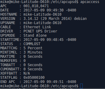

PCnet Config: (pcnet.png)
  • UPSCABLE ether
  • UPSTYPE pcnet
  • DEVICE 192.168.100.3:apc:passphrase
  • Restart apcupsd by issuing /etc/rc.d/rc.apcupsd restart  (or 'stop' followed by 'start')
  • Issue 'apcaccess' command or view in unRAID GUI.

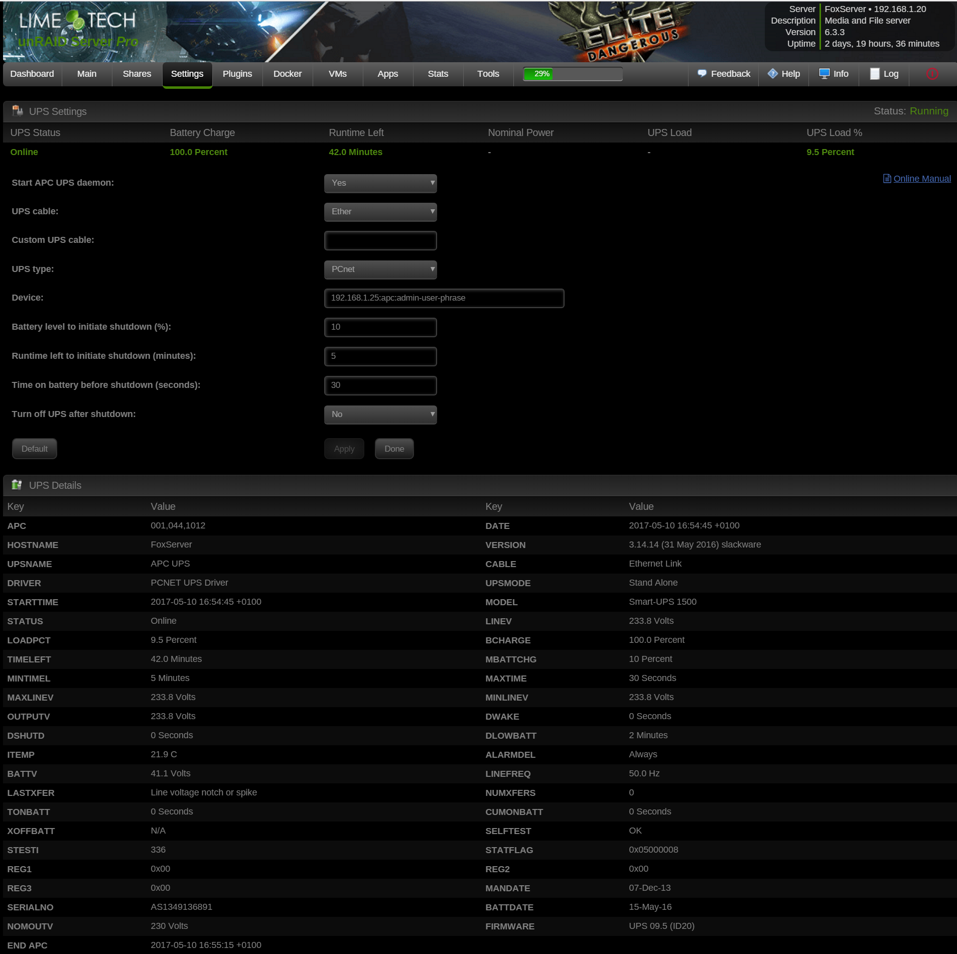

Unevent that's amazing, I'll look into this asap. However I can see the firmware for your management card is the old firmware. I flashed mine up to 6.4.6 (latest version) and it looks very different to your setup... I'll try see what synergies there are between the two front ends.
Ah and your management card is an older device but lets see what I can do...
Edited by Zangief

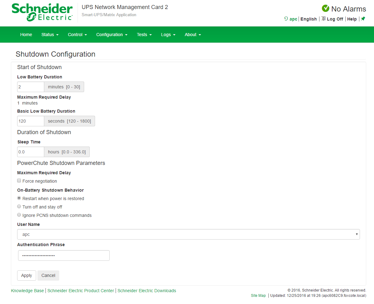

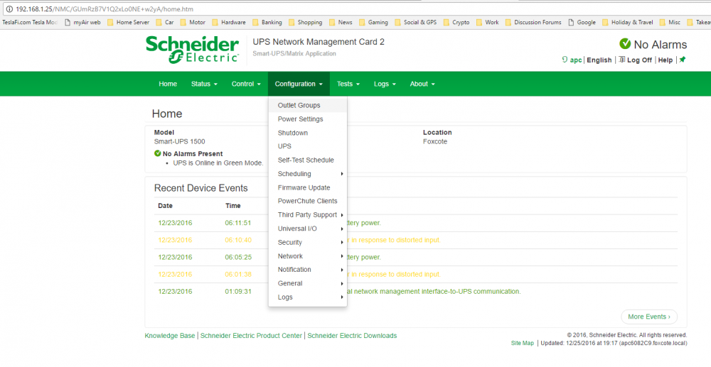

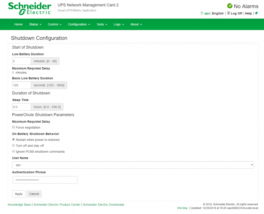

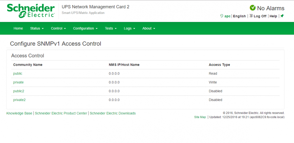

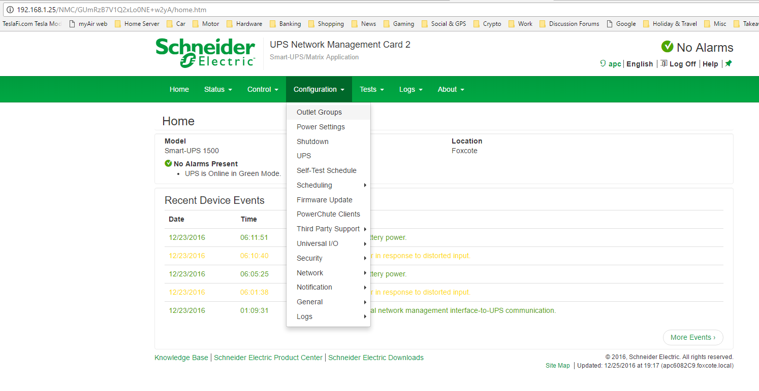

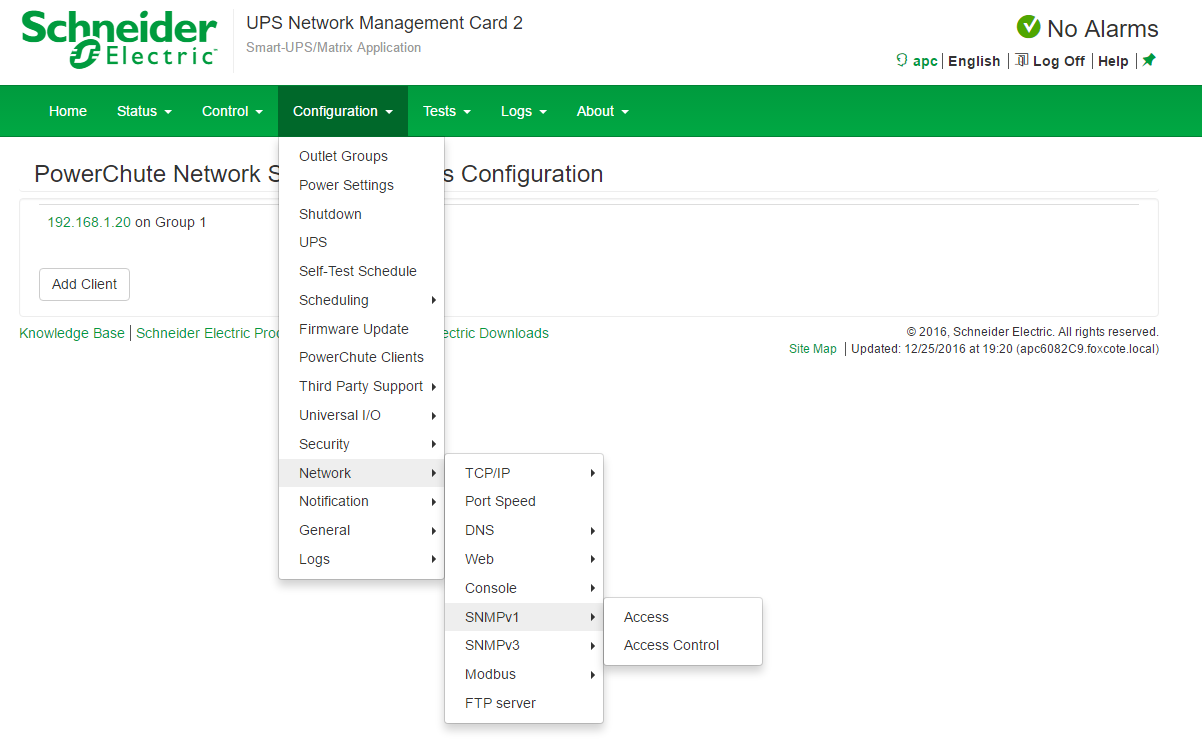

Yes my web GUI doesn't seem to have some of the options you have - e.g. Powerchute Configuration is missing
APC1.thumb.PNG.10d17f5438c23fd94c27f96e7603202b.PNGAPC2.thumb.PNG.3aa51214462db01fe9162ad9f2d0857d.PNGAPC3.thumb.PNG.4bd971fc8de964a5b8c780f1d3ed18fd.PNGAPC4.thumb.PNG.b29077f635bade70377f6b8e059e959d.PNG
Ah this could be it... I'll have another crack at it and confirm success/failure...APC5.thumb.PNG.33f53c0ac2520e9121440dc8ad4510d5.PNG
I'll see what updates are available for the card I have.  In the meantime, under Configuration, Network, TCP/IP, verify your network settings are correct.  Update your passphrase as you show in one of the pics.  That should be all you need to get it running using the info in my previous post if everything else was left at defaults.
Edit: Last firmware update for my AP9619 was from 2010 which is 3.7.2 and still looks like the pics I posted.  You have enough information to make what you have work.  Locations of configuration items are the only things that should be different.  From defaults, verify network TCP/IP settings are correct, add IP under powerchute clients, set the powerchute passphrase and configure apcupsd for snmp following the instructions.
Edited by unevent
Unevent... you are a GENIUS..... thank you...   WORKING!!!!!!!!!!!!!!!!!!!!
