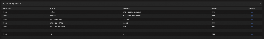

I have a main network IP range, and then I have a vlan for wireless network users.  (bad setup on my part, but too hard to fix at this point).  My issue is that anyone on the wireless network is not able to access my unraid box.
The wired network is 192.168.1.0/24 and the wireless is 192.168.0.0/24
Here is my network settings in Unraid.  When I attempt to add the 192.168.0.0/24 network, it doesn't add.  I think I'm typing it incorrectly.  Can someone quickly educate me on what I need to enter here so I can access the Unraid box from the wireless network?

For clarity, I have cross vlan communication setup and everything on VLan 2 can communicate with VLan 1.
I can see, ping, access, whatever on both sides, but the Unraid server is a black hole on the wireless network.  I could be chasing the wrong thing, but my assumption would be that since the network isn't spelled out in the network settings, it probably wouldn't communicate with it.
