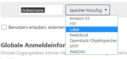

Hi Folks,
probably me, but I can add unraid volumes to next cloud via the external storage app - there is no local option. Could someone please tell me what I'm missing.
Many Thanks,
Mark.

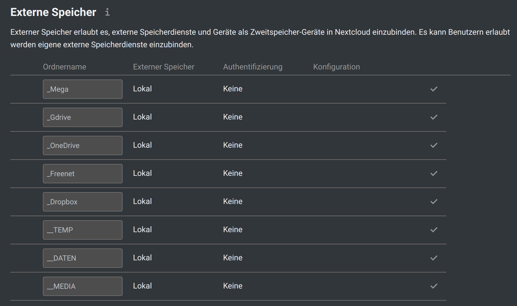

Thats not okay... Do you have access to your shares if you exec it into the container?
Thats how it should look like
school boy error on my part - when clicking on settings for external storage did not realise that there is an admin section at the bottom - that worked and shored the local option - thx for coming back to me though.
