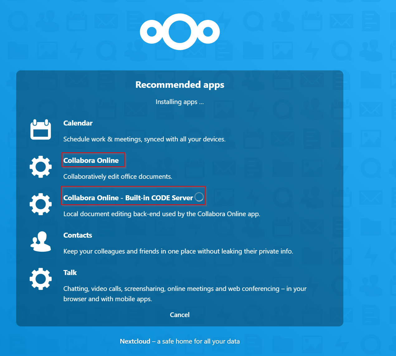

Hey guys!
Little question: Im using the Password App in NC20 and it tells me that it need some higher php version above 7.4. How do I check for the php version and upgrade?
And additionally, there is some odd behaviour with my Collabora installation. I cannot install the integrated Server. When I type
sudo -u abc php -d memory_limit=512M occ app:install richdocumentscode
nothings gonna happen. The installation in the apps section isnt working either...
Thanks in advance friends!

15 minutes ago, knex666 said:
Hi, there have been some updates since the first release of this template.
The Nextcloud Team will not longer support ONLYOFFICE and switched the service. That works well too.
Cheers
PS: If you like my stuff dont mind to buy me a pizza ;-)
Thank you for the prompt reply! Looks like it's time to re-isntall from scratch and try the ONLYOFFICE docker and link them. Thanks again
Dont you like collabora? Then give that a try. I have never tested that. I dont think that its supported
Gesendet von meinem Redmi Note 8 Pro mit Tapatalk
Collabra is expensive when you need to license it. ONLYOFFICE is $149 for 10 users ONE TIME PAYMENT.
Where Collabra wants to charge monthly per user. Not worth it IMO. Nextcloud supports it! I will figure it out others have done it.
