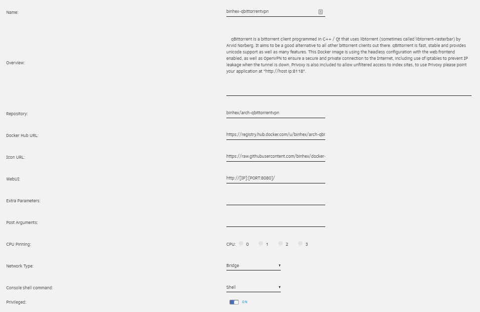

  3. I want to run this docker through the Nginx Proxy Manager docker but port 8080 is used by the binhex-qbittorrentvpn docker. How can I make this work?

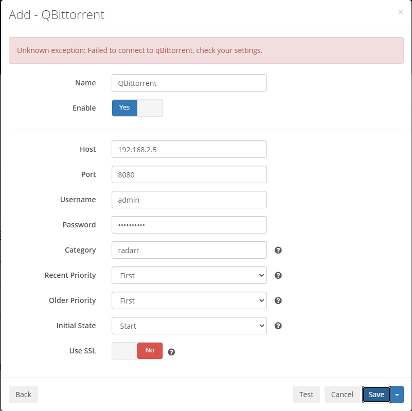

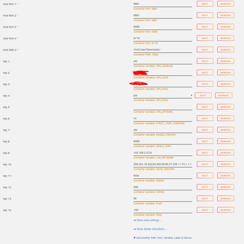

  4. I found the solution for my problem. Because I had some problems with my proxy, I changed it to a socks5 proxy from PIA. Because of this Radarr and Sonarr can't connect with qBittorrent anymore. I changed it back to the HTTP proxy from qBittorrent and it is connecting again. Also the high CPU usage is gone. I made a stupid mistake but I hope someone can learn from it as well if they have the same problem. Thanks Binhex for your help and great docker containers.

  7. It's set to 192.168.2.0/24
  8. I can't add qBittorrent as download client to Sonarr or Radarr anymore. qBittorrent is running and everything was working before.
