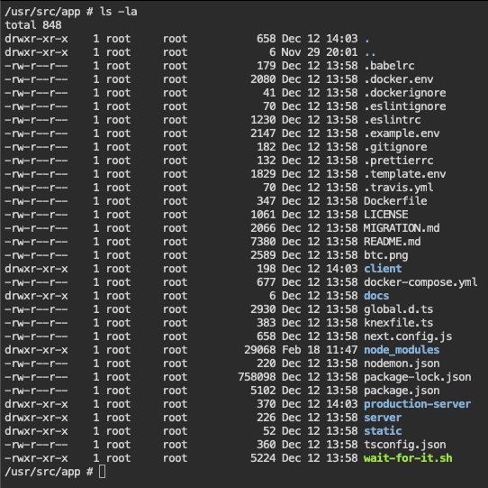

I would like to use kutt. unfortunately I filled the domain field in the template initial with the Protokoll `https://kutt.mydoma.in/`
I already did change it to just `kutt.mydoma.in` but still, if I start the webui (from unraid) the browser try to open `https://https//kutt.mydoma.in`
How can I change this? I couldn't find a entry in the postgresql database. Where is this info stored?

sorry, did forget to mention that I checkt that already too. I guess it is either saved to a db or a config file. I also checked some of the config files from within the container via console
I probably would have already tried to remove the container and start over again but if it is stored to a db that would help neither.
I also just noticed that if a try to access the container over the "ip:port" than I get instant redirected to "https://http//kutt.mydoma.in"
