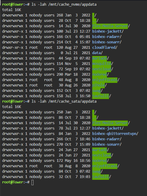

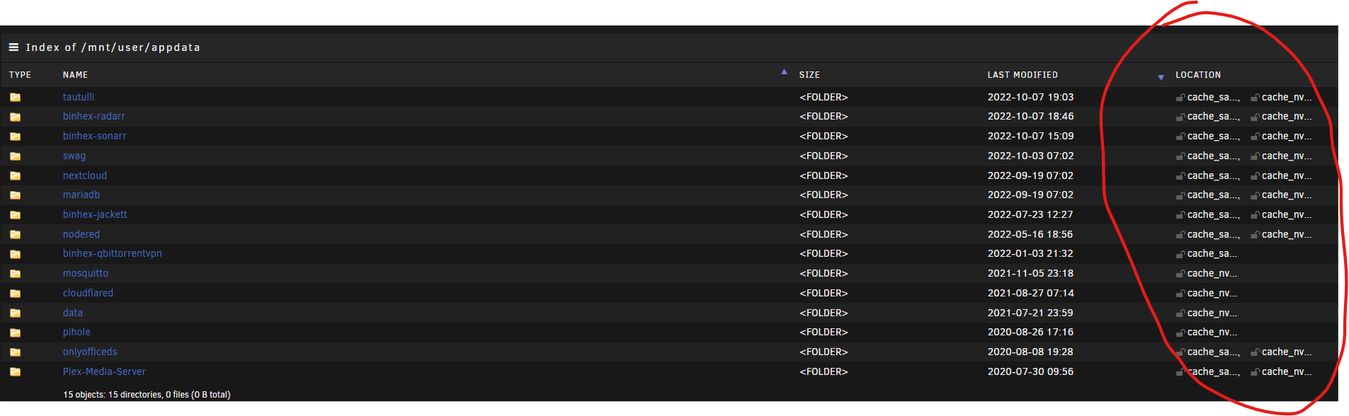

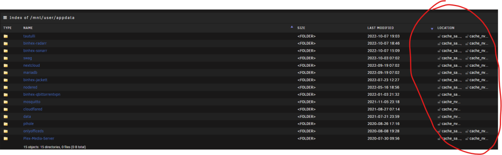

  12. My cache drive is almost full. So I recently added new SSD to my unraid and use it as a additional cache drive, and named cache pool as "cache_sata". I configurate to move all my existing file such as appdata and etc to "cache_sata". I configurate my existing cache to the "Prefer" into the "cache_sata" and invoked mover to move everything. Everything including the docker image moved perfectly, except my appdata share. Please have a look of the screenshot of what I mean. It got split into two regardless if I have forced to "Prefer" to "cache_sata" only. Some appdata content still and currently getting modified in both cache pool. Before upgrade, I have an existing ssd drive, was named cache pool as "cache". However, after invoked the mover, I only renamed the existing SSD drive from "cache" to "cache_nvme". Not sure if this help. Is for your reference. Now I want to move all my appdata content to only "cache_sata" only. Anyone could suggest what I can do?

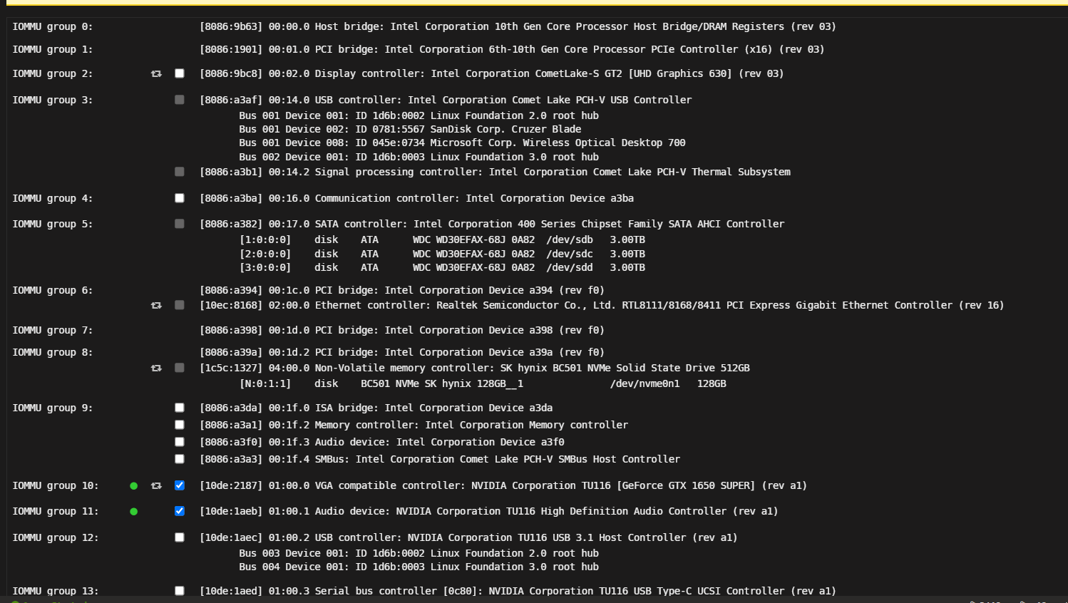

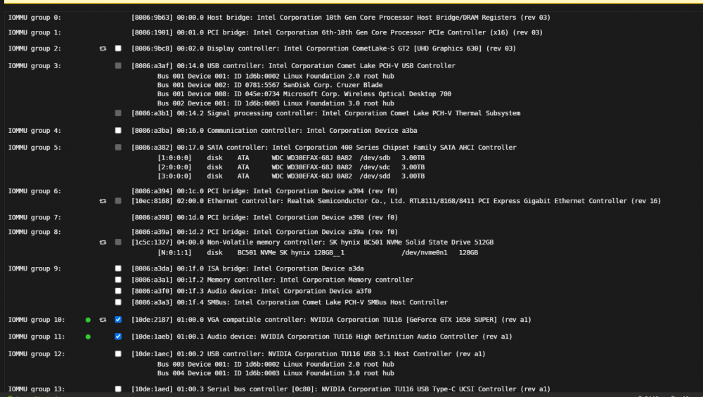

  15. I have manage to passthrough GPU but how can I passthrough the onboard microphone so that I can just plug my headphones into the audiojack and get an audio input on my windows. Below are my IOMMU group for reference. I can see my intel audio devices are not in its onw IOMMU group. So is not possible to passthrough the onboard soundcard? If is not possible to separate the group. It is possible if I just buy a "usb to female audio jack adapter" into one of the usb port, then plug my headphone into the adapter, and passthrough as a usb devices. Will that work?
