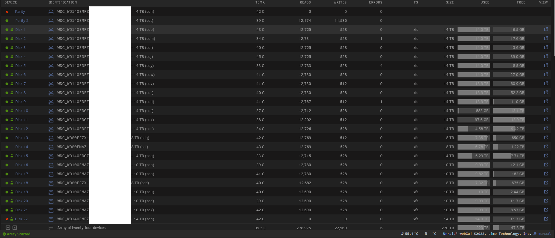

  5. For some reason after this second restart I am able to see all my files but I am unable to begin the rebuild of the parity and of the failed data drive. Is there a specific order I should do or something?
  6. tower-diagnostics-20230314-1028.zip Here is the updated diag @JorgeB
  7. It won't let me stop the array. Is there a command to make it stop cleanly or should I just use the restart button and let it timeout/force it? Also thank you very much for responding.
  8. I updated my bios as I was very out of date and I was doing a general system maintenance. When my server came back up everything appeared fine like it usually does but when it booted all the drives errored. It scared me so I stopped the array and rebooted it again. It came back up and said a pairty drive and a 2nd drive were errored but that everything else was fine. I started the array and it said it started cleanly but now all my data is missing even though it shows the space used. All my drives also for some reason showed up in unassigned devices. Can anyone please help me. Am I totally screwed? tower-diagnostics-20230314-0920.zip
