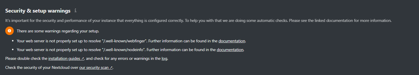

  15. Has anyone solved this warning? I am using subdomain instead of subfolder. I can't seem to find an official solution to the Unraid version.

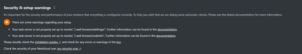

  23. Updating to 2.0.3 wasn't really smooth though. There were errors throughout the updater process but I manage to install it. However, how do I solve the warning given by Nextcloud? Hopefully I am not the one seeing this only.

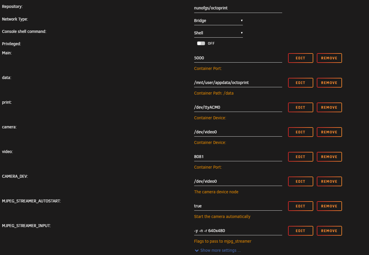

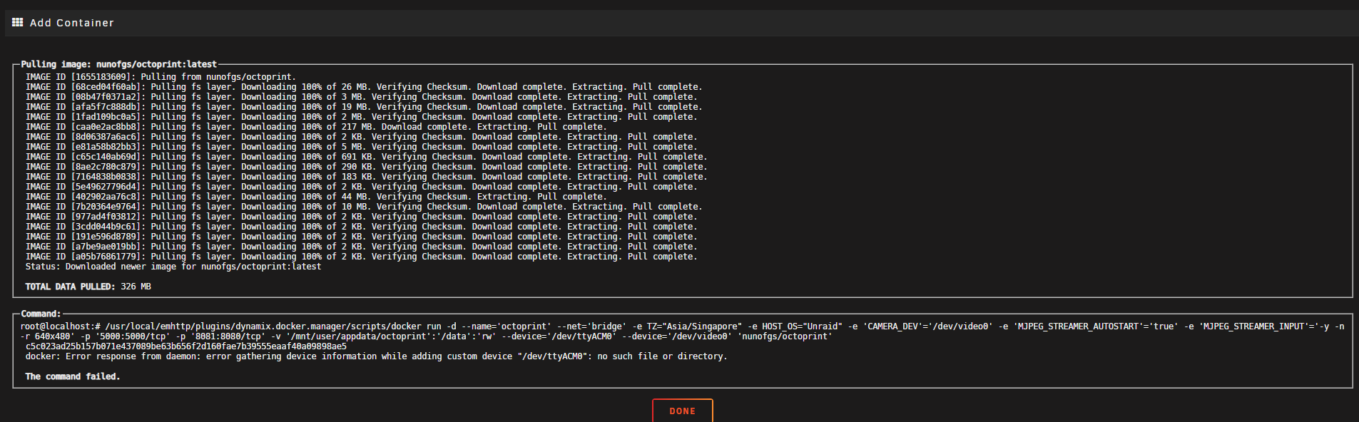

  24. When I install the docker by nunofgs, I got the following errors. Is it because it cannot detect my 3D printer? I am using Creality Ender-3. docker: Error response from daemon: error gathering device information while adding custom device "/dev/ttyACM0": no such file or directory. This is my template input.
