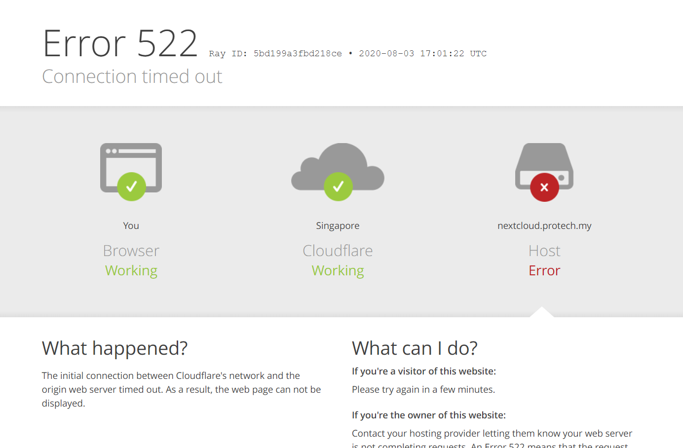

  2. @testdasi @Danuel Alright. I have downloaded the Cloudflare ddns by oznu. The docker has added an A record in my Cloudflare account. However, do I still require to do port forwarding? 80 -> 180 and 443 -> 1443 in my router? I have attached the outcome when I try to access nextcloud.protech.my which is suppose to direct me to my Nextcloud docker. However, it is still not working. Stated Error 522. Connection timed out.

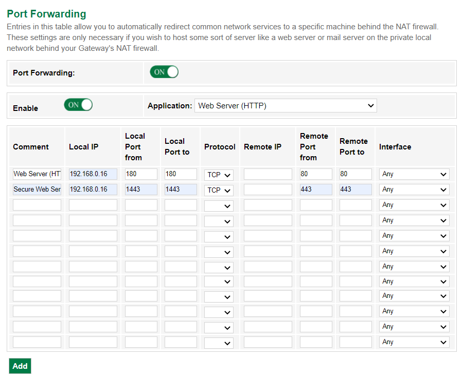

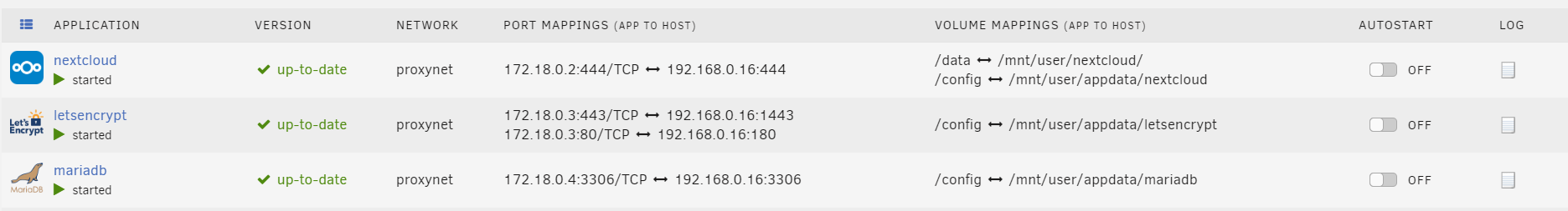

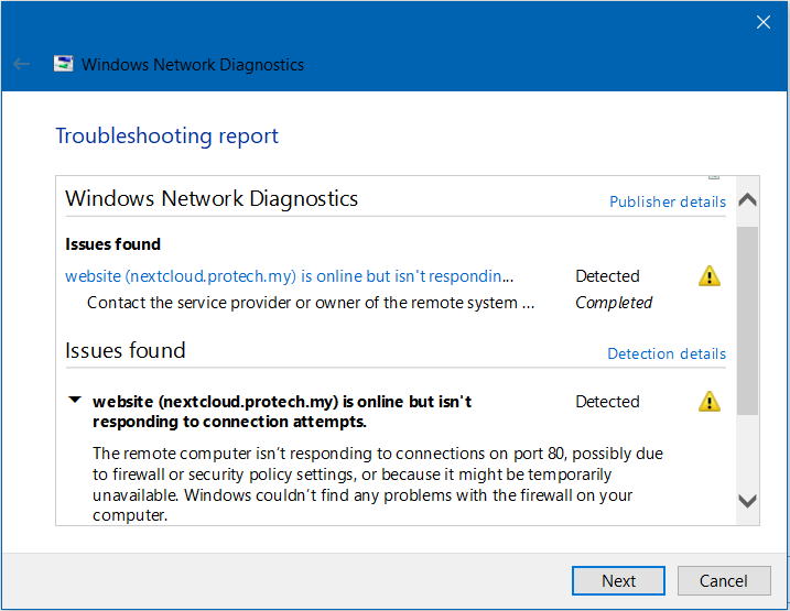

  5. @Energen I did try port forwarding port 80 to 180 and 443 to 1443. However, whenever I forward port 80 to 180, I was unable to load Unraid on my browser so as Nextcloud. I attached the port of my docker and router as well for reference. I am not sure if I done it correctly. Also, I was under the impression that if we use DNS verification as shown by Ed (Spaceinvader) as port 80 is been blocked by ISP, do we still have to port forward in our router? I also try using the Window Network Diagnose, I attached the error report below as well.

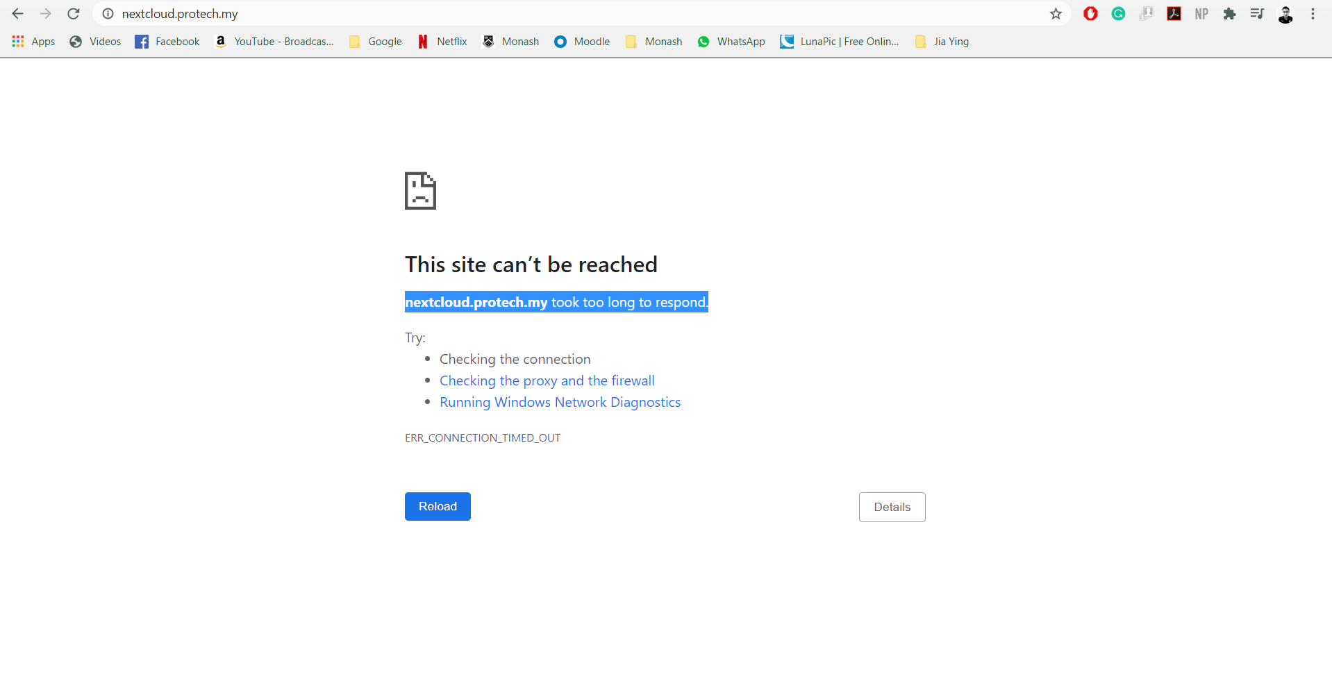

  6. I have followed 2 of SpaceivanderOne videos as shown in the two links below: I manage to get my LetsEncrypte to work with the log as shown below: I am using my own domain of protech.my and I have set the cname to be nextcloud.protech.my Problem: when I try to access my url, it stated "The site can't be reached. nextcloud.protech.my took too long to respond." Could anyone help me to solve what is cause of this ? I am still a newbie to this. 1) 2) Brought to you by linuxserver.io ------------------------------------- To support the app dev(s) visit: Certbot: https://supporters.eff.org/donate/support-work-on-certbot To support LSIO projects visit: https://www.linuxserver.io/donate/ ------------------------------------- GID/UID ------------------------------------- User uid: 99 User gid: 100 ------------------------------------- [cont-init.d] 10-adduser: exited 0. [cont-init.d] 20-config: executing... [cont-init.d] 20-config: exited 0. [cont-init.d] 30-keygen: executing... using keys found in /config/keys [cont-init.d] 30-keygen: exited 0. [cont-init.d] 50-config: executing... Variables set: PUID=99 PGID=100 TZ=Asia/Singapore URL=protech.my SUBDOMAINS=wildcard EXTRA_DOMAINS= ONLY_SUBDOMAINS=true VALIDATION=dns DNSPLUGIN=cloudflare EMAIL=*********@gmail.com STAGING= SUBDOMAINS entered, processing Wildcard cert for only the subdomains of protech.my will be requested E-mail address entered: [email protected] dns validation via cloudflare plugin is selected Certificate exists; parameters unchanged; starting nginx Starting 2019/12/30, GeoIP2 databases require personal license key to download. Please retrieve a free license key from MaxMind, and add a new env variable "MAXMINDDB_LICENSE_KEY", set to your license key. [cont-init.d] 50-config: exited 0. [cont-init.d] 60-renew: executing... The cert does not expire within the next day. Letting the cron script handle the renewal attempts overnight (2:08am). [cont-init.d] 60-renew: exited 0. [cont-init.d] 99-custom-files: executing... [custom-init] no custom files found exiting... [cont-init.d] 99-custom-files: exited 0. [cont-init.d] done. [services.d] starting services [services.d] done. nginx: [alert] detected a LuaJIT version which is not OpenResty's; many optimizations will be disabled and performance will be compromised (see https://github.com/openresty/luajit2 for OpenResty's LuaJIT or, even better, consider using the OpenResty releases from https://openresty.org/en/download.html) Server ready
