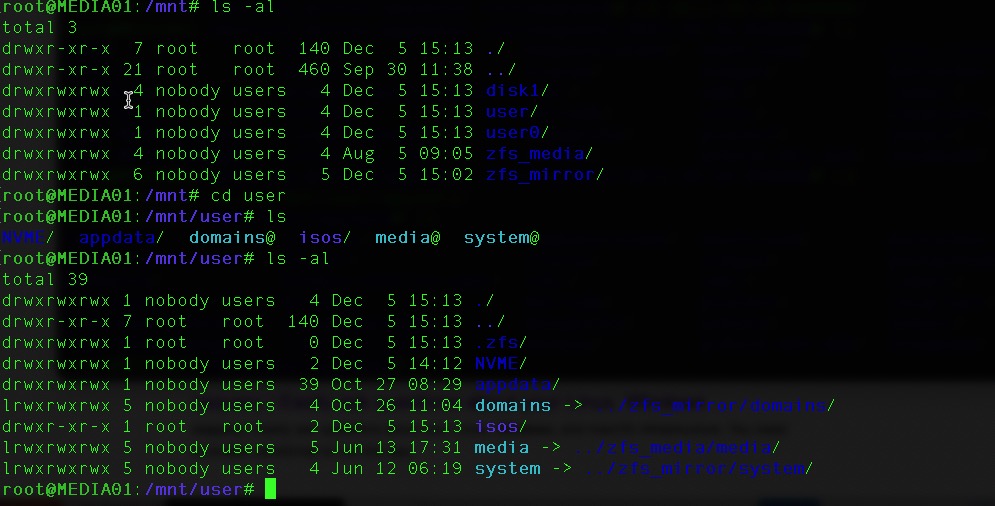

  2. it's happened again, but don't know why this time. When I run the command above, I only see 2 directories listed but they are the same files. Any additional thoughts on what to try? Does enabling NFS security settings cause exclusive mode to turn off? root@MEDIA01:/mnt/user/appdata# ls -d /mnt/*/appdata /mnt/user/appdata/ /mnt/zfs_mirror/appdata/

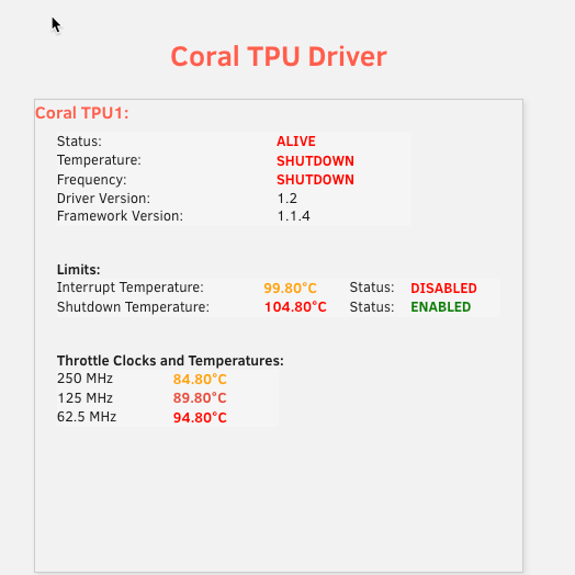

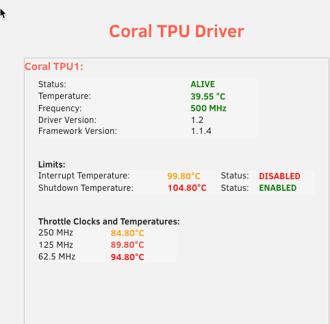

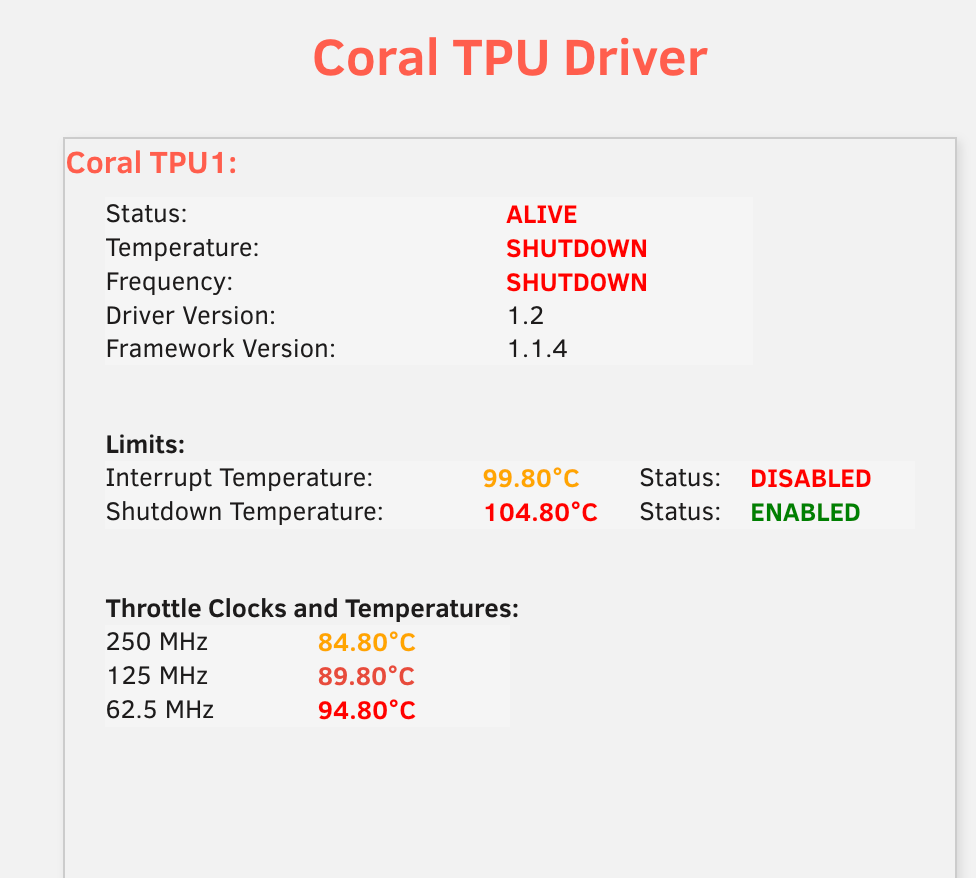

  4. Frigate crashed today and I think it's due to my coral TPU overheating? Any ideas here? It's been working fine for over a week now. This is the PCI version. I rebooted and it came back, but don't know what might have caused it. I have attached 2 screenshots before and after the reboot. detectors: coral: type: edgetpu device: pci:0

  7. I haven't even started using coral yet with Frigate, but I noticed this when I looked under settings. Any thoughts? Frigate isn't even started? Temps were fine the other day and I haven't changed anything. I also see this in Unraid logs Aug 9 08:09:41 MEDIA01 kernel: apex 0000:03:00.0: Apex performance not throttled due to temperature Aug 9 08:09:46 MEDIA01 kernel: apex 0000:03:00.0: Apex performance not throttled due to temperature Aug 9 08:09:51 MEDIA01 kernel: apex 0000:03:00.0: Apex performance not throttled due to temperature Aug 9 What could be causing temperate shutdowns?

  10. root@MEDIA01:/boot/config/modprobe.d# ls -d /mnt/*/appdata /mnt/user/appdata/ /mnt/zfs_media/appdata/ /mnt/zfs_mirror/appdata/ there it is. sorry I know this is basic linux stuff but sometimes I struggle even though I've been playing with linux for years. /mnt/zfs_media/appdata/ <---That is the culprit
  11. The share where exclusive mode is not working is "appdata". No secondary storage is set I did a search and don't see any other folders with that name; just the one. Driving me crazy as I can't figure it out. root@MEDIA01:/mnt# find / -name appdata* /usr/local/emhttp/plugins/appdata.backup /usr/share/bash-completion/completions/appdata-validate find: ‘/sys/kernel/slab’: Input/output error find: ‘/proc/25721’: No such file or directory /mnt/user/appdata find: failed to read
  12. Could also be the fact /mnt/user is being used? Here is a screen shot how /mnt/user points to /mnt/zfs_mirror/...
