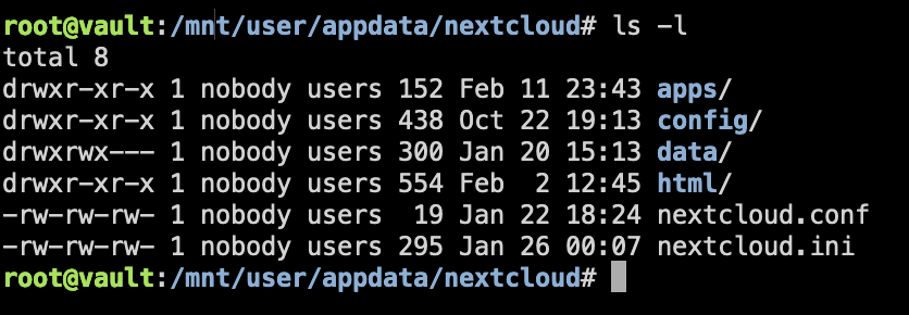

I'm trying to resolve a problem where I think the webserver files are wrong permissions.
In particular I think the followind dirs:
- /var/www/html/
- /var/www/html/config
- /var/www/html/data
Do you know the correct permissions and owners for these dirs?

1 hour ago, KptnKMan said:
Thanks, I totally forgot about docker interactive console.
- /var/www/html/
These are mine. Everything is stock and is working fine since January 2023.

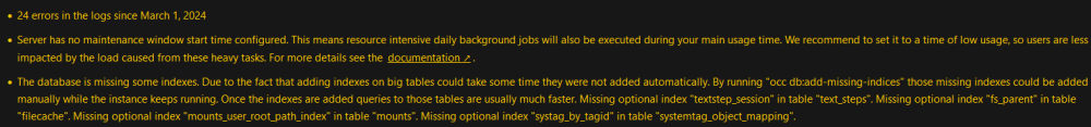

I am getting the below errors in the admin console and the background jobs.  i am not sure how to resolve these.  I am new to some of this but can follow directions.  can someone help me understand/resolve these?  thank you!
For maintenance window just paste this line into config.php file:
'maintenance_window_start' => 1,
If you set it to 1, the maintenance window will be set between 1 and 5 am.
With the database thing just try to run the command it tells you to use. If you're using nextcloud official image just go to the Unraid terminal and paste this command:
docker exec -u 99 nextcloud php ooc db:add-missing-indices

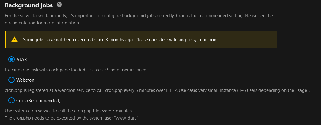

And with the background jobs change AJAX to Cron and if you have User Scripts plugin just add a new script and paste this command:
docker exec -u 99 nextcloud php cron.php
Save and set it to run every 5 minutes with custom schedule */5 * * * *.
thank you, i appreciate the help!
for the maintenance, i put this in the config.php file that is in my appdata>nextcloud>congfig.php? do i put it in the section with dbtype, version, dbname, etc?
database indices worked and cleared the error, thank you!
I switched to cron and set the command in the scripts plugin.

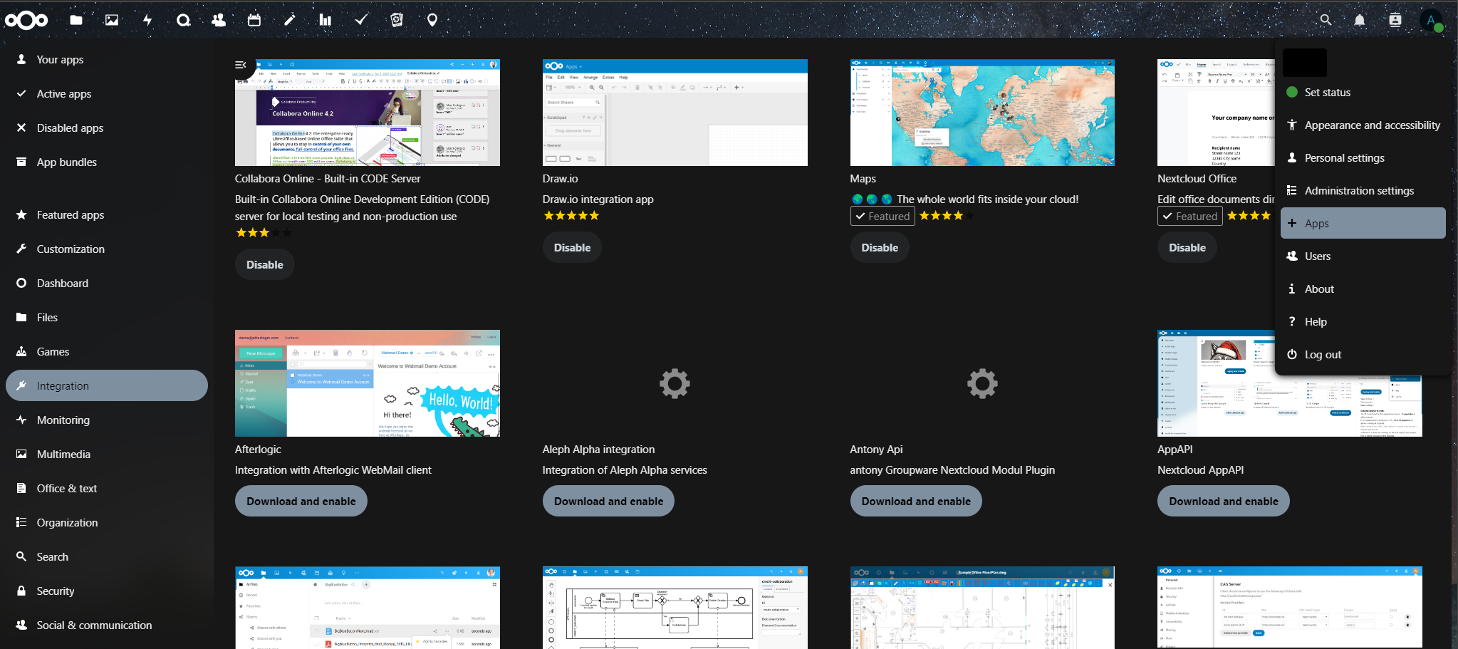

Hey hey,
i hope this is the right place to ask. Im running the nextcloud app on my unraid server which seem to work fine so far. Now i like to test some apps, especially some photo management with AI like memories. Maybe im blind or too stupid, but i dont see any option to install them from the "nextcloud app store" nor can i install them manually by like putting them into the nextcloud apps or html custom apps folder (no permission).
Whats the way to go to get some custom apps installed?
Store should work just fine.

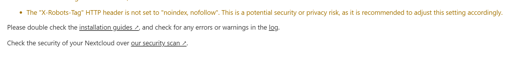

/mnt/user/appdata/nextcloud/nginx/site-confs/default.conf
add_header X-Robots-Tag                         "noindex, nofollow, nosnippet, nofollow" always;
I also have it in the swag nginx container
Any clue why I still get this?
Stupid question: I do find the store but i dont see any option to install. I cant imagine how, too ... as i have a local install and no connection to any store 🙈
How is that store thing supposed to work?
beside that i find some command line stuff but that doesnt work 💁
Edited by Saarlaender
Just menu->apps when logged with your admin account
