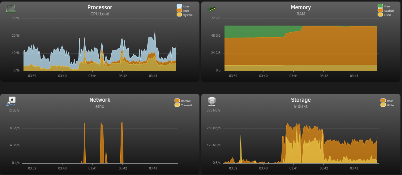

Help? Strange 10Gbit network behaviour, trying to migrate TBs of data, ultra-slow speed transfer between 2 unraid servers.

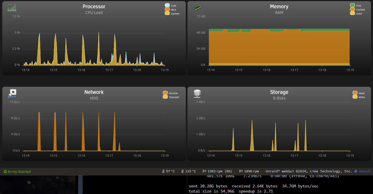

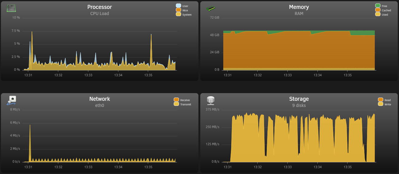

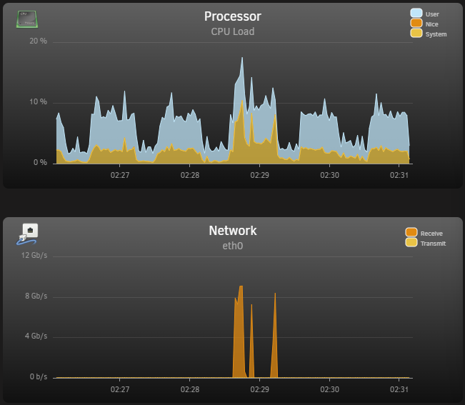

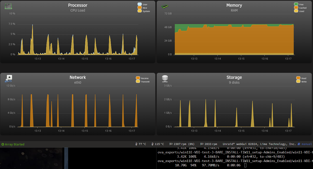

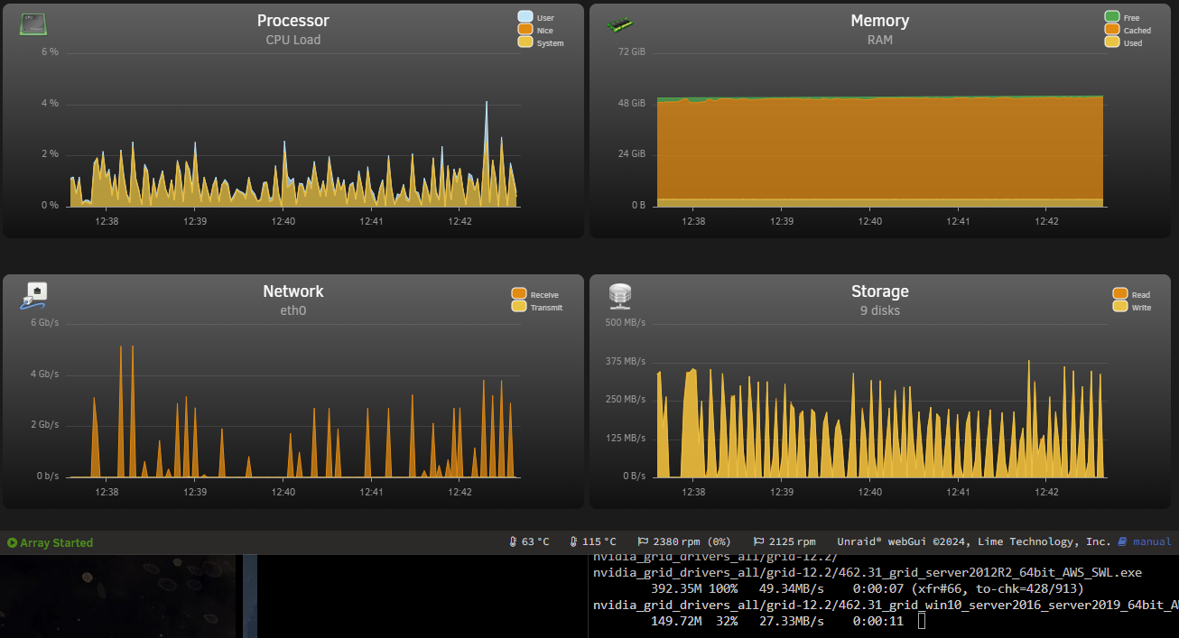

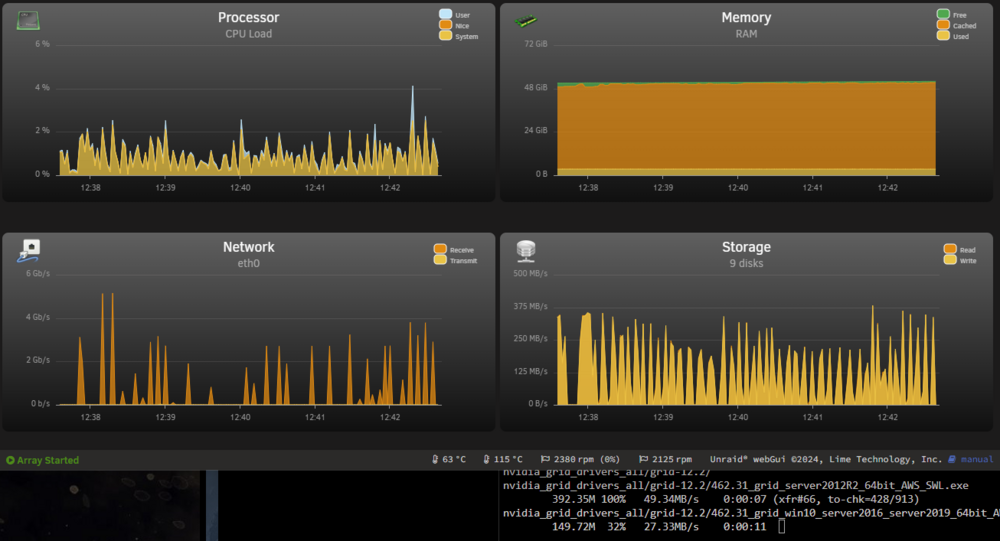

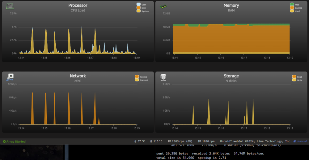

Thanks for the responses guys, I've looked into things and did another full review... but I still think SOMETHING was up. The reason I say this is that I know that my array is capable of writes more than 70MBs, and very low write speeds is what alarmed me. Its visible on the graphs that there is a lot of reading at 200MBs and little writing at a low ~10-15MBs. I also came to the same educated guess conclusion that it's caching, but the numbers still didn't sit right. I left it running all night, and I think the same happened, there was a relatively small amount transferred. Today, I saw my ISP router had an issue overnight (Coincidence, no idea), and decided I would do a full restart of the entire network and UNRAIDs (Have not done that in years at this point). So I cold started both the UNRAID servers, and cold started my ISP router, pfsense router, all wifi APs, all switches. After that I waited for everything to settle and started the transfer again. I also turned off Docker and VMs on both servers to make sure I'm seeing relatively real numbers. This is now what I'm seeing on UNRAID2: I think this is more inline with what I was expecting to see, the write speed of the disks is much higher at 200MBs, in fairly consistent bursts. Maybe its that the spinning disk caches will fill up and the writes will drop down again, but it seems pretty consistent so far. I woud still expect something above 15MBs, but maybe its a psychological thing like you said. Am I wrong in this estimation? I also did a test with trasferring 55GB with the cache turned on, to compare again, and its again what I would expect with writing to the cache at 2GBs, bursting to the NVME drive: And the 55GB finished, looked along what I expect, it's consistent even though its in bursts (Where before it seemed to stall for VERY long time): And with that done, I then waited for the cache to empty to disk and ran the mover: The mover is apparently great at consistent writes above 300MBs though. If the mover is writing at 300MBs to disk, and the remote transfers in from spinning disks anyway, is it better to just leave the cache on? In the end, would you advise migrating large data with the NVME cache on or off, I mean overall? I still have another ~6.5TB to migrate. I made sure that turbo writes/reconstruct write is turned on before this migration, it's actually been on a week now in preparation for this. Thanks for the reminder, I've been wondering, is it advisable to have this turned on long term as I have read that it is harder on the array disks?

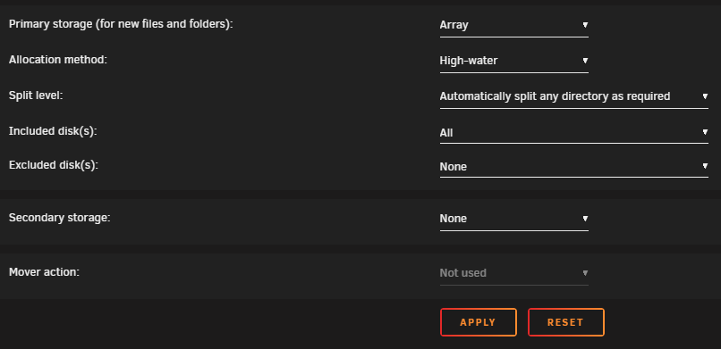

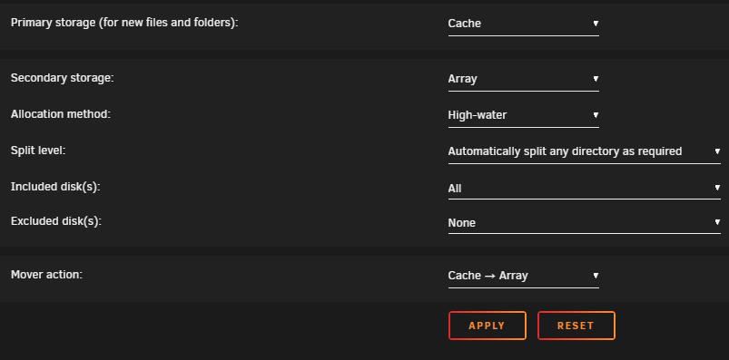

Hi, so I'm trying to move/migrate about 8TB of data between two unraid servers. Both systems equipped with 10Gbit networking, and have been working fine otherwise. I have mounted the UNRAID2 SMB unraid shares on UNRAID1 as remote mount points. I have been trying a "push" migration, running commands on UNRAID1 to "push" files over to UNRAID2. I have checked through all networking settings and everthing seems fine, nothing has been changed. Everything else is working fine on the network. I started doing migration using `mv` but then it cannot be resumed, so I switched to rsync using the following command: `rsync -avzh --remove-source-files --progress /mnt/user/isos/ /mnt/remotes/UNRAID2_isos/` After this rsync migration completes, I intend to run this to find and remove the empty dirs left behind (I never got this far): `find /mnt/user/isos/ -type d -empty -delete` I noticed that it would fill up the 2TB cache drive, and everything would slow right down while the mover on UNRAID2 started emptying the cache, and the transfer continued, and the whole process would stall while the mover frantically emptied the cache while more data was pushed. So, I figured that I would simply wait for the mover to move everything from the cache drive to array, on UNRAID2 change the `iso` share options to write directly to array without cache involved, and resume the move/migration again... Before: After: I figured it would be slower writing to the array disks at ~250MBs rather than NVME speed far above that, but I could leave it and let it run until its done, and the mover would not be required. I figured the source is the array disks on UNRAID1, so in the end its not much different in overall speed. Now when I started doing the migration without cache/mover involved, I've noticed that the transfer will start, about 3 or 4 files will be moved over, and then it would just stall. System Stats from UNRAID2: You can see here, the transfer would begin, it would copy some files, with some breaks, then stall and wait. After doing this a few times, I rebooted both systems multiple times, cold booted both systems multiple times, and rechecked all settings. Nothing seems odd. After this, I tried reconfiguring the `isos` share on UNRAID2 to use cache again, and that seemed to start working, but slower. So that seemed to work, but then the same problem would eventually occur where the cache would fill and speeds would slow down while the mover does its job again. So I stopped the transfer, ran the mover, and waited for all files to be moved. After this I reconfigured the `isos` share back to not use cache, and the same problem appeared (UNRAID2): I'm really at quite at a loss as to what is happening here. Can anyone help?

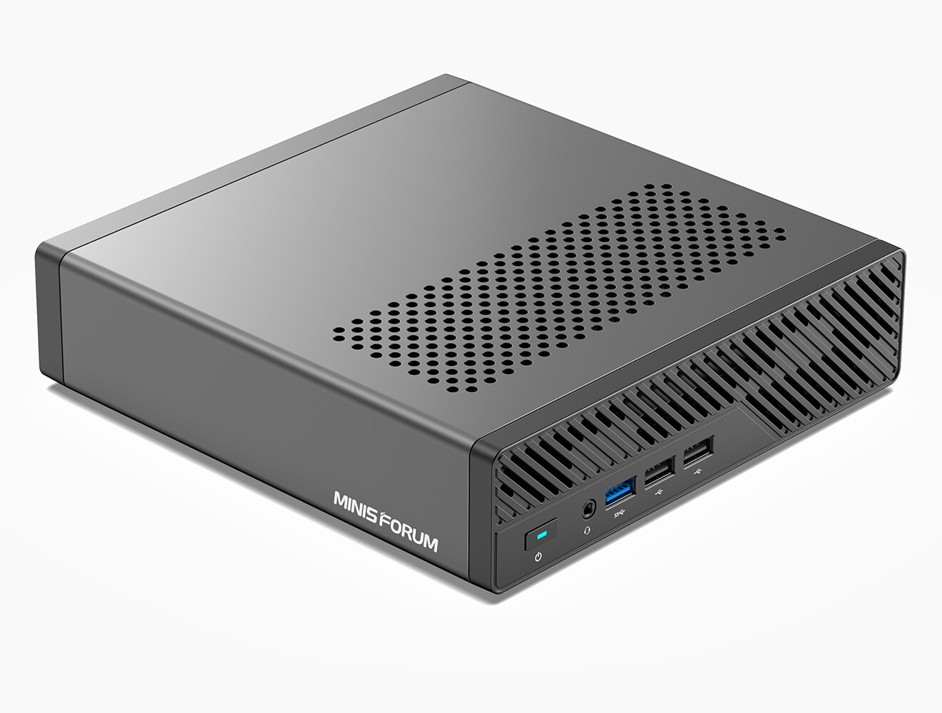

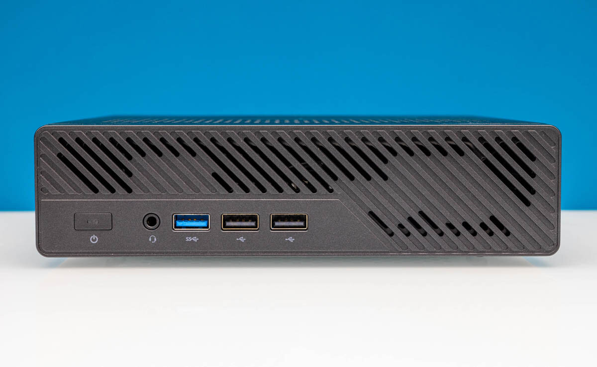

Case icon requests
I'm sure I might not be the only person that wants a Miniforum MS-01 icon. Thanks anyone that can do this.
