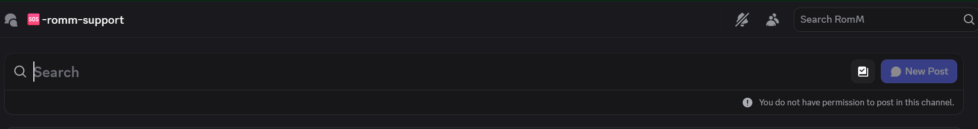

Looks like it's a terms of service issue. You must accept the terms of service, I can post on my phone I got the pop up but not a pc web browser. I get no pop up for terms of service on the PC. I am not going to try an type out the issue on a phone. This app RomM app isn't worth the hassle. They have chosen a rigid file structure with their "new" rollout. You used to be able to give it a path. n64: paths: - "Nintendo 64/roms" - "Nintendo 64/Europe" For whatever reason they abandoned that and went with this new rigid structure which is inflexible. Some of my rom directories have no "roms" folder at all and are just flat. nes: paths: - "Nintendo Entertainment System" This would also violate their current folder structure requirement since you must have one or the other. I spent a day trying to get it to work. If you are just starting out and you are ok with their rigid file structure then this app will probably work fine. If you have an already established collection or roms/emulators then this app in its current form will not work.
[Support] Eurotimmy - RomM (ROM Manager) by zurdi15
there documentation is pretty clear they expect a rigid file structure. So you must bend to the will of the tool and not use the folder structure you want. You must use the folder structure they want you to use. https://docs.romm.app/latest/Getting-Started/Folder-Structure/?utm_source=copilot.com#folder-organization I dont know the magic dance required to post a question. Like I said getting support is not easy for this app
Same problem I had. Support appears to be non existent
Dont know how many folks have tried using this. It seems like a cool idea but it lacks execution. It expects you to name the folder the way it wants you to. If you have a different folder structure then it expect good luck getting this to work. I have spent hours on the stupid config.yml file filesystem: firmware_folder: bios roms_folder: library n64: paths: - "Nintendo 64/roms" - "Nintendo 64/Europe" system: platforms: Nintendo 64: n64 ERROR: [RomM][scan][2026-05-10 00:28:44] ROMs not found for platform Nintendo 64. Check RomM folder structure here: https://docs.romm.app/latest/Getting-Started/Folder-Structure/ for more details INFO: [RomM][scan][2026-05-10 00:28:44] Found 27 platforms in the file system INFO: [RomM][scan][2026-05-10 00:28:44] Folder n64[Nintendo 64] identified as Nintendo 64 🎮 WARNING: [RomM][scan][2026-05-10 00:28:44] ⚠️ No firmware found for Nintendo 64[Nintendo 64] ERROR: [RomM][scan][2026-05-10 00:28:44] ROMs not found for platform Nintendo 64. Check RomM folder structure here: https://docs.romm.app/latest/Getting-Started/Folder-Structure/ for more details Although if I go look for the roms they exist in the docker container If I change roms_folder: to something that doesnt exits It will kind of work it will find 8 platforms and all the roms under those 8 platforms. This is extremely buggy software. I cant recommend this one unless your starting from scratch and willing to use the folder structure/names they appear to have hard coded into the system.
