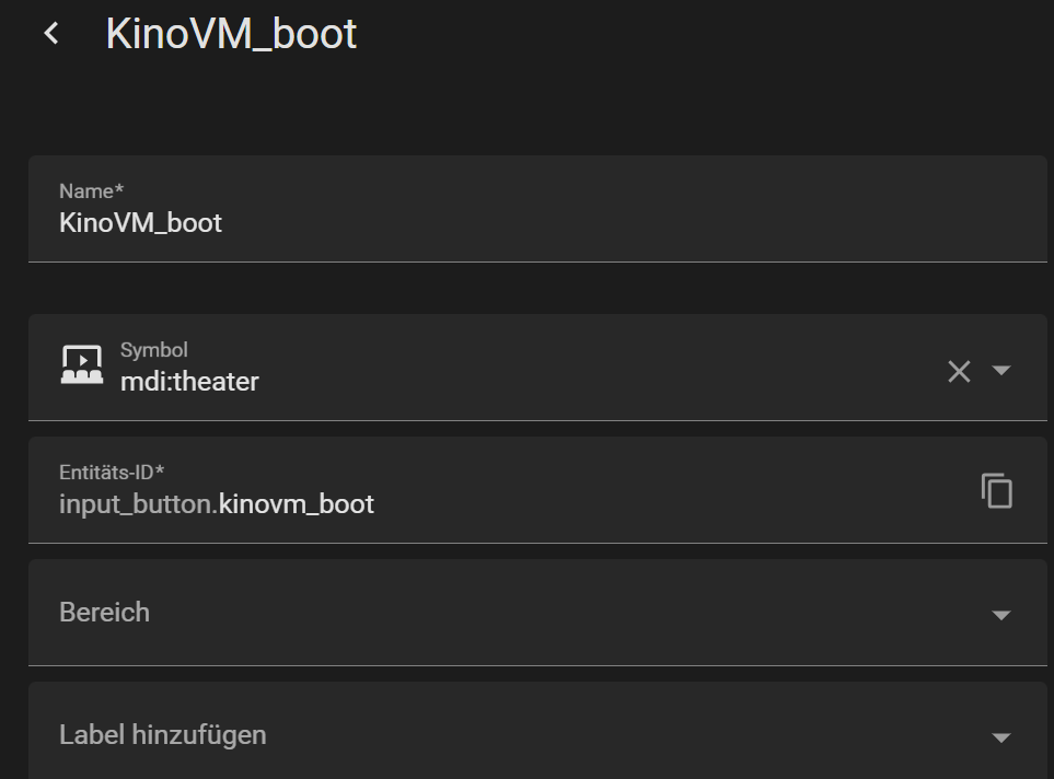

  22. First create a simple button. After that create an automation, that looks like this: alias: WOL_KinoVM description: "" trigger: - platform: state entity_id: - input_button.kinovm_boot condition: [] action: - service: wake_on_lan.send_magic_packet metadata: {} data: broadcast_port: 9 mac: 52:54:00:7v:2k:q7 mode: single after that you can add your button, which you have created in the first step, to your dashboard. Regarding my problem. No problem, it happend only once and never again
