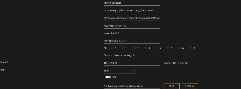

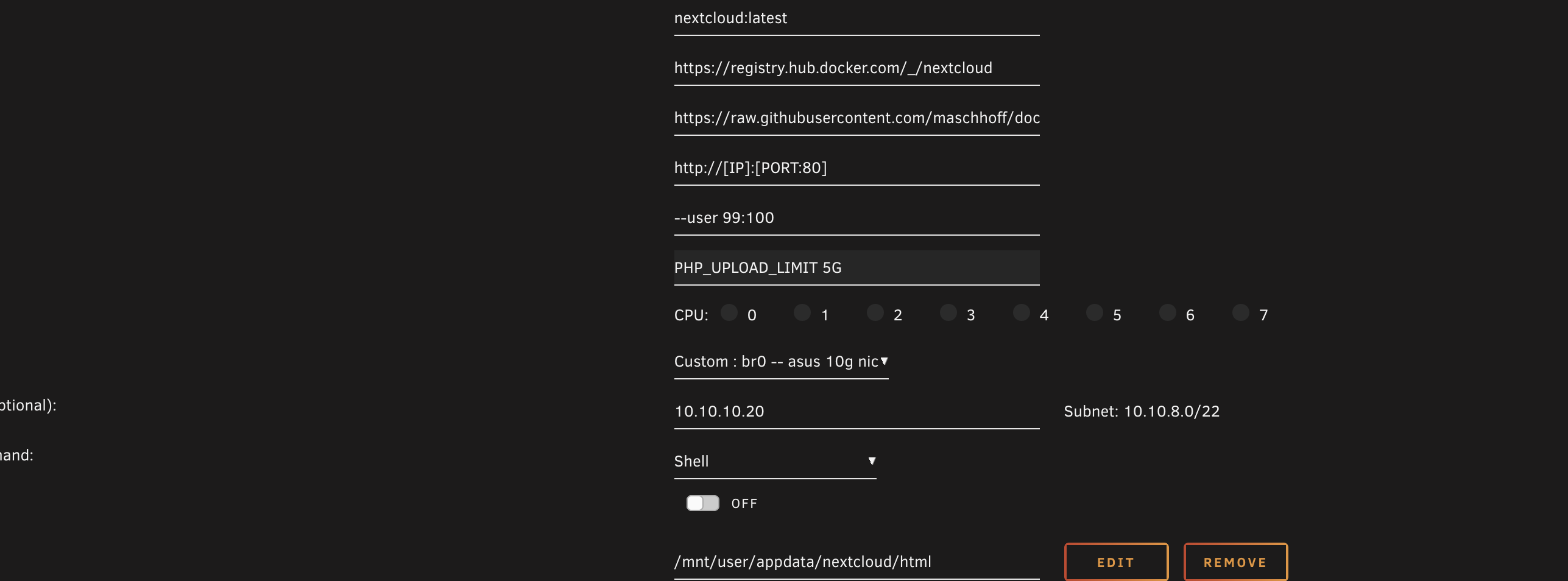

docker argument - set this in the unraid gui
I tried both PHP_UPLOAD_LIMIT 5G and PHP_UPLOAD_LIMIT and also PHP_UPLOAD_LIMIT = 5G and nextcloud crashes and refuses to start, I cant even open logs if I have any PHP arguments. Im lost sorry.

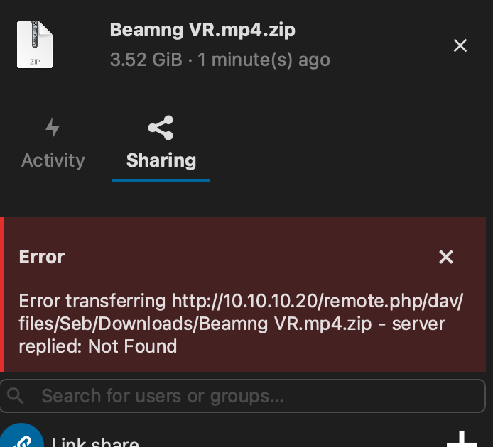

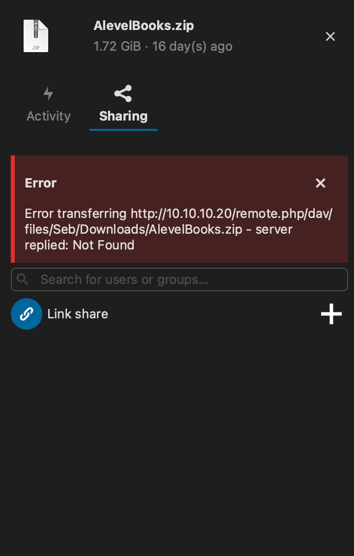

Needs to be
-e PHP_UPLOAD_LIMIT=5G
added to Extra parameters, not post arguments

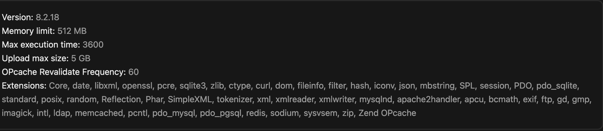

4 hours ago, Kilrah said:
Needs to be

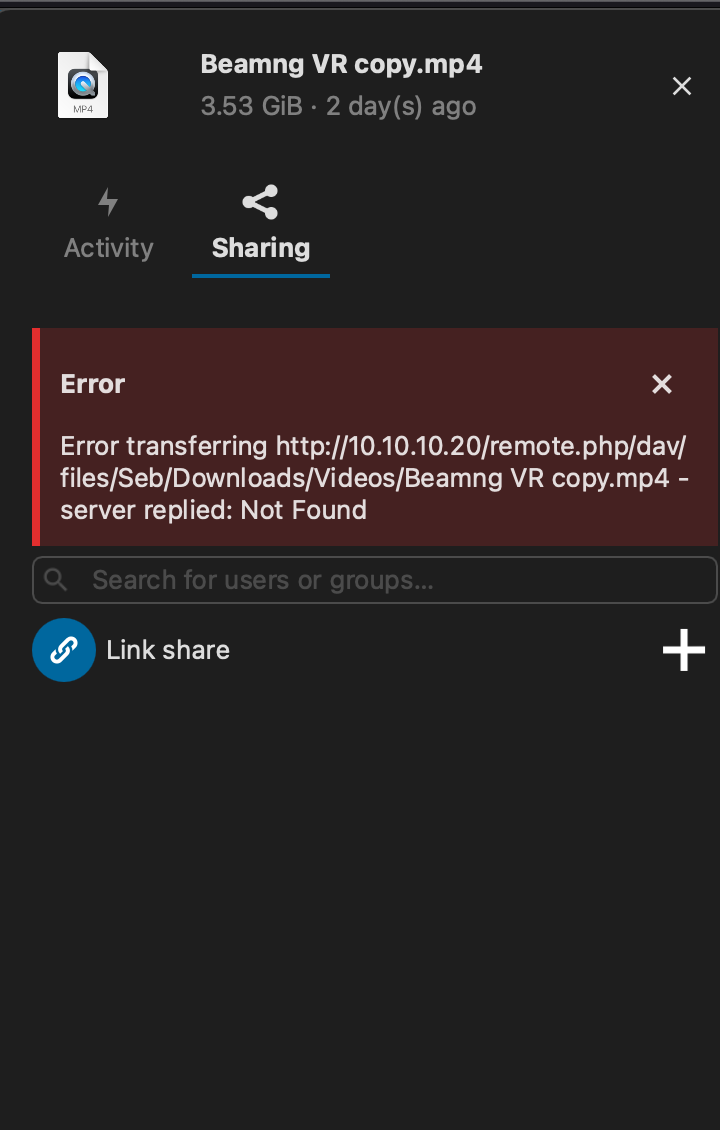

Thanks, some progress, nextcloud sees the change in max upload size but I still cant upload files bigger than 1gb, i tried with a 3.7gb file and it failed. I imagine you have to increase the memory limit also, i guess you put the args in the same place right?

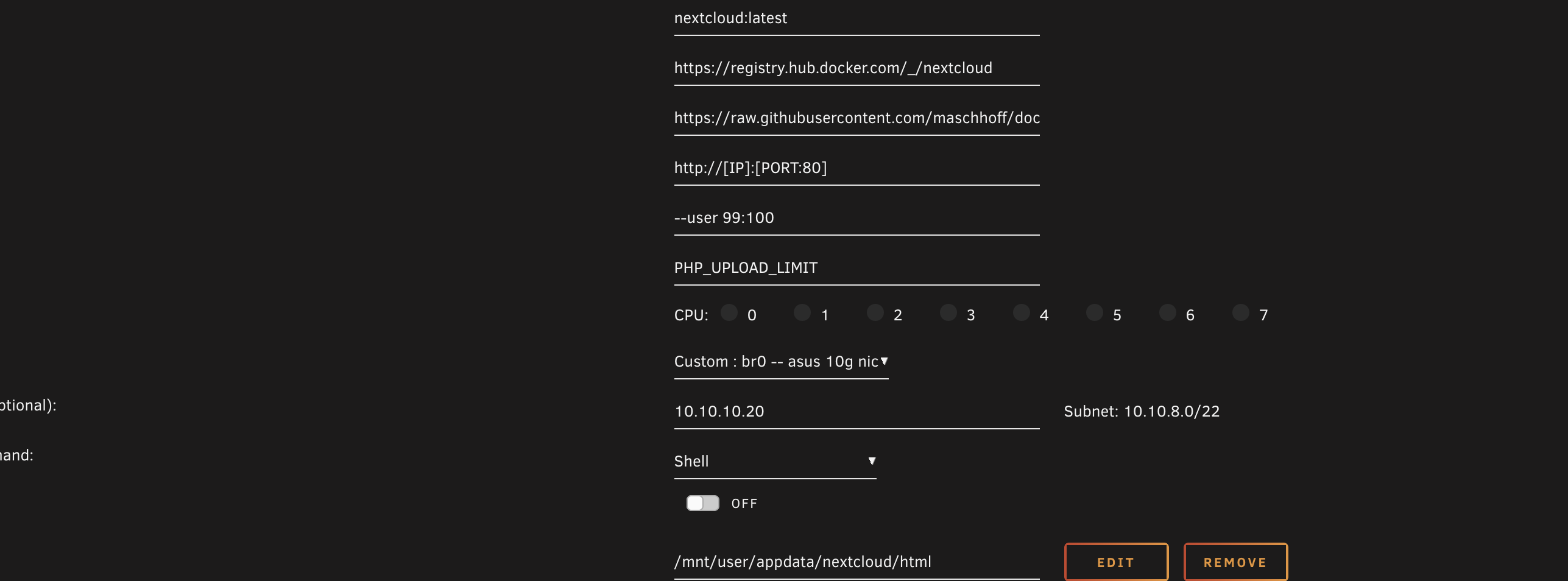

I have
-e PHP_MEMORY_LIMIT=1G -e PHP_UPLOAD_LIMIT=0
and can upload 5+GB files just fine.
If you use a reverse proxy you may need to change config there too.
I have no reverse proxy it is all over lan. Even with the same config as you. I tried with upload limit as 0 and 25G and still nothing...
I tried the exact same order like this :
unraid also puts a user to run it as which goes before, I dont imagine this affects anything:
--user 99:100
1440082447_Screenshot2024-05-02at00_25_22.thumb.png.c285c11ec8f3b58318663be5735e0375.png
Even for a 1.7gig file it cant
608553798_Screenshot2024-05-02at00_35_27.thumb.png.340577b978588ae48fef4f906da0ab3b.png

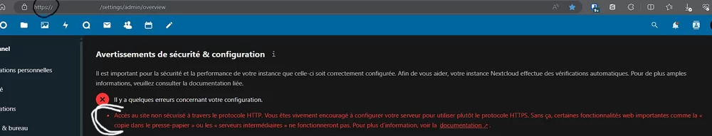

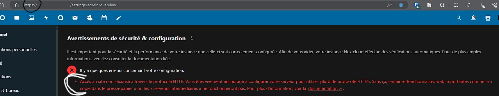

I'm having a problem.
After installing the image, I am faced with a problem, Nextcloud tells me it is in HTTP when I am indeed in HTTPS.
How to do ? I saw help talking about modifying the virtualhost but you have to be root or use sudo (not installed)
Can someone enlighten me because if I can't correct this Nextcloud is of no use to me since the apps don't want to connect to it...nc-error.thumb.webp.31f8a1289fd0ab57190340739fcc1e8c.webp
