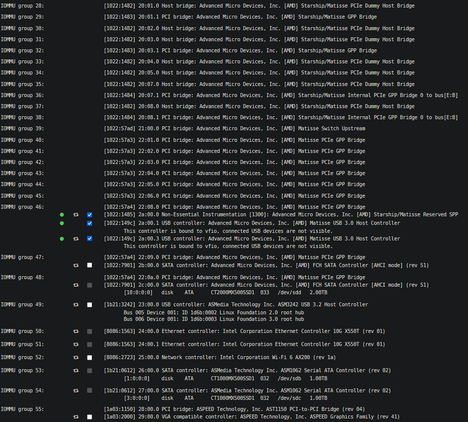

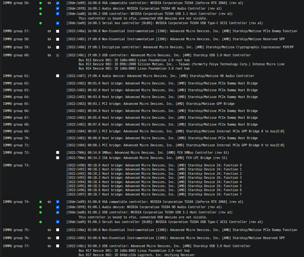

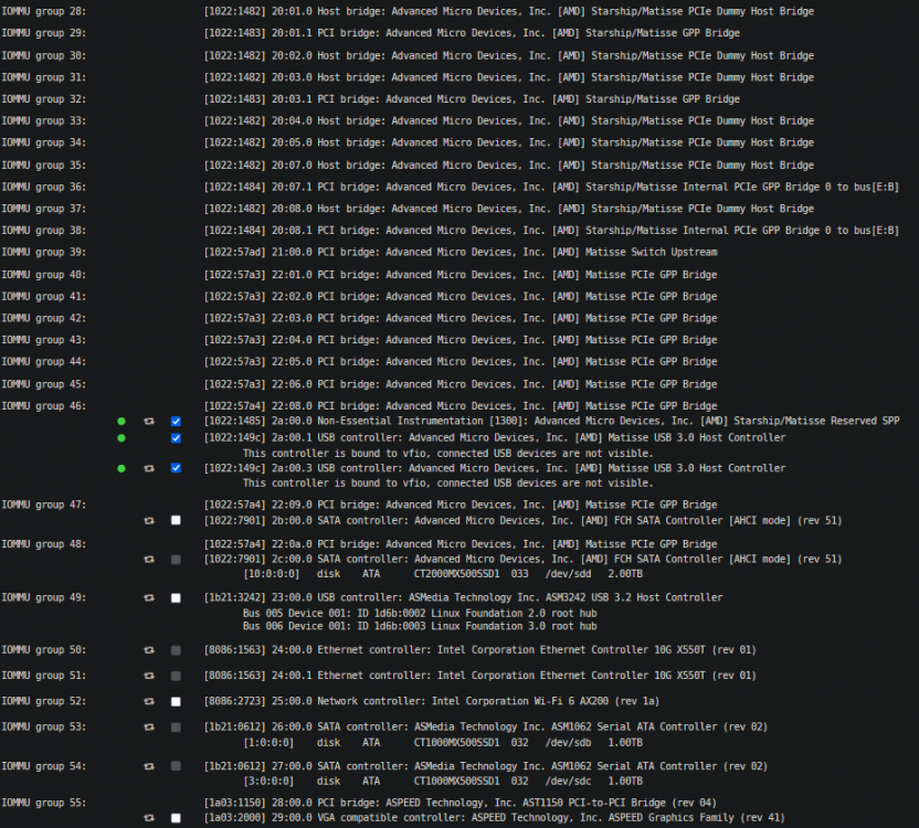

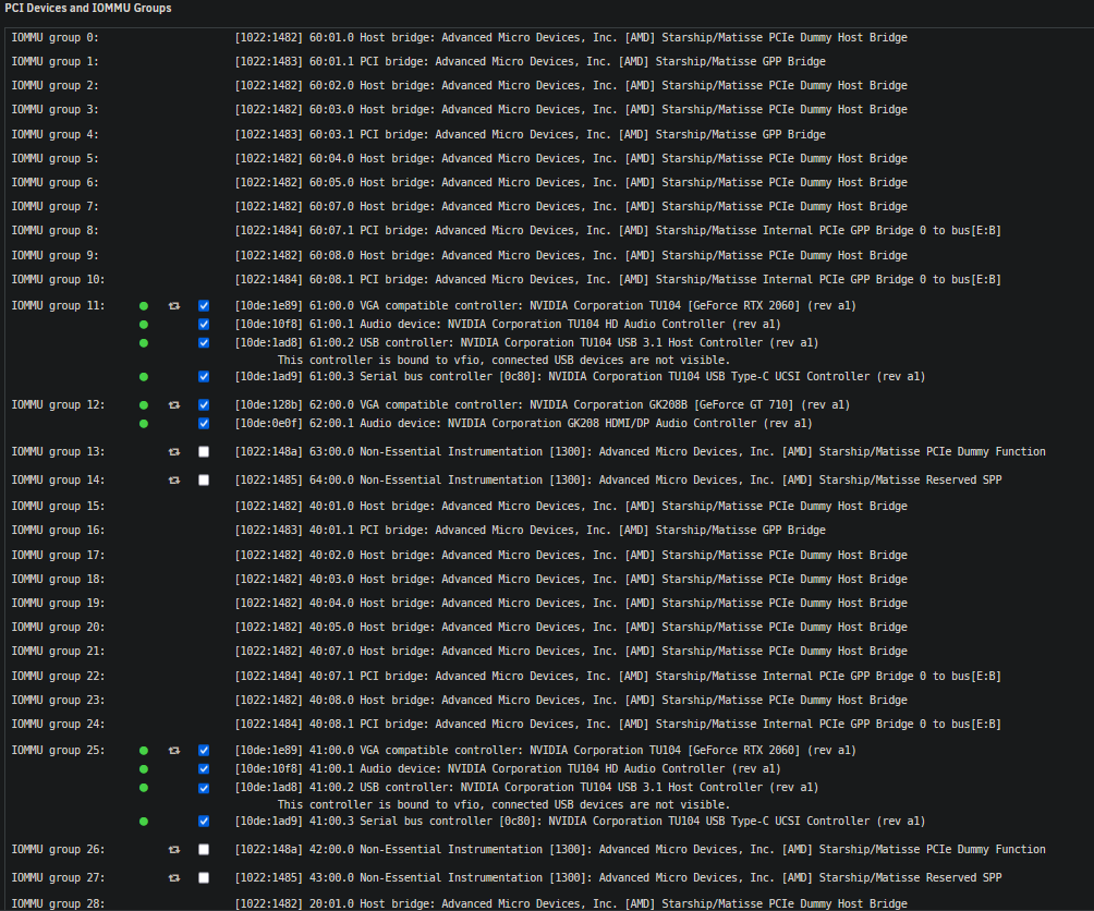

  3. Hi Yes you can. I have a PC with 2 GPU's (RTX 2080 Super and an old GTX1080 Super) that works fine. my latest project is a PC with 5 GPUs (4x RTX 2060 and a GT710) that also works very well, except that my new Threadripper does not release the GPU in the 1st slot for GPU Passtrogh. But i'm working on it....
  4. Hi guys I updated my gaming machine with a threadripper, unfortunately the GPU passthrough from the 1st GFK is no longer possible ... can someone help me? Specs: M/B: ASUSTeK COMPUTER INC. Pro WS WRX80E-SAGE SE WIFI Version Rev 1.xx - s/n: 210483465700039 BIOS: American Megatrends Inc. Version 0405. Dated: 03/17/2021 CPU: AMD Ryzen Threadripper PRO 3955WX 16-Cores @ 3900 MHz HVM: Enabled IOMMU: Enabled Cache: 1 MB, 8 MB, 64 MB Memory: 128 GiB DDR4 (max. installable capacity 512 GiB) GFK: 4x RTX 2060 EVO and 1x GT 710 use case: A 4 player couch gaming machine like an X-Box The GT 710 GFK combines the 4 images into one via NDI streams. Problem: The top GFK (slot 1) installed on the MB does not want to start since the change from an i9-9900K Error message on the VM Log: pci,host=0000:41:00.0,id=hostdev0,bus=pci.0,addr=0x6: Failed to mmap 0000:41:00.0 BAR 1. Performance may be slow 2021-06-23T16:07:48.918447Z qemu-system-x86_64: vfio: Unable to power on device, stuck in D3 XML: <?xml version='1.0' encoding='UTF-8'?> <domain type='kvm'> <name>Game_1</name> <uuid>c6a0f7ea-92a5-9e75-c7f8-f127a7994073</uuid> <metadata> <vmtemplate xmlns="unraid" name="Windows 10" icon="windows.png" os="windows10"/> </metadata> <memory unit='KiB'>24641536</memory> <currentMemory unit='KiB'>24641536</currentMemory> <memoryBacking> <nosharepages/> </memoryBacking> <vcpu placement='static'>6</vcpu> <cputune> <vcpupin vcpu='0' cpuset='0'/> <vcpupin vcpu='1' cpuset='16'/> <vcpupin vcpu='2' cpuset='1'/> <vcpupin vcpu='3' cpuset='17'/> <vcpupin vcpu='4' cpuset='2'/> <vcpupin vcpu='5' cpuset='18'/> </cputune> <os> <type arch='x86_64' machine='pc-i440fx-5.1'>hvm</type> <loader readonly='yes' type='pflash'>/usr/share/qemu/ovmf-x64/OVMF_CODE-pure-efi.fd</loader> <nvram>/etc/libvirt/qemu/nvram/c6a0f7ea-92a5-9e75-c7f8-f127a7994073_VARS-pure-efi.fd</nvram> </os> <features> <acpi/> <apic/> <hyperv> <relaxed state='on'/> <vapic state='on'/> <spinlocks state='on' retries='8191'/> <vendor_id state='on' value='none'/> </hyperv> </features> <cpu mode='host-passthrough' check='none' migratable='on'> <topology sockets='1' dies='1' cores='3' threads='2'/> <cache mode='passthrough'/> <feature policy='require' name='topoext'/> </cpu> <clock offset='localtime'> <timer name='hypervclock' present='yes'/> <timer name='hpet' present='no'/> </clock> <on_poweroff>destroy</on_poweroff> <on_reboot>restart</on_reboot> <on_crash>restart</on_crash> <devices> <emulator>/usr/local/sbin/qemu</emulator> <disk type='file' device='disk'> <driver name='qemu' type='raw' cache='writeback'/> <source file='/mnt/user/domains/Game_1/vdisk.img'/> <target dev='hdc' bus='virtio'/> <boot order='1'/> <address type='pci' domain='0x0000' bus='0x00' slot='0x05' function='0x0'/> </disk> <disk type='file' device='disk'> <driver name='qemu' type='raw' cache='writeback'/> <source file='/mnt/user/domains/Game_1/vdisk2.img'/> <target dev='hdd' bus='virtio'/> <address type='pci' domain='0x0000' bus='0x00' slot='0x06' function='0x0'/> </disk> <disk type='file' device='cdrom'> <driver name='qemu' type='raw'/> <source file='/mnt/user/isos/virtio-win-0.1.190-1.iso'/> <target dev='hdb' bus='ide'/> <readonly/> <address type='drive' controller='0' bus='0' target='0' unit='1'/> </disk> <controller type='pci' index='0' model='pci-root'/> <controller type='ide' index='0'> <address type='pci' domain='0x0000' bus='0x00' slot='0x01' function='0x1'/> </controller> <controller type='virtio-serial' index='0'> <address type='pci' domain='0x0000' bus='0x00' slot='0x04' function='0x0'/> </controller> <controller type='usb' index='0' model='ich9-ehci1'> <address type='pci' domain='0x0000' bus='0x00' slot='0x07' function='0x7'/> </controller> <controller type='usb' index='0' model='ich9-uhci1'> <master startport='0'/> <address type='pci' domain='0x0000' bus='0x00' slot='0x07' function='0x0' multifunction='on'/> </controller> <controller type='usb' index='0' model='ich9-uhci2'> <master startport='2'/> <address type='pci' domain='0x0000' bus='0x00' slot='0x07' function='0x1'/> </controller> <controller type='usb' index='0' model='ich9-uhci3'> <master startport='4'/> <address type='pci' domain='0x0000' bus='0x00' slot='0x07' function='0x2'/> </controller> <interface type='bridge'> <mac address='52:54:00:15:0a:5f'/> <source bridge='br0'/> <model type='virtio-net'/> <address type='pci' domain='0x0000' bus='0x00' slot='0x03' function='0x0'/> </interface> <serial type='pty'> <target type='isa-serial' port='0'> <model name='isa-serial'/> </target> </serial> <console type='pty'> <target type='serial' port='0'/> </console> <channel type='unix'> <target type='virtio' name='org.qemu.guest_agent.0'/> <address type='virtio-serial' controller='0' bus='0' port='1'/> </channel> <input type='tablet' bus='usb'> <address type='usb' bus='0' port='1'/> </input> <input type='mouse' bus='ps2'/> <input type='keyboard' bus='ps2'/> <graphics type='vnc' port='-1' autoport='yes' websocket='-1' listen='0.0.0.0' keymap='de-ch'> <listen type='address' address='0.0.0.0'/> </graphics> <video> <model type='qxl' ram='65536' vram='65536' vgamem='16384' heads='1' primary='yes'/> <address type='pci' domain='0x0000' bus='0x00' slot='0x02' function='0x0'/> </video> <hostdev mode='subsystem' type='pci' managed='yes'> <driver name='vfio'/> <source> <address domain='0x0000' bus='0x41' slot='0x00' function='0x0'/> </source> <rom file='/mnt/user/isos/vbios/218088.rom'/> <address type='pci' domain='0x0000' bus='0x00' slot='0x08' function='0x0'/> </hostdev> <memballoon model='none'/> </devices> </domain> i Have also atached the Diagnostics and the Syslog (with cleaning it overfilled) therealbeast-diagnostics-20210623-1757.zip syslog
