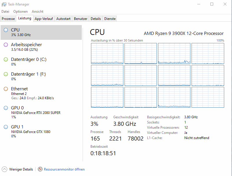

I have a VM with Windows 10 and want to Use 11 Cores and 11 Threads from my Ryzen 9 3900X, but max. 12 are aviable for Windows. Is there a Limit for CPU Cores?grafik.png.90e31e95009513df14885cbbe7ab5c17.png
