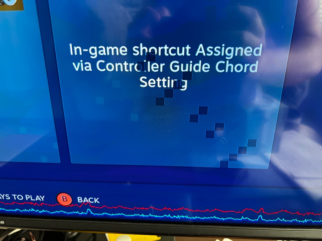

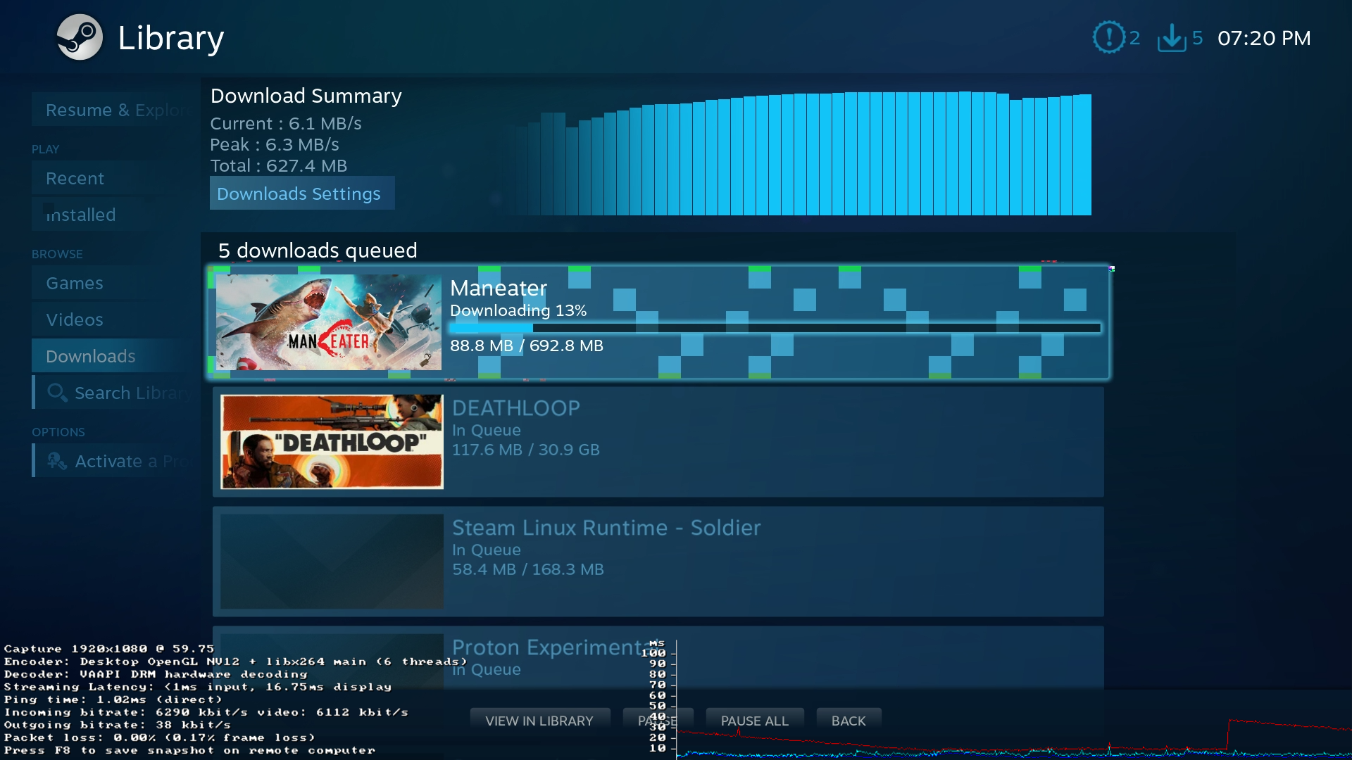

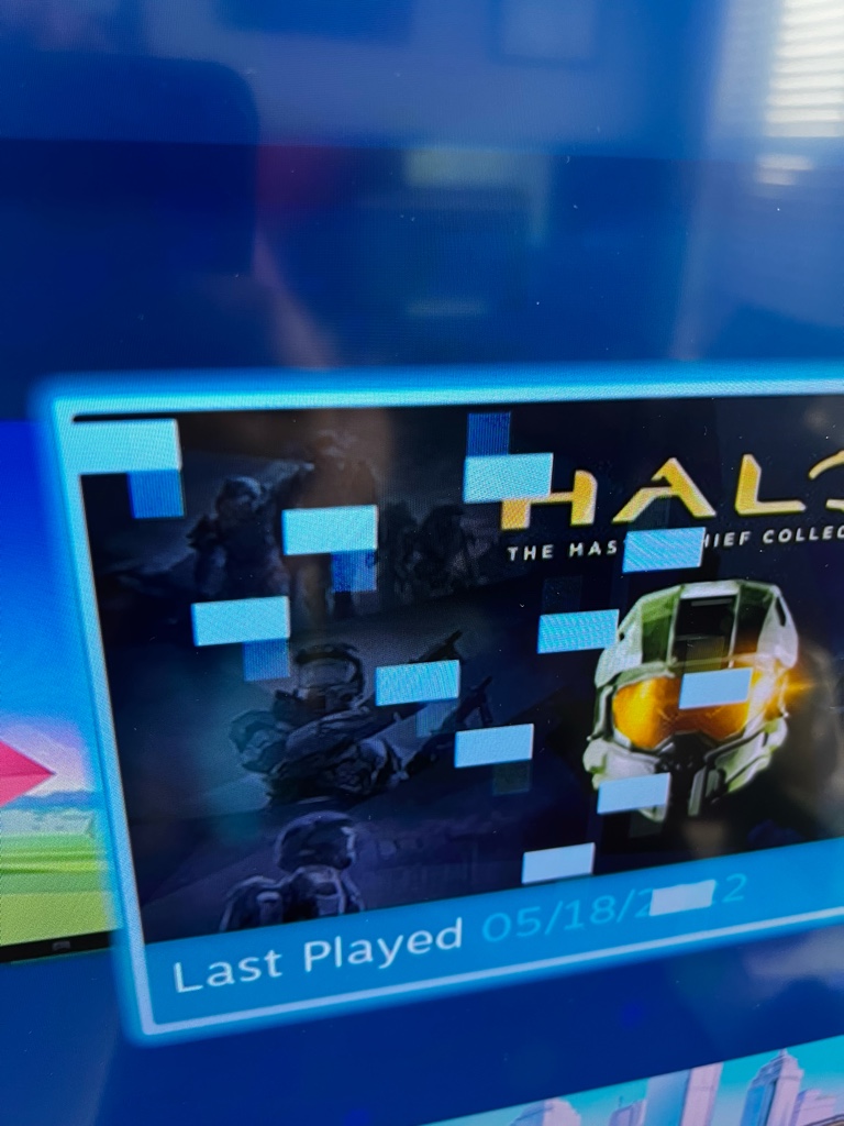

  1. Sounds great, the main reason I wanted to try sunshine is because I seem to have odd graphical artificating/glitches. The artificating also shows using the web interface, so not sure if sunshine would really solve it... Was hoping to see if I would have different results. When I briefly tested with an Nvidia GPU, had a loaner, it did not experience the same artificating... Thanks for spending your time on this, it is a really cool project! Edit: Here is a pic of the artifacts that I'm seeing. Can be seen in game sometimes, and a lot more easily in the steam big picture mode: This happens with software or hw encoding. Interestingly enough, for testing purposes, I moved the GPU (AMD RX 6700 XT - Reference) to my newer system so I could test further, and it has the same issue as the previous system (Old System i5 8th Gen, new: i5 12th gen). Also while getting this setup it tried to use the onboard iGPU and that did not experience the graphical artifacts, only when using the AMD card... I'm going to try to build a VM with GPU pass-through to see if its less of an issue there....

  4. Does anyone else get artifact info when remote playing via steam link app? See the attached pictures. This happens regardless of the encoding method. In my case I have Intel i5 8700k for hw acceleration, or AMD RX6700 XT. If anyone has any tips on what is causing and how I could fix it, I’d appreciate it. Sent from my iPhone using Tapatalk
