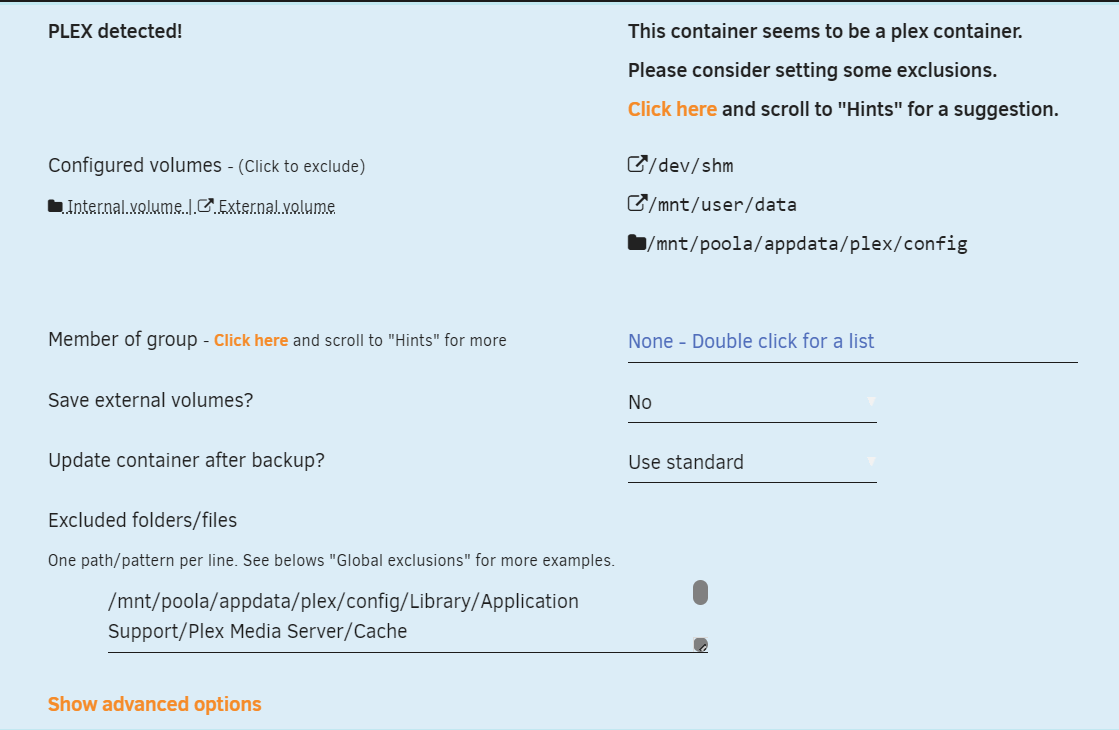

Please check the backup log! tar creation failed! Tar said: tar: /mnt/user/appdata/plex-media-server/Library/Application Support/Plex Media Server/Cache: file changed as we read it
BUT that exact folder is in the excluded folders/files list for the Plex docker. Shouldn't it just be skipped entirely?
https://imgur.com/a/pfIKf6K
Any help would be appreciated!
You excluded /mnt/user/... but the internal volume being backed up is /mnt/cache/...
Edited by Kilrah

The tool is including folders that I have marked for exclusion, namely Plex's Cahce, Media and Metadata folders. Here's a screenshot of my config. Curious if anyone can see an error with my input or if there's a known issue. Haven't seen anything mentioned about this so I must've screwed up the config somewhere.
Things I've tried:
  • changing exclusion path and container path to /mnt/user, and any variation in between
  • excluding folder names without the full path (e.g. /Cache, /Media, /Metadata
Edit to the above comment:  changing both paths from /mnt/user to /mnt/poola seems to have fixed the issue. Still took ~45 minutes just for Plex though, so I'll have to keep the container running during the backup unfortunately.

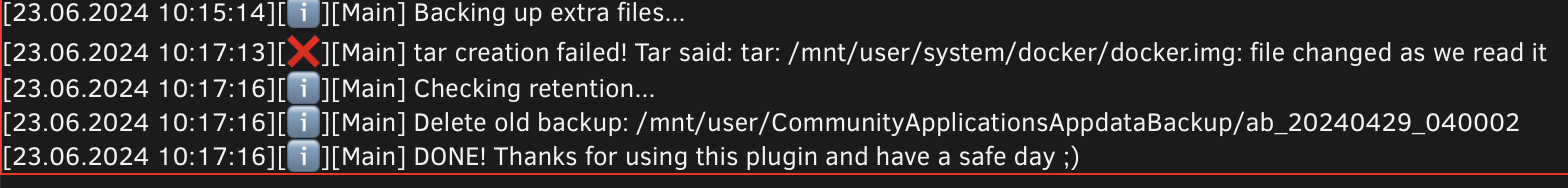

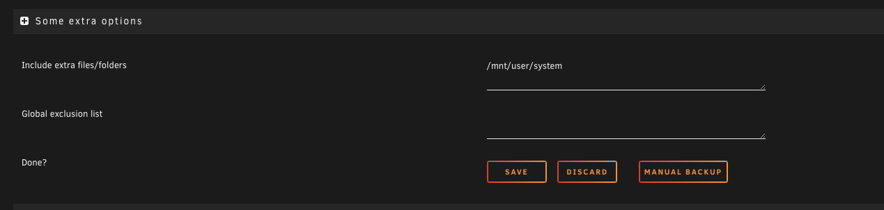

Could someone help me with this error message? "Tar creation failed! Tar said: tar /mnt/user/system/docker/docker.img: file changed as we read it"
Debug log ID: 4b68d0e2-9581-42ab-a971-33f4896ba364
docker.img should not be backed up in the first place. What did you do to get something from the system share be processed by this plugin?
oh my... that makes sense then. probably this setting right here. CleanShot2024-06-23at19_13_12.thumb.png.f25d6aeb706bc584f78da6ebe247375c.png
Do you think this is unnecessary? Or should I add the docker.img to the exclusion list?
Add only those paths here which are used inside the docker containers. Usually /mmt/user/appdata and/or /mnt/cache/appdata.
