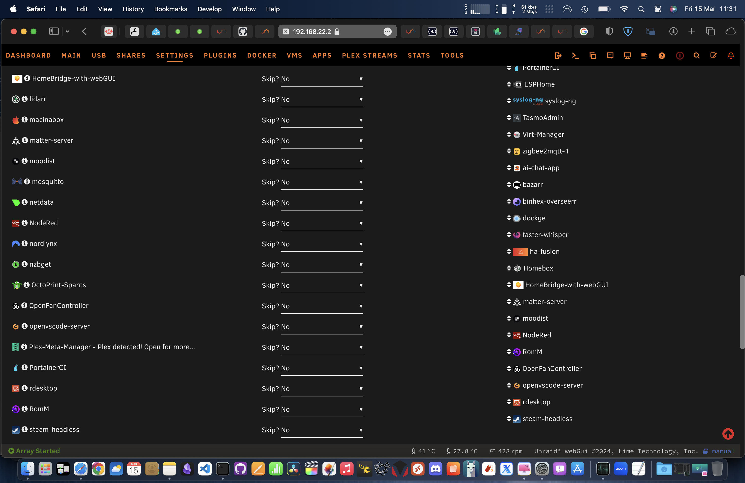

Just had a look out of interest at the backups and it's missing loads of my containers.
It seems to do the main ones plex etc but has missed out others specifically Romm.
So it creates a .xml file for each container but it is missing a lot of the .zst files of the actual folder.
Is anyone else having similar?
No container is set to be skipped.
1367569138_Screenshot2024-03-15at11_31_07.thumb.png.1611e7da762a8bbd2e2370a4ea13170c.png
Edited by dopeytree
Check what the logfile says for that container.

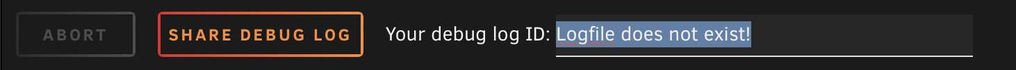

Logfile does not exist...!?
1099152357_Screenshot2024-03-18at21_06_18.thumb.png.4fe85710eb77453257217d5dbf619bed.png
But the log above that field is visible? No recent reboot or anything?
