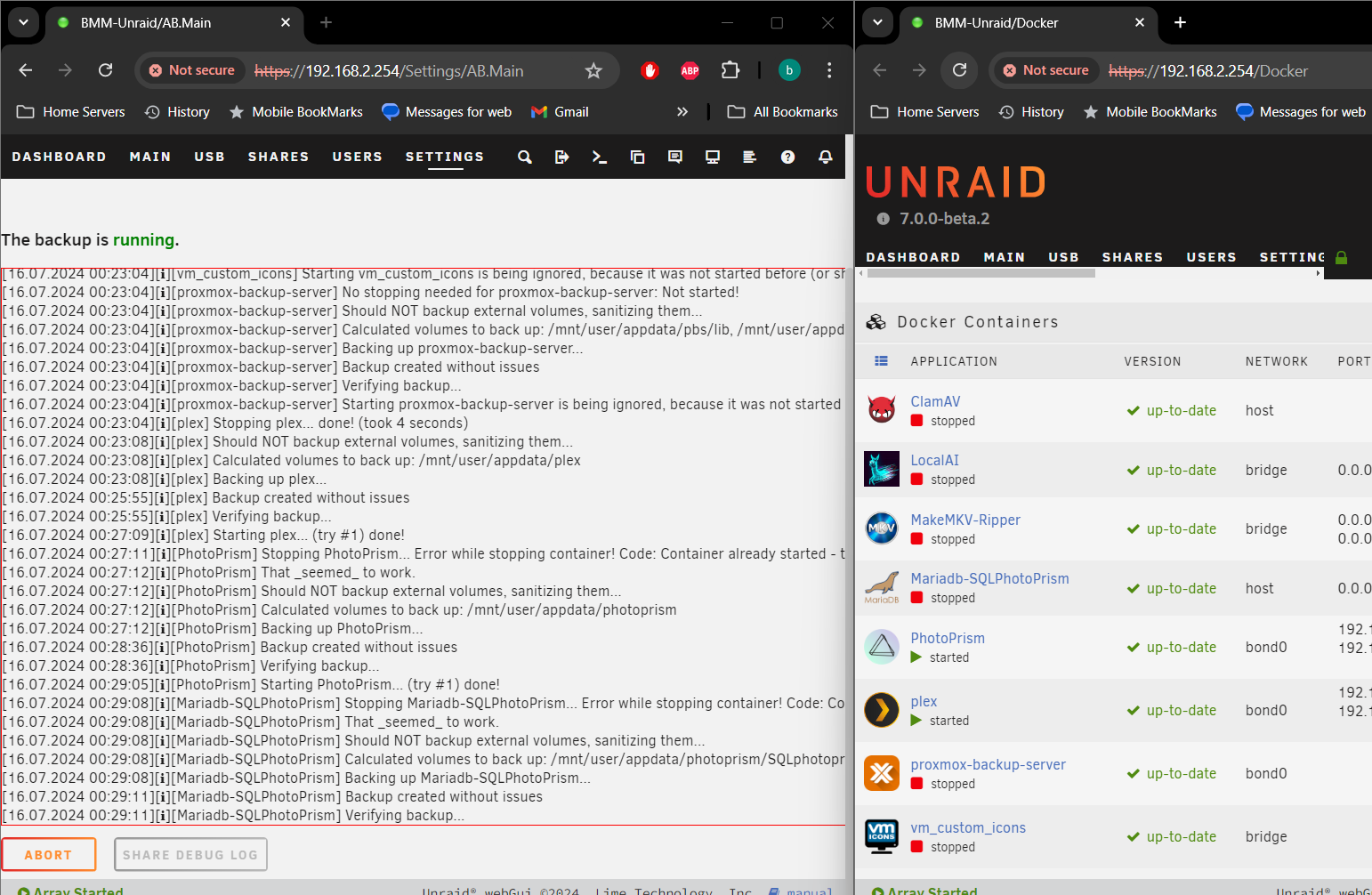

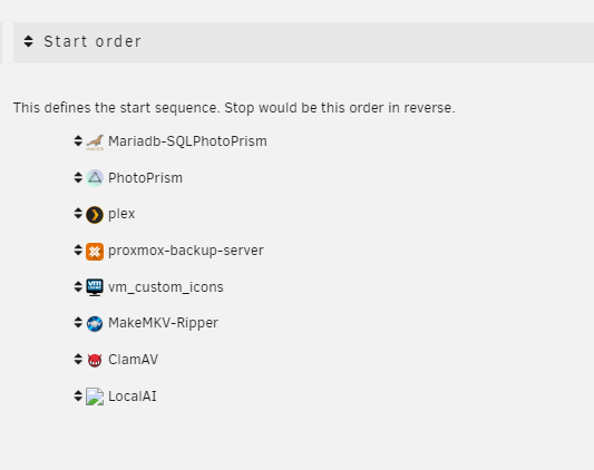

23 hours ago, bmartino1 said:
I have a 7 beta machine and a stable 6.12 machine experiencing this issue.
The per container setting and setting a specific order for the docker doesn't save.
This is the version 6 one also not for some reason it didn't grab the local AI image minor but also worth noting that there is something wrong here...
Somehow the start order started saving. will continue to monitor it...
I was able to fix my problem because the start stop order started keeping its stations.
so stop photoprism and mariadb dockers with pre run script to stop both dockers.
Next set order to have maraidb 2nd and photoprism 1st.
that way when it backups both dockers are stopped and when mariadb backups is done its started first. So I don't get this situations where photoprism is on without its database...
on the side to note as this plugin does this already.
If following the defaults. /mnt/user/appdata is the defualt locaiton for dockers

[21.07.2024 02:00:12][ℹ️][tautulli] Starting tautulli... (try #1) done!
[21.07.2024 02:00:17][ℹ️][Plex-Media-Server] Stopping Plex-Media-Server... done! (took 9 seconds)
[21.07.2024 02:00:26][ℹ️][Plex-Media-Server] Should NOT backup external volumes, sanitizing them...
[21.07.2024 02:00:26][ℹ️][Plex-Media-Server] Calculated volumes to back up: /mnt/user/appdata/Plex-Media-Server
[21.07.2024 02:00:26][ℹ️][Plex-Media-Server] Backing up Plex-Media-Server...
[21.07.2024 02:07:56][ℹ️][Plex-Media-Server] Backup created without issues
[21.07.2024 02:07:56][ℹ️][Plex-Media-Server] Verifying backup...
[21.07.2024 02:10:57][ℹ️][Plex-Media-Server] Starting Plex-Media-Server... (try #1) done!
[21.07.2024 02:11:01][ℹ️][binhex-hexchat] No stopping needed for binhex-hexchat: Not started!
[21.07.2024 02:11:01][ℹ️][binhex-hexchat] Should NOT backup external volumes, sanitizing them...
[21.07.2024 02:11:01][ℹ️][binhex-hexchat] Calculated volumes to back up: /mnt/user/appdata/binhex-hexchat
[21.07.2024 02:11:01][ℹ️][binhex-hexchat] Backing up binhex-hexchat...
[21.07.2024 02:11:13][ℹ️][binhex-hexchat] Backup created without issues
[21.07.2024 02:11:13][ℹ️][binhex-hexchat] Verifying backup...
[21.07.2024 02:11:29][ℹ️][binhex-hexchat] Starting binhex-hexchat is being ignored, because it was not started before (or should not be started).
[21.07.2024 02:11:29][ℹ️][chromium] No stopping needed for chromium: Not started!
[21.07.2024 02:11:29][ℹ️][chromium] Should NOT backup external volumes, sanitizing them...
[21.07.2024 02:11:29][ℹ️][chromium] Calculated volumes to back up: /mnt/user/appdata/chromium
[21.07.2024 02:11:29][ℹ️][chromium] Backing up chromium...
[21.07.2024 02:11:31][ℹ️][chromium] Backup created without issues
[21.07.2024 02:11:31][ℹ️][chromium] Verifying backup...
[21.07.2024 02:11:33][ℹ️][chromium] Starting chromium is being ignored, because it was not started before (or should not be started).
[21.07.2024 02:11:33][ℹ️][JDownloader2] Stopping JDownloader2... done! (took 2 seconds)
[21.07.2024 02:11:35][ℹ️][JDownloader2] Should NOT backup external volumes, sanitizing them...
[21.07.2024 02:11:35][ℹ️][JDownloader2] Calculated volumes to back up: /mnt/user/appdata/JDownloader2
[21.07.2024 02:11:35][ℹ️][JDownloader2] Backing up JDownloader2...
[21.07.2024 02:11:41][ℹ️][JDownloader2] Backup created without issues
[21.07.2024 02:11:41][ℹ️][JDownloader2] Verifying backup...
[21.07.2024 02:11:45][ℹ️][JDownloader2] Starting JDownloader2... (try #1) done!
[21.07.2024 02:11:49][ℹ️][Main] Backing up the flash drive.
[21.07.2024 02:13:11][][Main] Copying flash backup to destination failed!
[21.07.2024 02:13:14][ℹ️][Main] VM meta backup enabled! Backing up...
[21.07.2024 02:13:14][][Main] Error while backing up VM XMLs. Please see debug log!
[21.07.2024 02:13:16][ℹ️][Main] Checking retention...
[21.07.2024 02:13:16][ℹ️][Main] Delete old backup: /mnt/disks/Backups_Plex/BackupPlex/ab_20240602_020001
[21.07.2024 02:13:23][ℹ️][Main] DONE! Thanks for using this plugin and have a safe day ;)
[21.07.2024 02:13:23][ℹ️][Main] ❤️

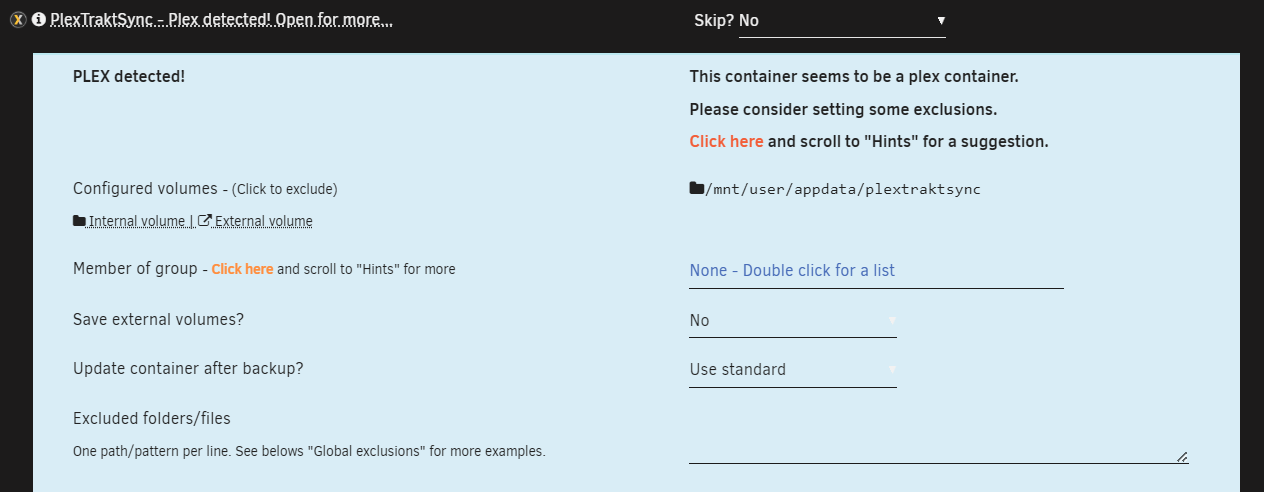

Hiya
My PlexTraktSync docker is detected by Autobackup plugin as Plex and i misguiding info in settings due to it:
PlexTraktSync: ghcr.io/taxel/plextraktsync:latest
Is there a way to make it not see it as Plex?
