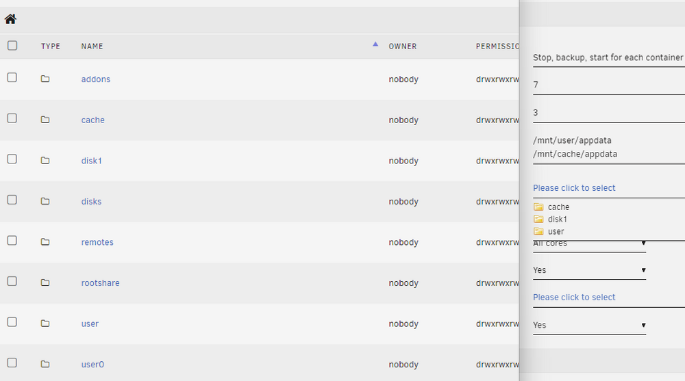

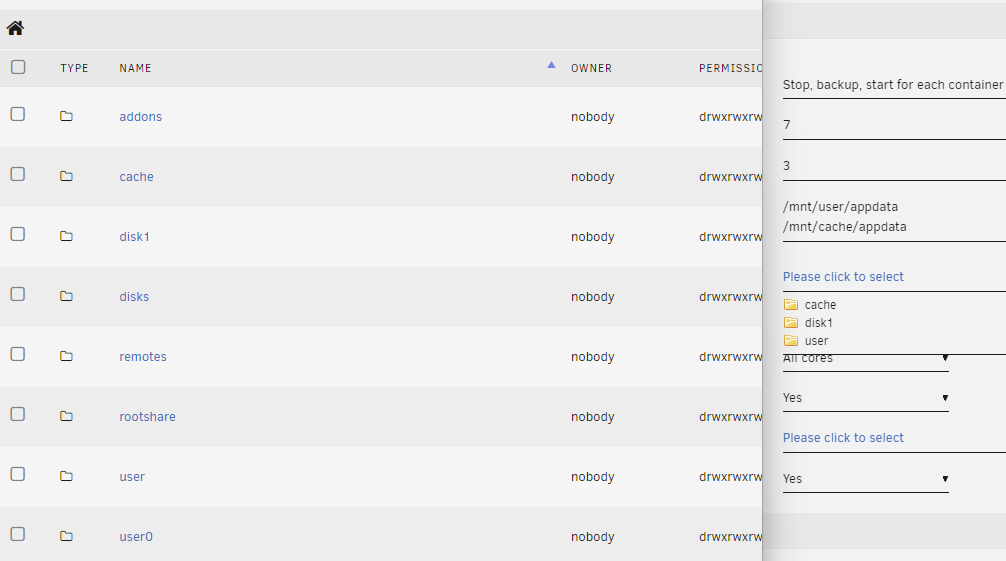

4 hours ago, Kilrah said:
Indeed doesn't list all contents of /mnt on 7.0.0b2, might be at unraid level though?
Looks like same issue as me, you are missing disks folder as well.
