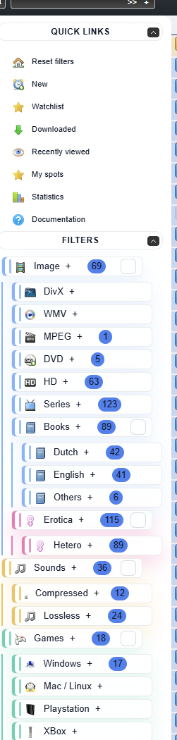

  11. How come my Spotweb looks like this now?
  12. EDIT Solved: Issue : version : 9.5.0 edition : MySQL Community Server - GPL log_bin : 1 ← binary log ON binlog_format: ROW gtid_mode : ON ← GTID ON enforce_gtid_consistency: ON So your MySQL is strict GTID + binlog = ON, which does not like what Spotweb’s retrieve code is doing, and that’s why it keep getting: Statement violates GTID consistency: Updates to non-transactional tables... This MySQL config itself will keep breaking Spotweb. I've created a file zz-spotweb-gtid.cnf chmod 644 with the following lines: log_bin=0 skip_log_bin=1 gtid_mode=OFF enforce_gtid_consistency=OFF In UnRAID: Go to Docker → click on mysql-spotweb → Edit. Add a new Path mapping: Host path: /mnt/user/appdata/mysql-spotweb/zz-spotweb-gtid.cnf Container path: /etc/mysql/conf.d/zz-spotweb-gtid.cnf Access mode: Read-only and restart the mysql docker. What is causing my Spotweb to crash with this error? It this related to the mysql DB? SpotWeb v0.68.38.34 on PHP v8.3.27 crashed Fatal error occured during retrieve: HY000: 1785: Statement violates GTID consistency: Updates to non-transactional tables can only be done in either autocommitted statements or single-statement transactions, and never in the same statement as updates to transactional tables. #0 /var/www/spotweb/lib/dbeng/dbeng_pdo.php(86): dbeng_pdo->exec() #1 /var/www/spotweb/lib/dao/Mysql/Dao_Mysql_Spot.php(51): dbeng_pdo->modify() #2 /var/www/spotweb/lib/services/Retriever/Services_Retriever_Spots.php(656): Dao_Mysql_Spot->removeSpots() #3 /var/www/spotweb/lib/services/Retriever/Services_Retriever_Base.php(239): Services_Retriever_Spots->process() #4 /var/www/spotweb/lib/services/Retriever/Services_Retriever_Base.php(340): Services_Retriever_Base->loopTillEnd() #5 /var/www/spotweb/retrieve.php(142): Services_Retriever_Base->perform() #6 {main} Finished retrieving spots.
  13. EDIT Solved: Issue : version : 9.5.0 edition : MySQL Community Server - GPL log_bin : 1 ← binary log ON binlog_format: ROW gtid_mode : ON ← GTID ON enforce_gtid_consistency: ON So your MySQL is strict GTID + binlog = ON, which does not like what Spotweb’s retrieve code is doing, and that’s why it keep getting: Statement violates GTID consistency: Updates to non-transactional tables... This MySQL config itself will keep breaking Spotweb. I've created a file zz-spotweb-gtid.cnf chmod 644 with the following lines: log_bin=0 skip_log_bin=1 gtid_mode=OFF enforce_gtid_consistency=OFF In UnRAID: Go to Docker → click on mysql-spotweb → Edit. Add a new Path mapping: Host path: /mnt/user/appdata/mysql-spotweb/zz-spotweb-gtid.cnf Container path: /etc/mysql/conf.d/zz-spotweb-gtid.cnf Access mode: Read-only and restart the mysql docker. What is causing this crash? SpotWeb v0.68.38.34 on PHP v8.3.27 crashed Fatal error occured during retrieve: HY000: 1785: Statement violates GTID consistency: Updates to non-transactional tables can only be done in either autocommitted statements or single-statement transactions, and never in the same statement as updates to transactional tables. #0 /var/www/spotweb/lib/dbeng/dbeng_pdo.php(86): dbeng_pdo->exec() #1 /var/www/spotweb/lib/dao/Mysql/Dao_Mysql_Spot.php(51): dbeng_pdo->modify() #2 /var/www/spotweb/lib/services/Retriever/Services_Retriever_Spots.php(656): Dao_Mysql_Spot->removeSpots() #3 /var/www/spotweb/lib/services/Retriever/Services_Retriever_Base.php(239): Services_Retriever_Spots->process() #4 /var/www/spotweb/lib/services/Retriever/Services_Retriever_Base.php(340): Services_Retriever_Base->loopTillEnd() #5 /var/www/spotweb/retrieve.php(142): Services_Retriever_Base->perform() #6 {main} Finished retrieving spots.
