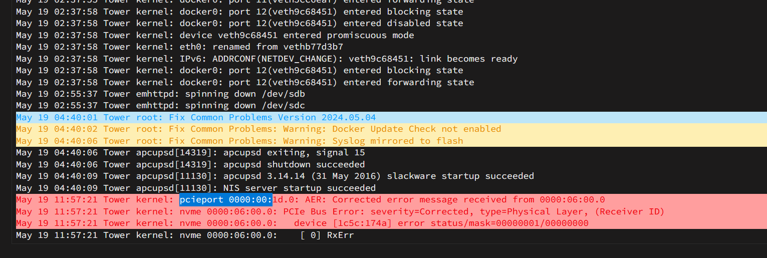

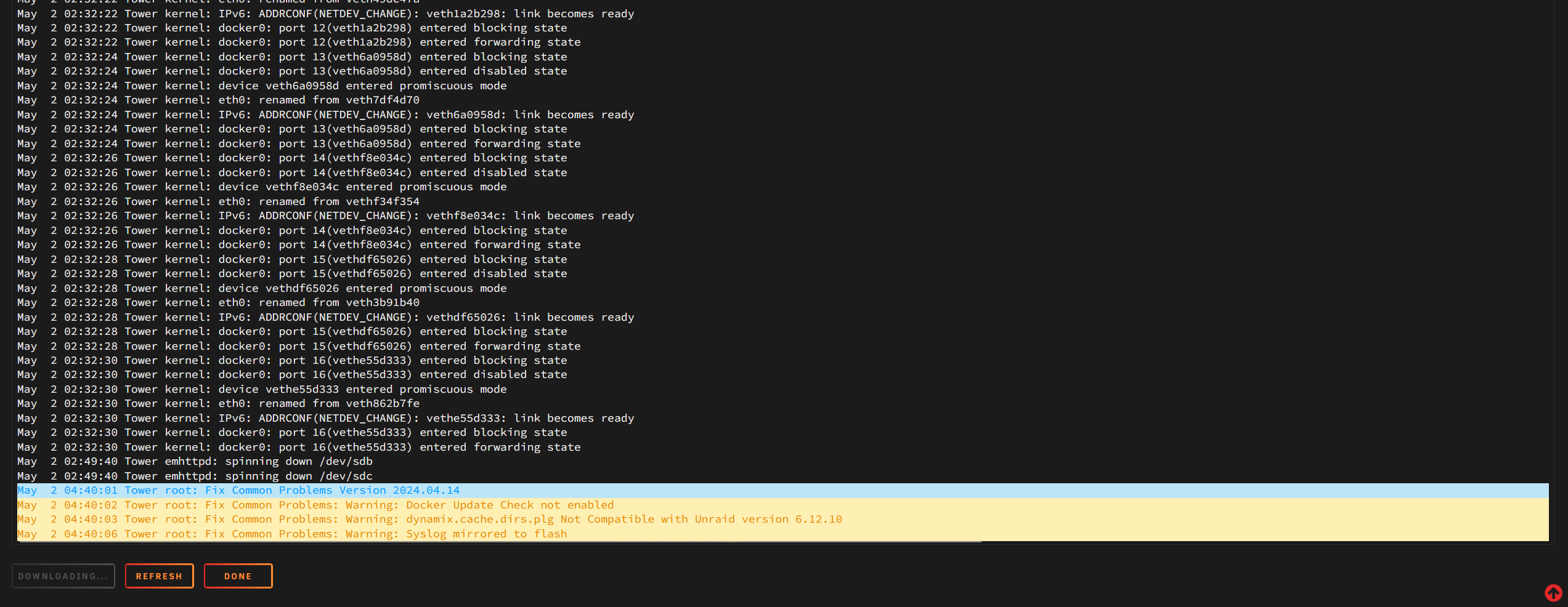

Hi again, after round about 10-20 days the Server restarts by itself again. I attached my logs. Maybe someone can see something? tower-syslog-20240502-1640.ziptower-syslog-previous-20240502-1640.zip

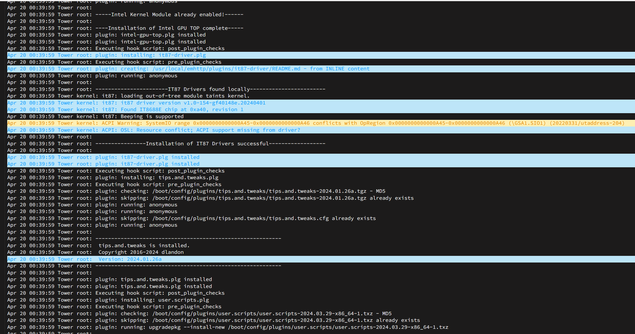

I just activated the Syslog Server to mirror to the Flash drive. I don´t have a cat or any other animal. And nobody was entering that room after 09:00 PM. But what Hardware Issue it is? I checked mostly everything. Checked all drives with a SMART test, CPU Benchmark, Changed PSU to a new one, Memtest over several hours. Changed the USB-Stick, also created it new. In mid of the Parity-Sync the Server decided to reboot. And the Server also rebooted at other states. Not only in mid of the Parity-Sync. I mean those Messages in the Syslog. "Received signal 15; terminating." "BERT: [Hardware Error]: Skipped 1 error records" "kernel reports TIME_ERROR: 0x41: Clock Unsynchronized" -> Often my set time in BIOS is flipping back to something else. ACPI Warning:

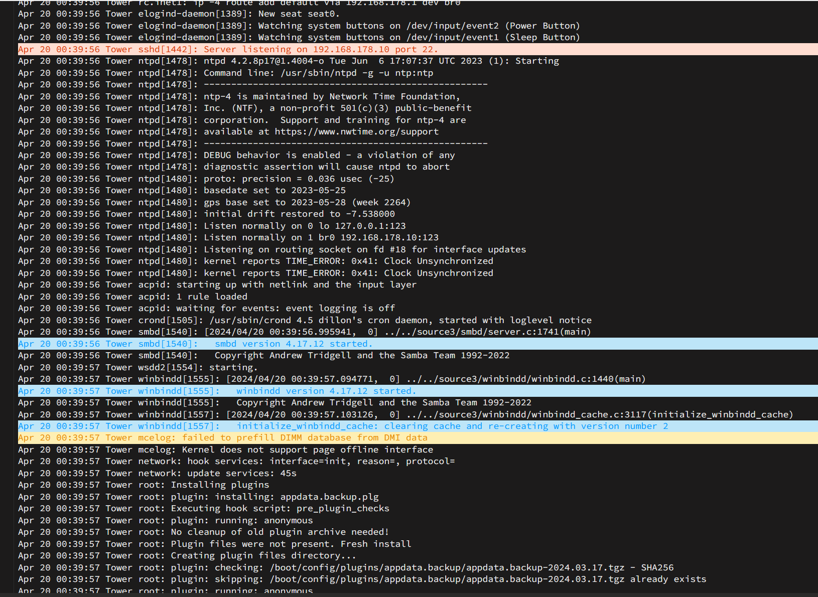

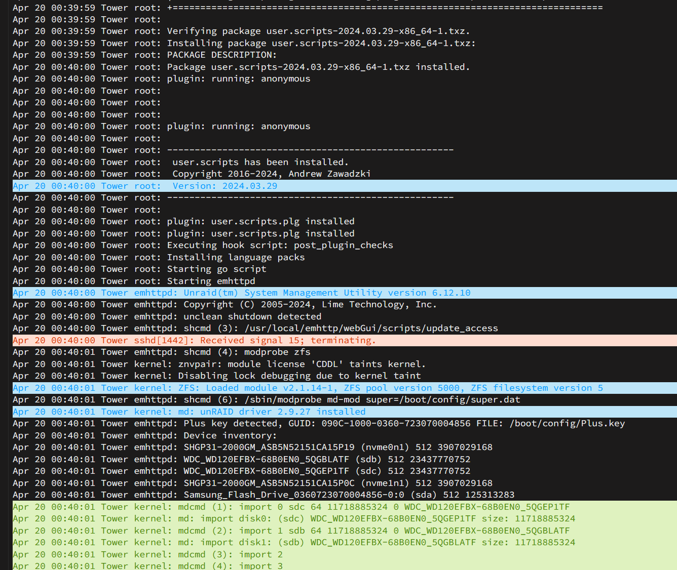

I created the USB-Stick completely new and also didn´t copied any configs. The Parity-Sync is also running since yesterday. But at 00:40 AM the Server gots a Message to terminate? I didn´t shutdown the Server. What happend? I wasn´t on the PC/Server since 09:00 PM And today morning I just have to login again and enter my Encryption Key for the HDDs. Whats going on here? Can somebody check the log and help me, please? tower-syslog-20240420-0730.zip

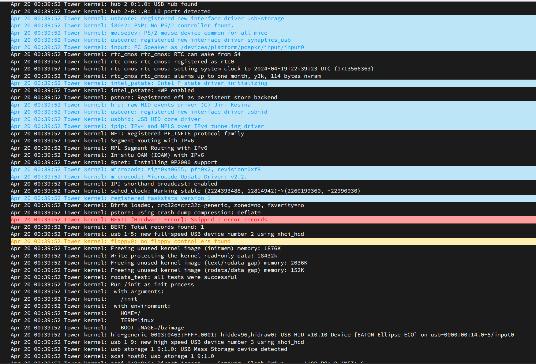

I recreated the USB Stick. I am now able to reboot normally again. But I still have the same boot sequence like in the Video -> Is that the normal boot behavior with "Not automatically fixing this" and this big block of numbers ?
