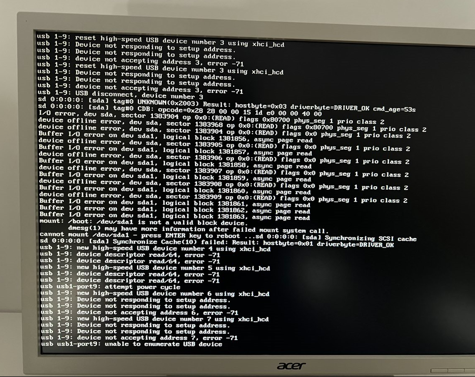

I recreated the USB Stick. I am now able to reboot normally again. But I still have the same boot sequence like in the Video -> Is that the normal boot behavior with "Not automatically fixing this" and this big block of numbers ?

If I startup the System normally and do a reboot I get this Messages. I also recorded the booting sequence. I think it´s not normal or? I Hope you can download it and Slow down the speed to see the Messages.

I just bootet into the BIOS and wanted to check some settings (Didn´t changed anything). After 1-2 Reboots the USB drive is not recognized anymore. Maybe that´s something I should analyse. Could it happen that after some Days the USB device is not recognized anymore and thats why Unraid freezes? My USB Device (https://www.amazon.de/gp/product/B07D1KCL2Z/ref=ppx_yo_dt_b_search_asin_title?ie=UTF8&psc=1) is connected via this Adapter "https://www.amazon.de/gp/product/B08N4LQJJN/ref=ppx_yo_dt_b_search_asin_title?ie=UTF8&th=1" directly on the Mainboard. (USB Device is new also checked for Errors.) BIOS USB Settings: Legacy USB Support: Disabled XHCI Hand-off: Disabled USB Mass Storage Driver Support: Enabled Port 60/64 Emulation: Disabled Fast boot: Disabled Link CSM Support: Disabled Windows 10 Features: Other OS Secure Boot: Enabled (Because of EFI?) Power Loading: Auto (Set it now to Disabled to test it) I am booting Unraid with EFI. Does any other BIOS Setting is important? If I move my USB Device with Adapter to another Onboard Port it would work again with the same settings.

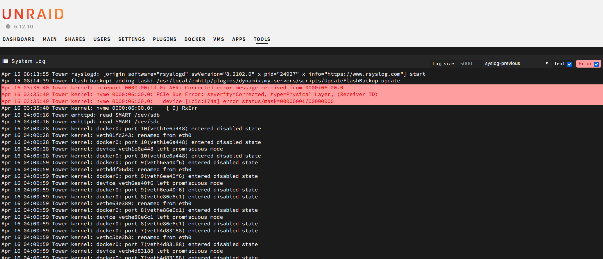

I did a "SMART extended self-test" on both M.2. SSDs. 0 Errors. Everything seems to work? I have 2x SK hynix Gold P31 2TB PCIe NVMe Gen3 M.2 2280 interne SSD, bis zu 3500 MB/s, kompakt, Formfaktor SSD - Internes Solid State Drive mit 128-Layer NAND Flash, Festkörper-Laufwerk I also added "pcie_aspm=off" to my config. But I think that wouldn´t fix my freezes?

Hi again, my server did run for several days without freezing. For 2 days my Server freezed again. Found something like this in my Logs. I also attached both log files. Is maybe one M.2. SSD broken? How could I test this? Or is my Mainboard broken? PCIe Bus Error? Thanks! tower-syslog-20240418-0624.zip tower-syslog-previous-20240418-0624.zip
